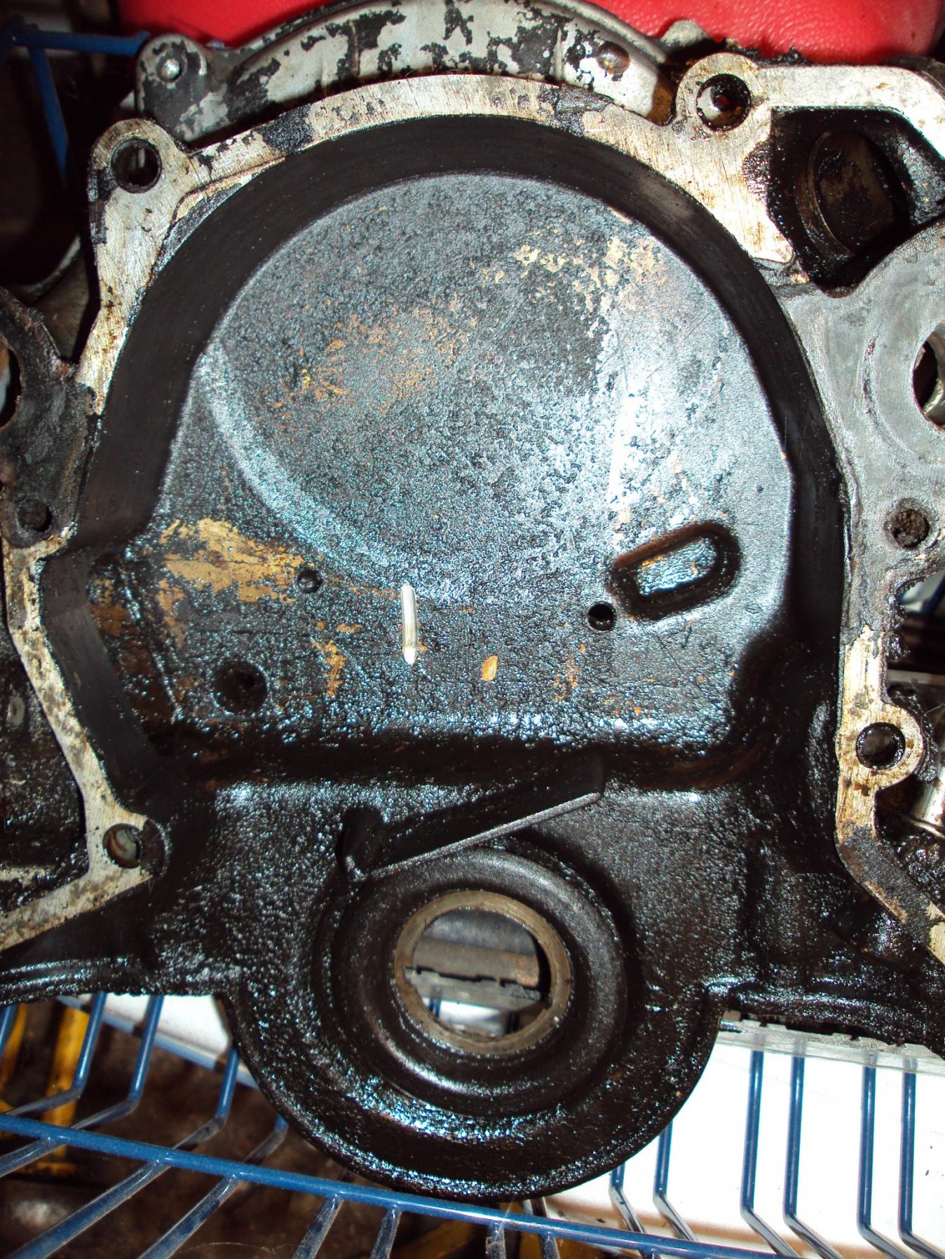

  24. NWGreaser
    Joined: Oct 22, 2006
    Posts: 113
    NWGreaser
    Thanks for all the input guys. So I have done a little more inspection on the motor and come to the following deductions: The timing cover has no alignment dowels nor provisions for any I can see, Definitely not a head alignment dowel (way too small), and the timing chain is intact and the mystery part doesn't resemble anything ***ociated with the timing system as far as I can tell. The oil pump retainer suggestion I will look into tomorrow, and I will take a pic of the interior of the timing cover to show the score mark. Thanks again.:)

  27. NWGreaser
    Posts: 113
    NWGreaser
    Sorry about not getting back to this thread earlier. I have a 9 month old and went on a month of 10 hour 6 day work weeks. Here's the pic of the inside of the timing cover. Not just a clean spot but a slight graze into the aluminum. All your help is appreciated. Thanks.

  30. Francisco Plumbero
    Joined: May 6, 2010
    Posts: 2,533
    Francisco Plumbero
    from il.
    Check the back of the timing cover, the lower bolts holes seem to have a provision for some type of an alignment sleeve, perhaps one on each side, its possible that it may have been a part or a bit of a modification from a dipstick sleeve, what's the condition of that, the dipstick seal and sleeve? If you bust a timing chain or gear you get that tatoo. Not a lash cap, not a lifter component, not a stock timing gear part, not an intake water port guide, possible that it came off of the bottom of the distributor. I have to get a chance to look it up I'll get back to tis thread.
    The fuel pump rotating ***embly that attaches to the cam or timing chain has a hole in it the same size as the outer diameter of the part you have, perhaps the cam or timing gear had a smaller pin and this bushing overcame the diameter difference. Still looking for more possible things.
