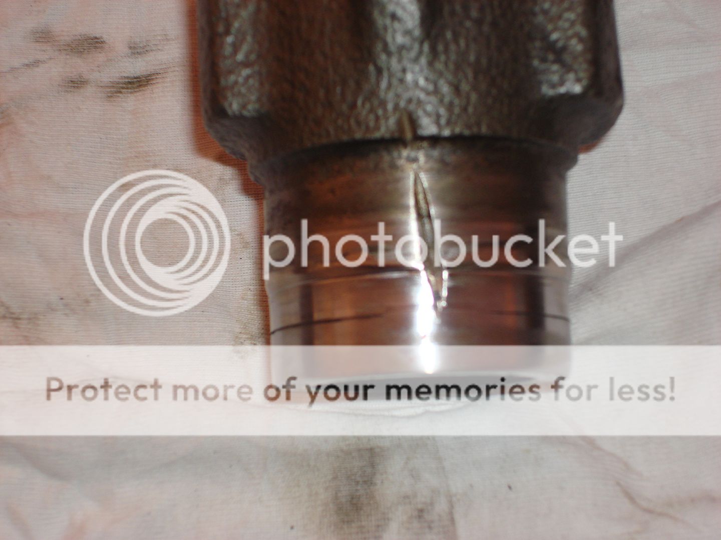

    About 6 years ago I needed a new 9 inch Ford center section for my 27 and my Son Dan also needed one for his rpu. We saw a guy on Ebay who sells 9 inch Track-Loc rears in any ratio and he had a good feedback rating. So we ordered two rear ends, mine is a 4.30 ratio and Dan's is a 4.10.
    As soon as I installed mine and put gear oil in the rear, it started to drip out of the front seal. I called the guy and he said to send it back and he would send me a new one, which he did. When he got my first one back he called me and basically chewed me out and said "You overfilled the rear end, that is why it leaked !!" I told him how the hell do you overfill a Ford rear, you just fill it till it dribbles out of the fill hole and that is it ? He was super pissed and we parted not friends.
    For 6 years, the second rear has also leaked out of the same seal, and it would even get all over my garage floor just sitting there. It finally got to the point I just ordered a brand new rear from someone else and installed it.
    Tonight I got curious to see if the yoke was maybe worn, causing the leak, so I pulled out the yoke. This is what I found !
    Directly across from each other are two deep gouges in the seal surface of the yoke, as if someone took a chisel and put a deep reference mark on it for some reason. The gouges go way into the area that the seal rides on. There are also a lot of deep score marks on the seal area, and this rear probably has only about 2000 miles on it, if that.
    The only thing I can think of is that this guy is using badly worn parts to build these rears, and the reason he has good feedback is that people put in the feedback as soon as they get the rear, and before they actually get to use it. That is what I did, and I wish I could go back and put in what I really think of this guy !
    So, if you ever are thinking about buying a rear from a guy in Marcus Hook, Pennsylvania, who sells mainly on Ebay, remember these pictures.
    Don

    Damn that ****s.1st pic almost looks deliberate.

    Funny you should say that...........I kinda wondered about that too. Nothing I know of would cause that kind of damage, it absolutely looks like someone took a chisel and hit it with a hammer really hard. I hate to think that he would be the kind of guy to do that, just because he was not happy with me sending the first one back, but who knows.
    Both gouges are at exactly 6 and 12 oclock, not just randomly lined up.

    And yes, I would say that appears to be intentional damage.

  8. Don't know but looks like he used cut off wheel to remove the yoke. Probably buys rears from a s**** yard.

    A fella worked for me who'd previously been the transmission man in a Ford dealership for a number of years. He said he quickly learned to not throw away any hard parts he'd replaced in a trans because people from some of the chain trans rebuilders would come around and buy then. He made nothing off the new parts he installed and the owner of the dealership was a real stickler for not selling customers unnecessary parts, so the used parts he'd have were strictly stuff with defects. Looks like this seller might do his parts shopping from the same sort of junk pile.

    could be this, honestly never thought of it. What a HACK.

    I had a new bearing put on a 9inch axle once that leaked afterwards, took it somewhere else to see what was up with it. The previous guy used a cutoff wheel to cut the old bearing off and it left the same mark in the seal area.

    By God, I think you guys have nailed it with the cutoff wheel !!! Yes, that is exactly what it looks like. I am going to buy a new 1310 yoke from someone and put a new seal on it and save this rear for some future project.

    Don, they must have cut off that slinger[?] dust shield with the cut off saw? i can't think of any other reason to have a chisel or cut off saw any were near that part.

    You are probably right. In fact, now that I think about it, there was NO slinger on this rear. The new one I just bought, and every other one I have seen, has that slinger in that spot. That is what probably happened.

    No, I am just going to put a new yoke on it, mainly because this damaged yoke is that *******ized one that makes you use a u joint with two different sized bearings on it, one size on the driveshaft and one on the yoke. The new center section I just bought uses a standard 1310 yoke and I had to have a new driveshaft made that was an inch longer to fit it, so if I put a 1310 yoke on this one I can switch back to the 4.30 gears if I don't like the new 3.70's.
