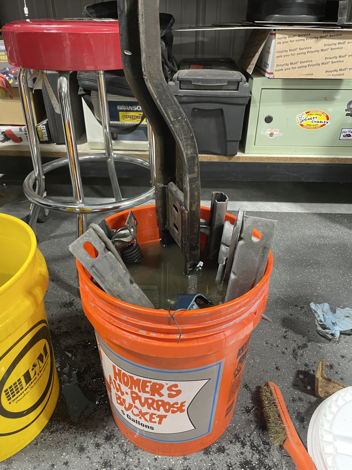

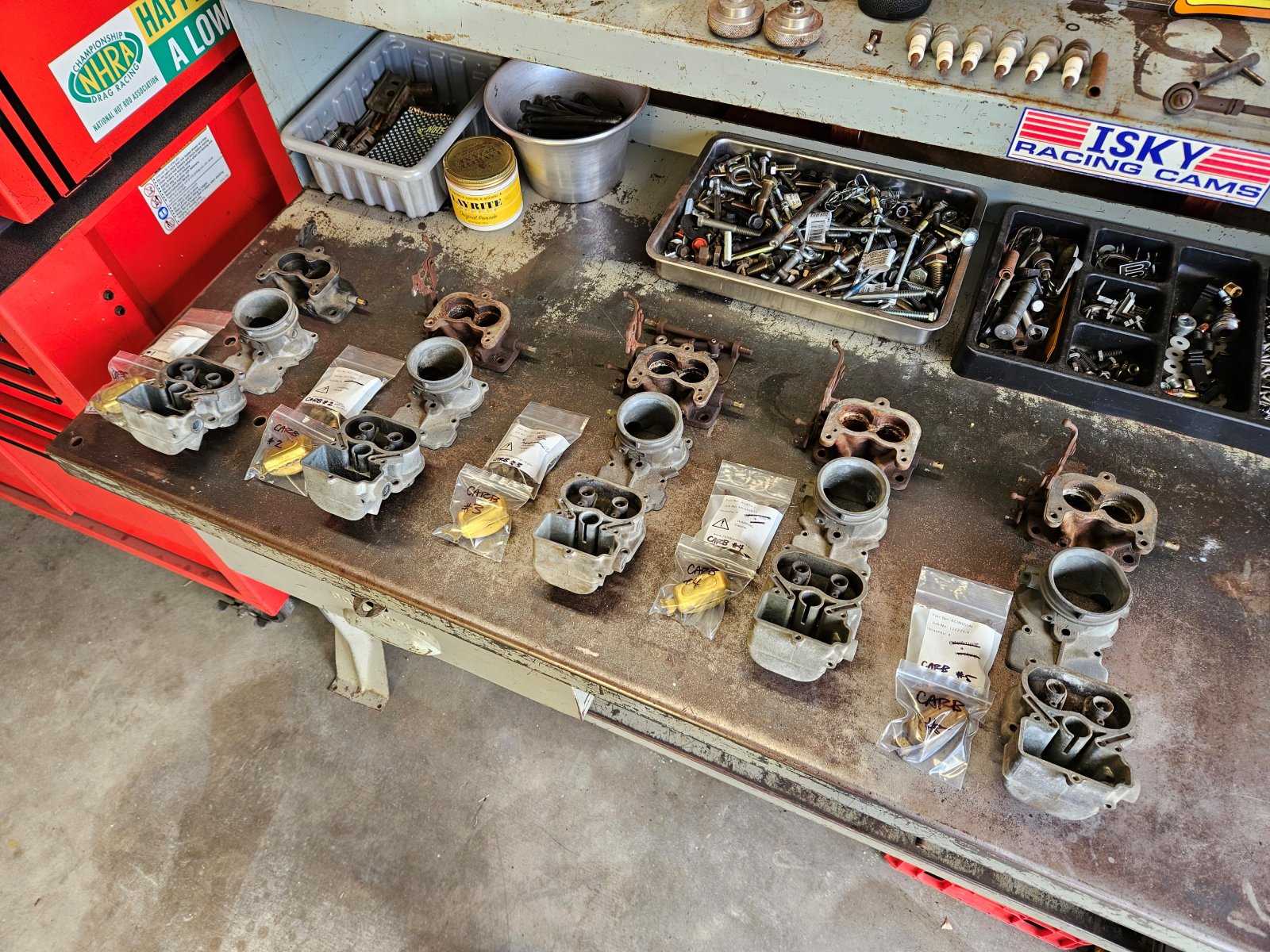

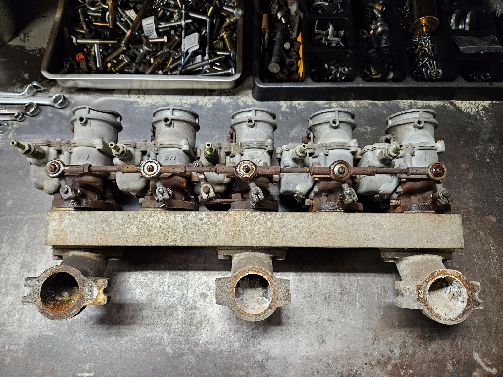

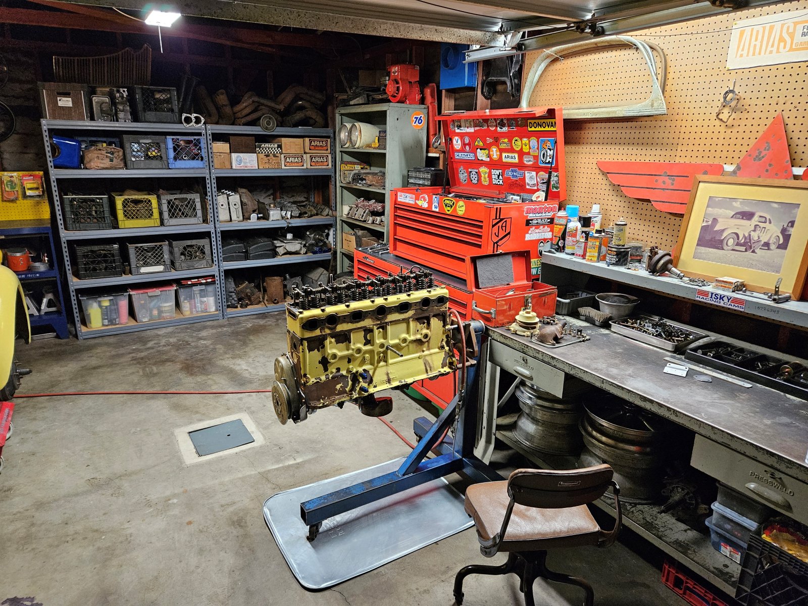

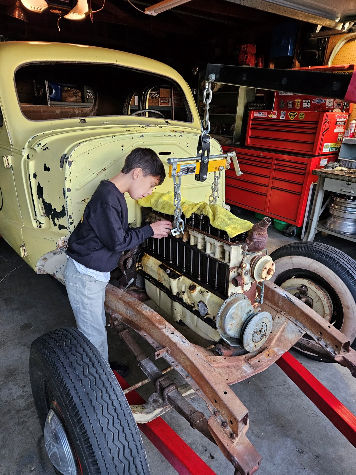

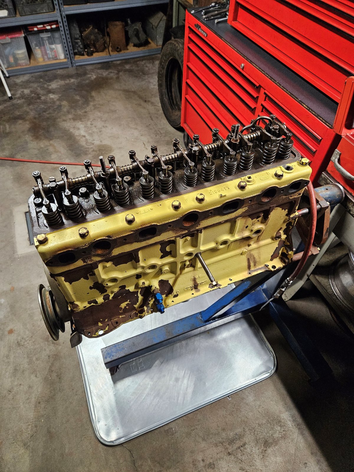

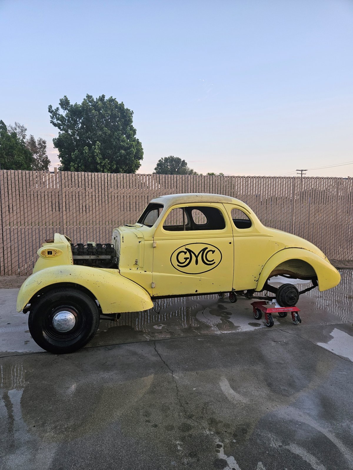

    Well it's been a little while, but I've definitely been at it with the old coupe. A TON of cleaning, as this thing was pretty damn gross from sitting for at least 5 decades. I acquired a nice pair of Divcos, an early Scintilla Vertex for tach drive, and a few other neat miscellaneous parts along the way.... but most of this stuff came with the car and it's amazing how well preserved everything was. No restoration happening here, just some TLC and re***embly. The engine is in remarkable shape for how long it has sat and it spins over like it ran yesterday. This ain't no stocker.... it has a reground cam, pop up pistons, lightened crank, Wayne main caps, and a bunch of very neat modifications. I am going to remove the head and check the condition of the bores, as well as have the head checked out and have hardened seats installed by Glenn Hutchison of Sacramento, Ca. That's my boy helping out pull the GMC, and he is very excited to work on his great-grandpa's old hot rod as much as possible.

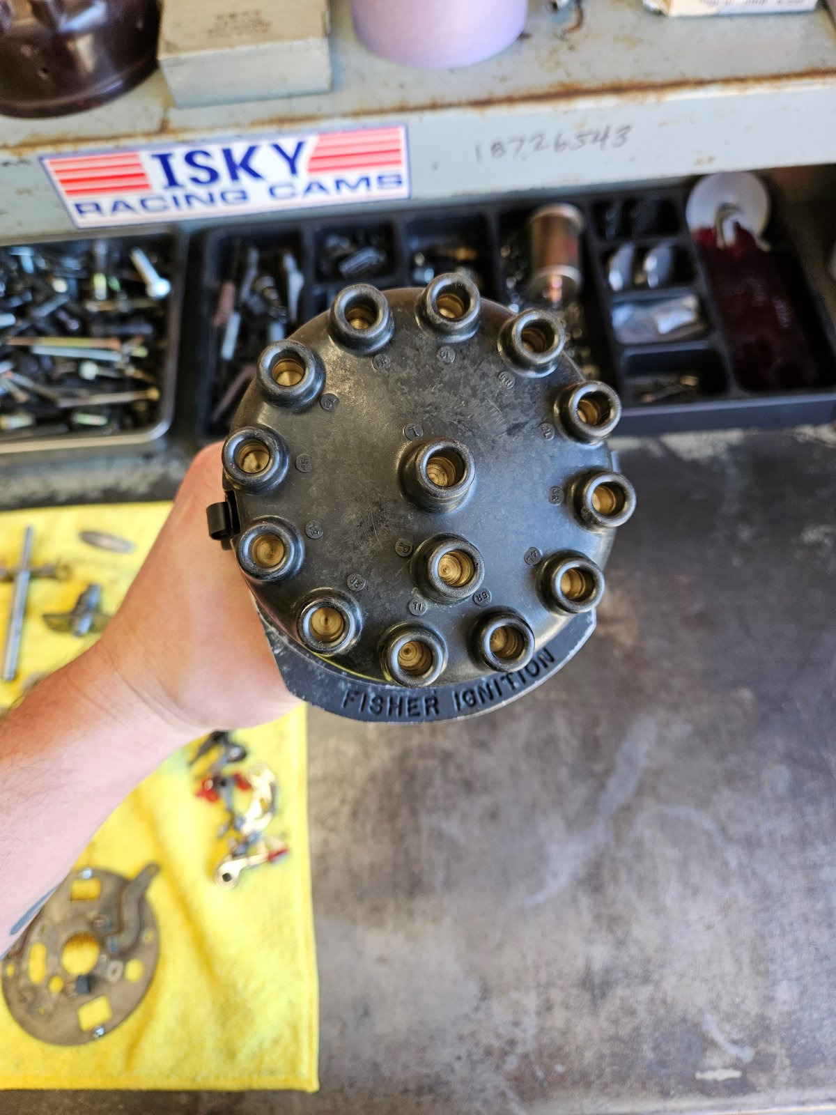

    Some random shots along the way...

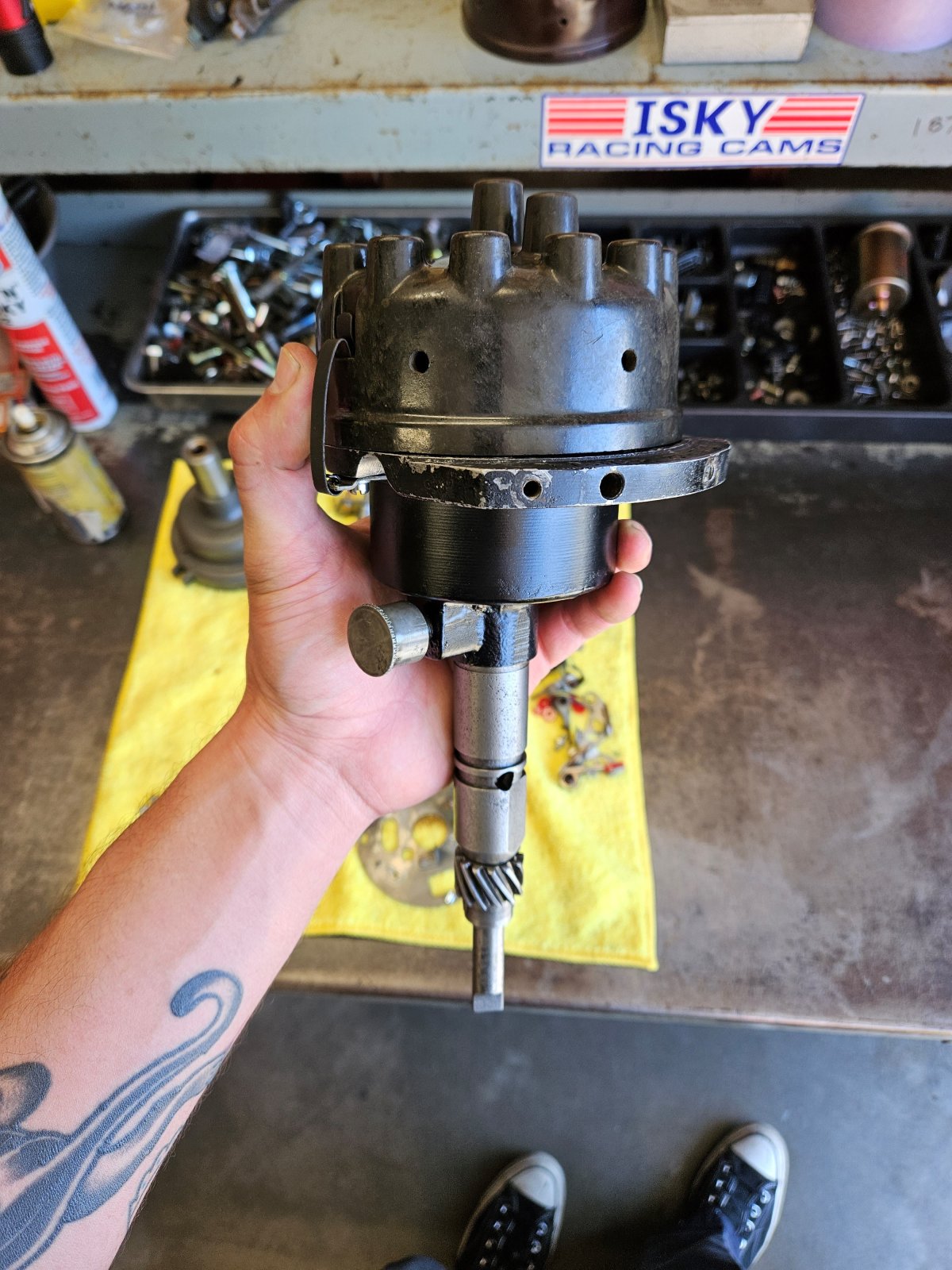

    Nash Twin Six distributor as it was in the car, completely seized and rusty. The Stewart Warner tach drive is one of the coolest pieces, and it's working like new again. Just waiting for points from Brillman Co... that place has everything.

    All parts coming together for the Scintilla-Vertex. Big thanks to Cedric Meeks!

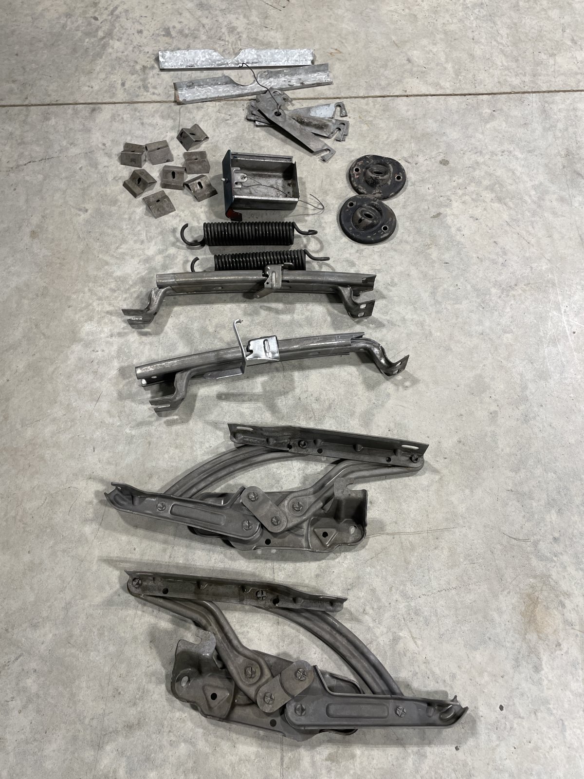

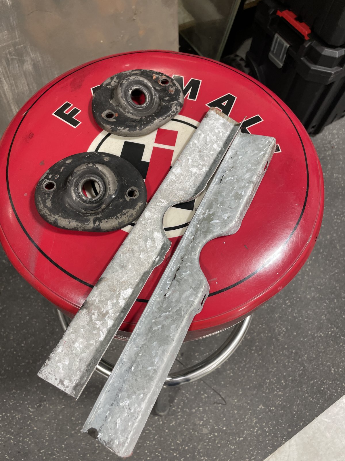

    Collection of all the parts that are patiently waiting to find their place back on this ol' girl eventually. The amount of quality fabrication and welding on this entire car is just mind blowing.

    What an interesting thread. You are definitely making them proud and doing the car justice. It sure cleaned up well and it is a bonus that you have so many of the original parts.

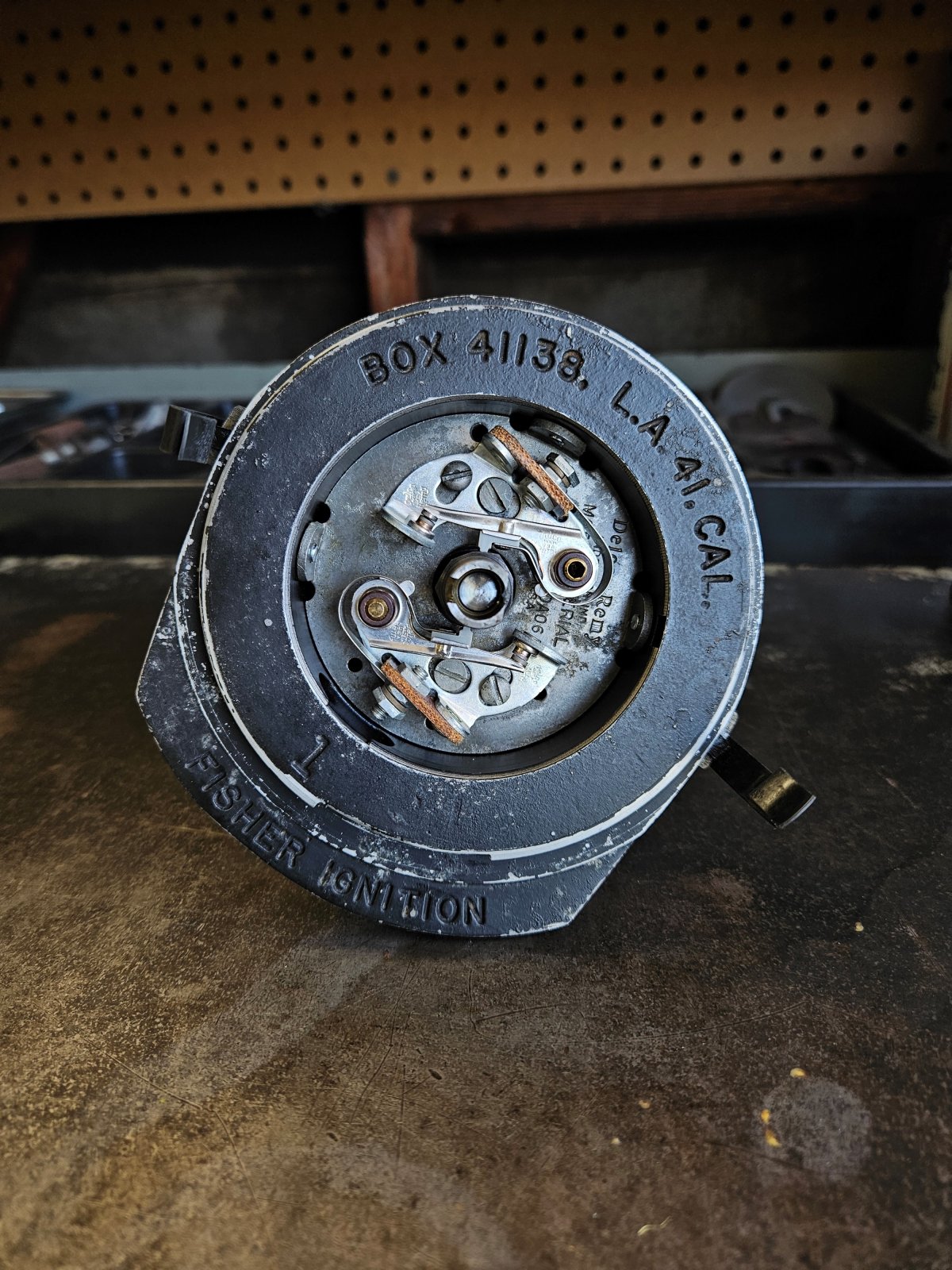

    Was the Fisher ignition another product by the late Fred W "California Bill" Fisher? I know he had the "How to Hop Up Your ...." books, Fisher head for GMC,, was a co-founder of Go Power (go kart parts and later dynamometers, then he started HP Books.

    Yep, California Bill. I'm slowly collecting all of those books... I have a ton to learn.

    Your son's photo really needs to be on the "Makes Me Smile" thread

    He's a great kid. I have photos of him at 4 years old helping me build the hemi in my El Camino. He'll definitely be seen more, he's my little crew chief!

    If you haven’t tried it I recently discovered CLR for removing rust on small parts. It’s amazing, I bought 4 gallons, great for brackets, fasteners, trim etc, doesn’t affect coatings, or attack soft metals.

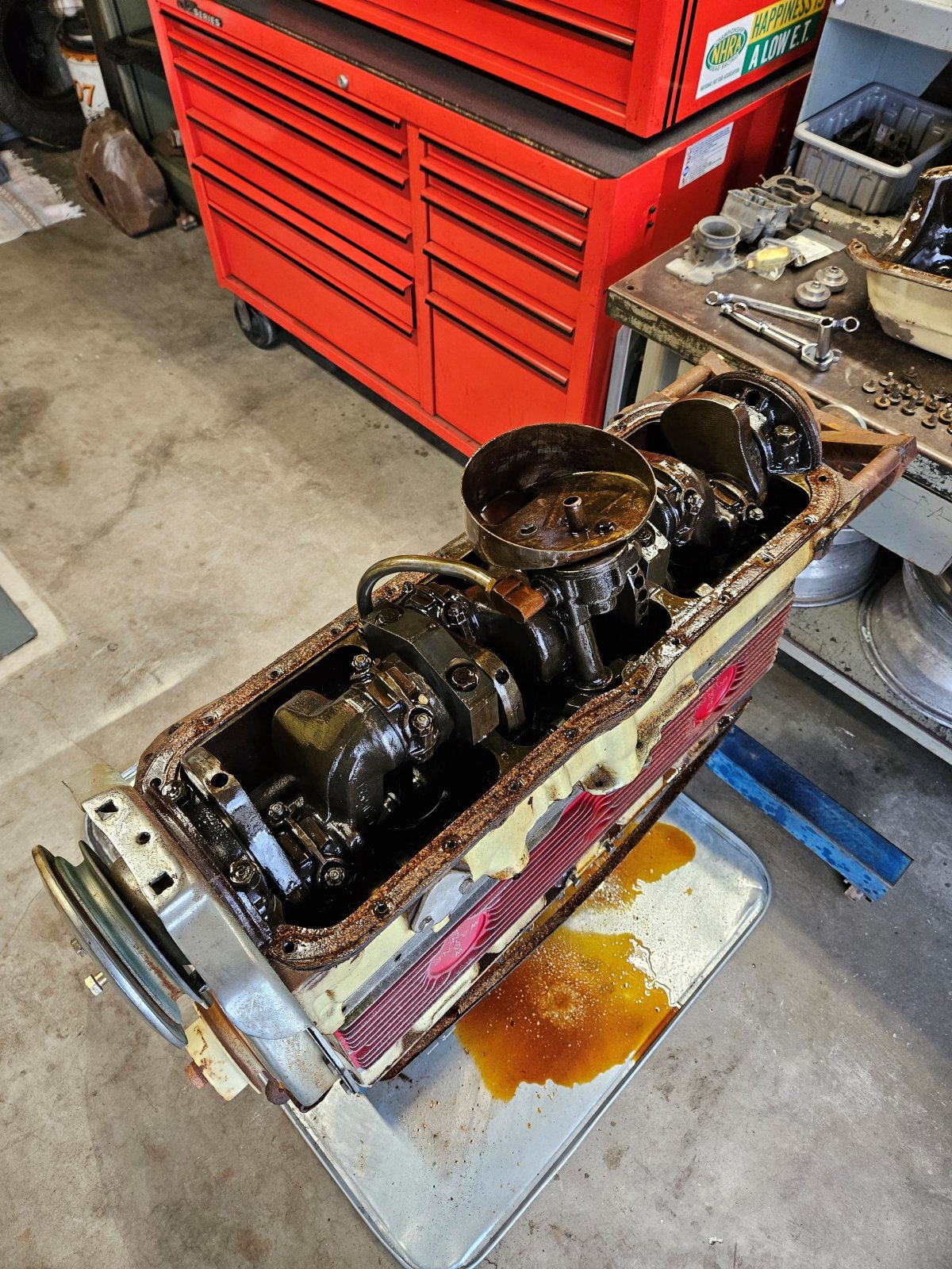

    Pulled the head on the Jimmy last night and it looks good! The cylinders need some love in a couple holes, but for sitting for at least 5 decades, it looks killer. It definitely would have ran if I tried, but I think it'll be smart to clean it up as much as possible without serious machine work and run it as is. However, the dome on these pistons is no joke! I will bring the piston and head into the piston shop and have everything reverse engineered. I need to pour the piston and chamber, but I'm expecting a high C.R. number. This may change whether I'll run it as-is, or have to rebuild it with streetability in mind. We still having forgings that'll work for a Jimmy with a medium dome.
    These pistons are very trick. At this time, my grandfather would be founding Venolia Pistons with Bob Toros and I wonder if this is one of their cast pistons prior to introducing forgings in 2618 alloy. They have beautiful pin towers with a lot of support, hollow domes and are extremely lightweight. The rings are 3/32, 3/32 and 5/32. The top and second rings are m***ive, but the second ring is a napier style which is very advanced for its time, and it also has an expander behind it to increase radial tension which I have never seen before. The oil ring is only 5/32 which is impressive though, as I would have expected a big 3/16 ring or larger.
    The T-handles were made by my great-grandfather, Nick Sr., who was a blacksmith and welder for the Southern Pacific Railroad for 45 years. These tools, along with many others were made for my grandfather during his younger years. They worked like a charm! My grandpa would brag that his father worked for 45 years and never missed a single day of work in his career.

    Wholly ****! Mega dome!! I remember that one guy in Ben's video said 'We fired it once back here and it was LOUD!' Well, now we know why lol.
    I wouldn't kill the compression, your Grandfather's race car is worth spending 15 bucks a gallon on. That thing would sound so good with that much squeeze and open headers.
