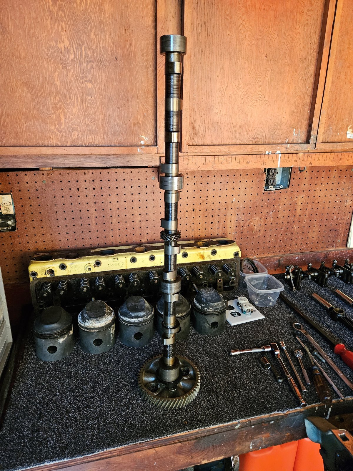

    Definitely reground on a GMC stock steel Military cam. You can check the cam lift with dial or electronic caliper the multiply it times 1.45 which is very close to the actually stock rocker ratio. subtract .012” on the intake and .018” on the exhaust. I’m betting it will be close to .300” at the cam.
    To give you an idea what I use the cam lift on my racing stock head flat tappet today is closer .400” and the rocker ratio is over 1.6. My sons 302 uses a reground cast GMC Howard with a .298” cam lift on the street with stock rocker an his street engine and it has a great sound.
    It great hearing what you’re finding.

    Thank you sir. You're right about the cam.. with calculations of 1.5:1, the gross is around .440 or so, and less on the exhaust. Today I'm taking the cam over to Isky to have it checked on the Cam Doctor, as well as straightening and polishing. I need to borrow a mag base dial indicator once the engine is back together for net lift. After everything, it'll probably be in the lower .400" area I'm guessing.

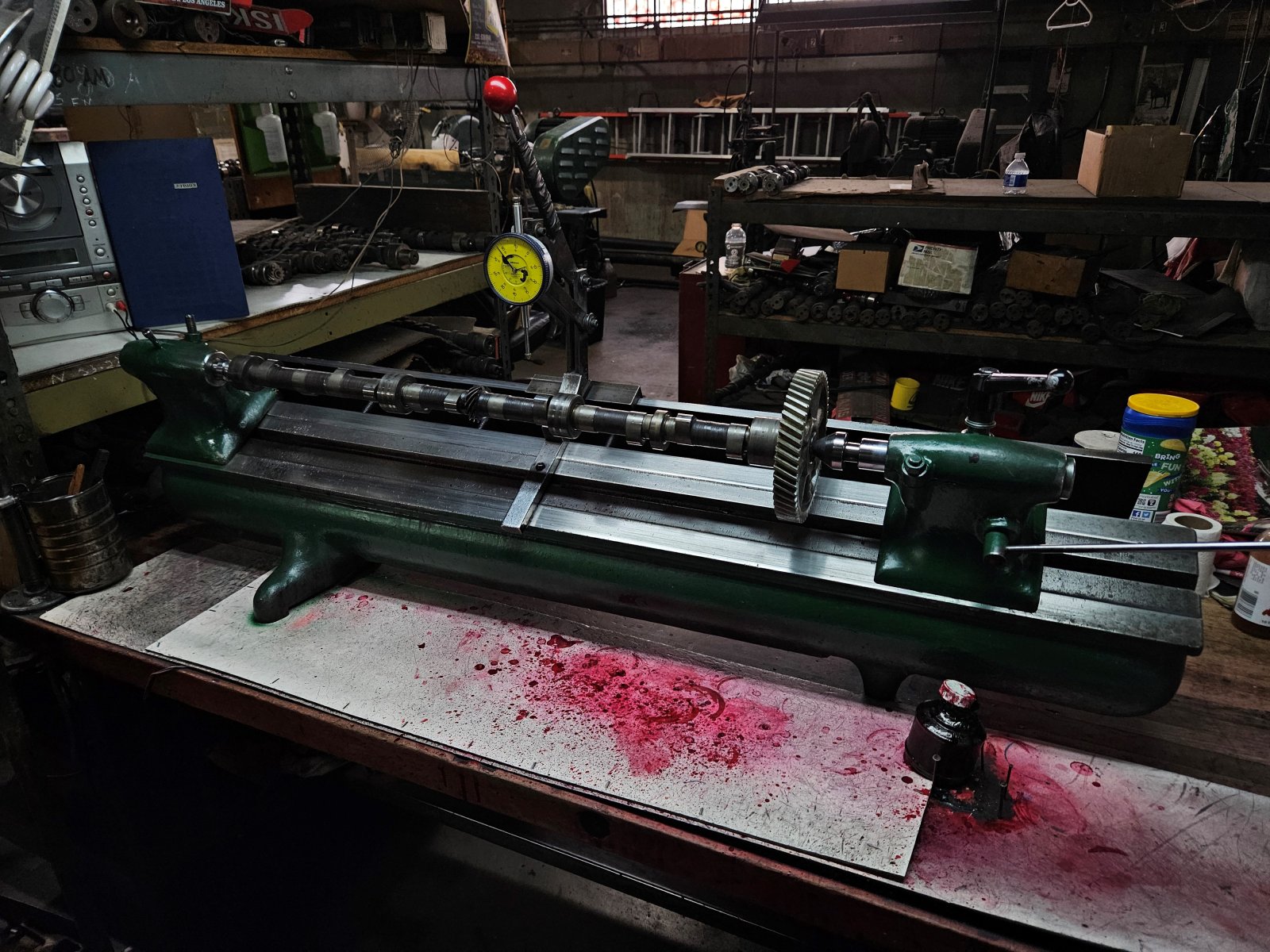

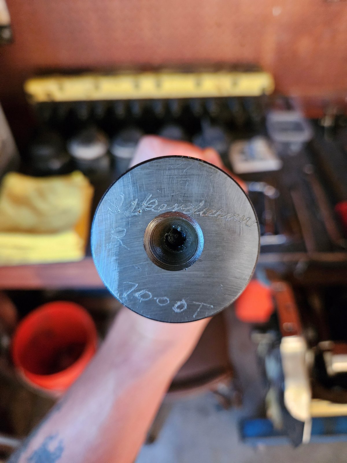

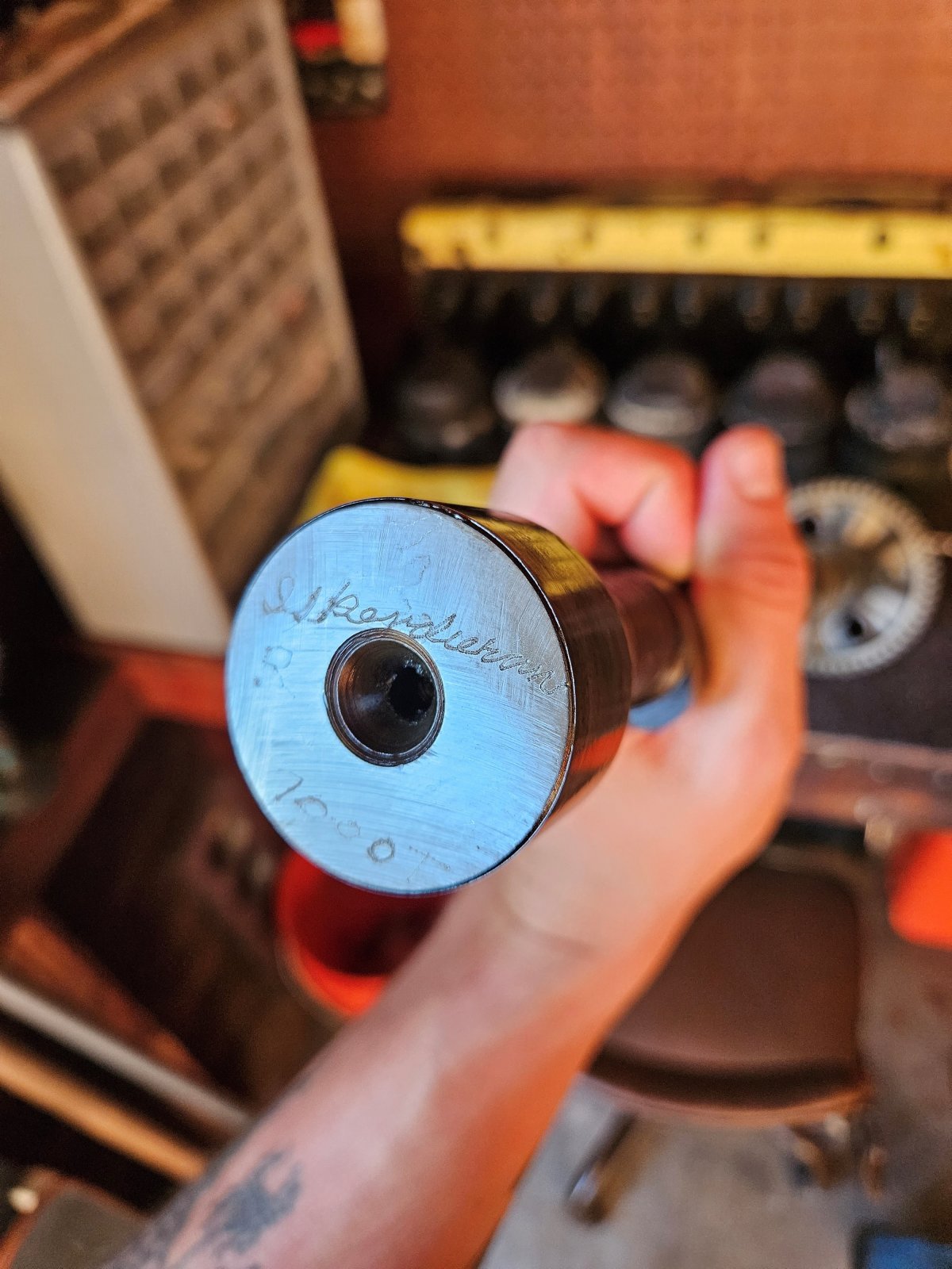

    Spent a few hours with The Cam Father last week and had a great time as always. Though the cam grind is a "7000T", he instantly recognized the profile numbers being very similar, if not identical to the "Bigelow", named after the late Kenny Bigelow who worked for Isky in the late 40s-early 50s. Kenny was also my grandfather's high school friend who unfortunately passed away after a fatal wreck in the first '37 Chevy at El Mirage on October 21, 1951. The close connections with this car continue to amaze me! The camshaft was in remarkable shape and only needed the typical service- polish lobes and bearings and straighten. If anyone has seen the process of straightening a camshaft, it's pretty amazing...and probably done exact the opposite of how you'd expect.

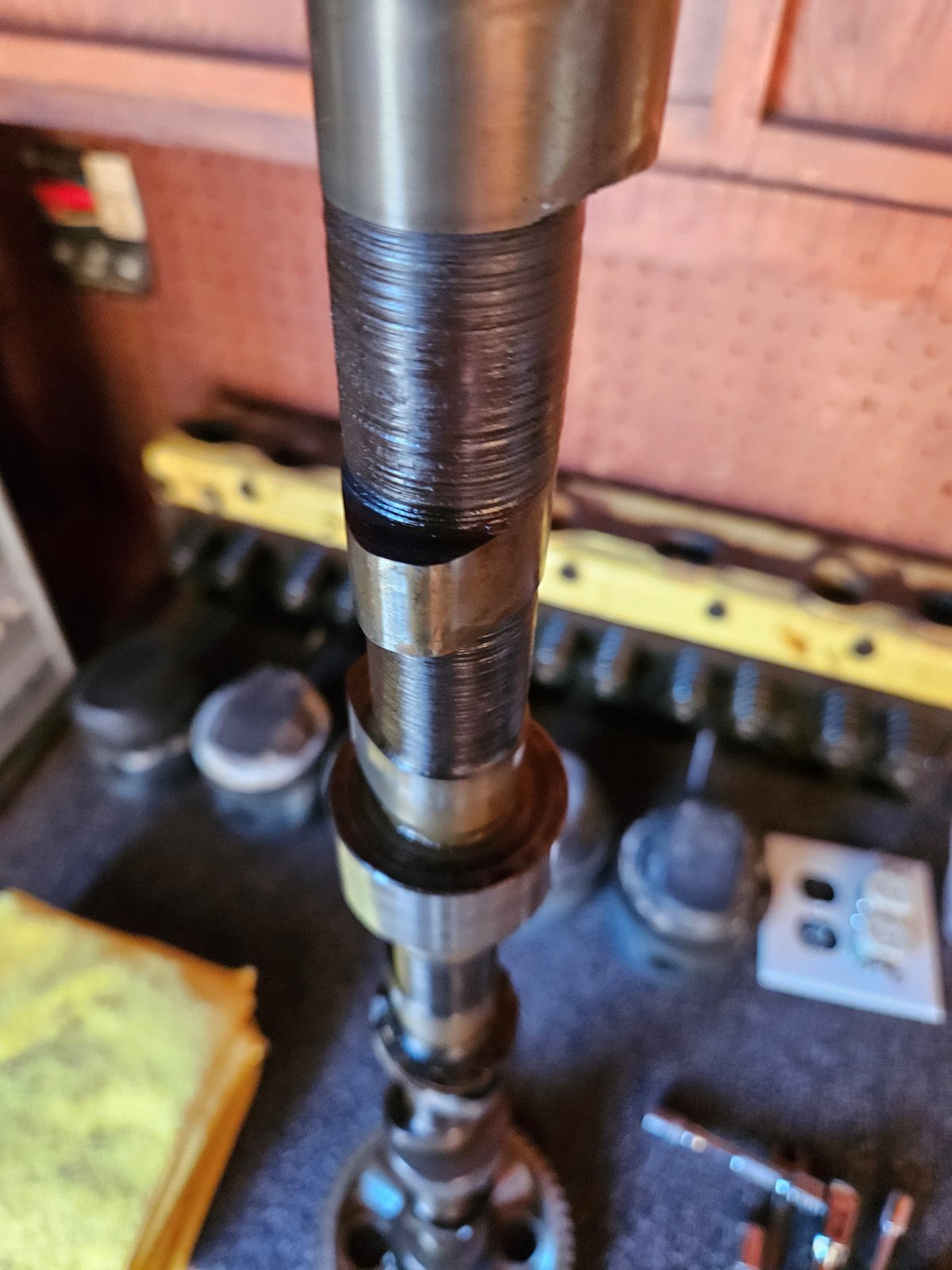

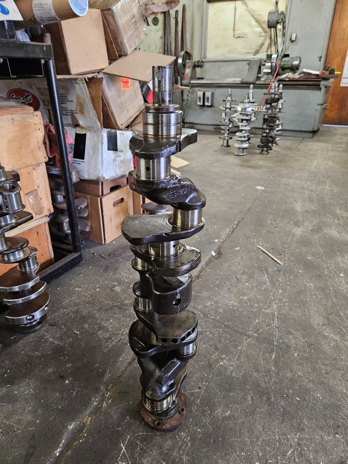

    The next day, I dropped the crank off to Henry Velasco for his "100,00 mile tune-up"- straighten, polish, chamfer oil holes and drill and thread snout. This guy is made of gold.

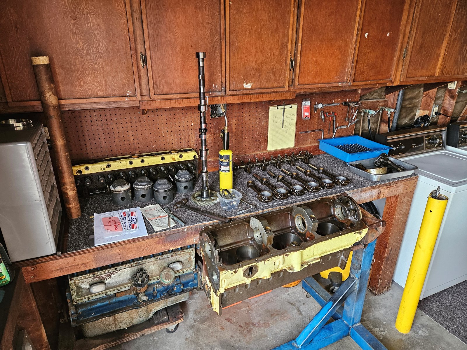

    Couple random shots...

    You don’t want to watch one of Henry’s guys straighten the crank for sure.
    Nice photo of the center main caps. Line boring a GMC with all the mains being different diameter was always a pain. With all the Evan’s machine shop tooling being sold I have no idea who can do it now…

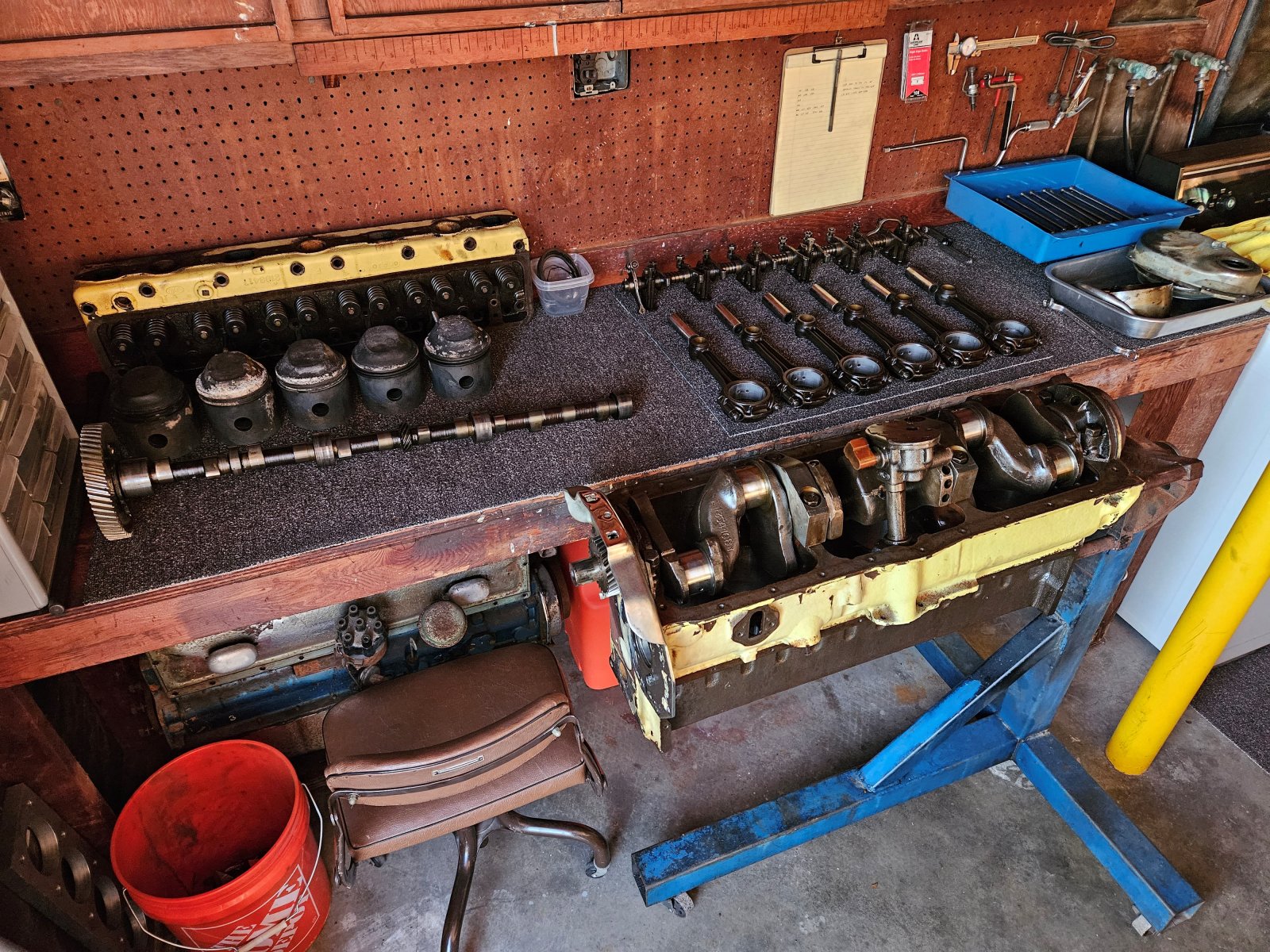

    Small update... it sure helps to work at a piston shop when you need a set! Turns out these puppies had a dome CC of 118! I need to measure the deck and chamber size, but from what I have here, it's right around 13:1. This thing probably sounded wicked in its day... and will again soon!
