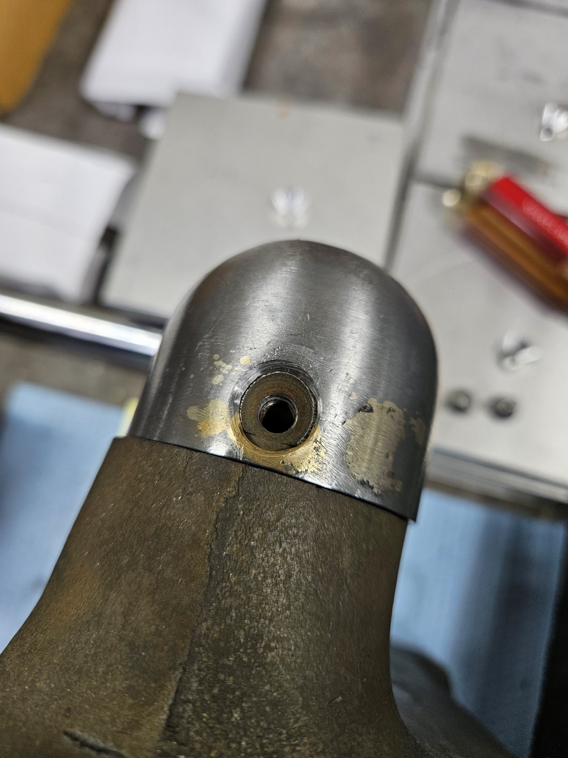

    Justin,
    When did John L. Crockett pass away? Amazing you were able to get ahold of his old scrapbook and that jacket! Any other stuff from his estate related to your car?
    Where is the head leaking from, is it repairable?

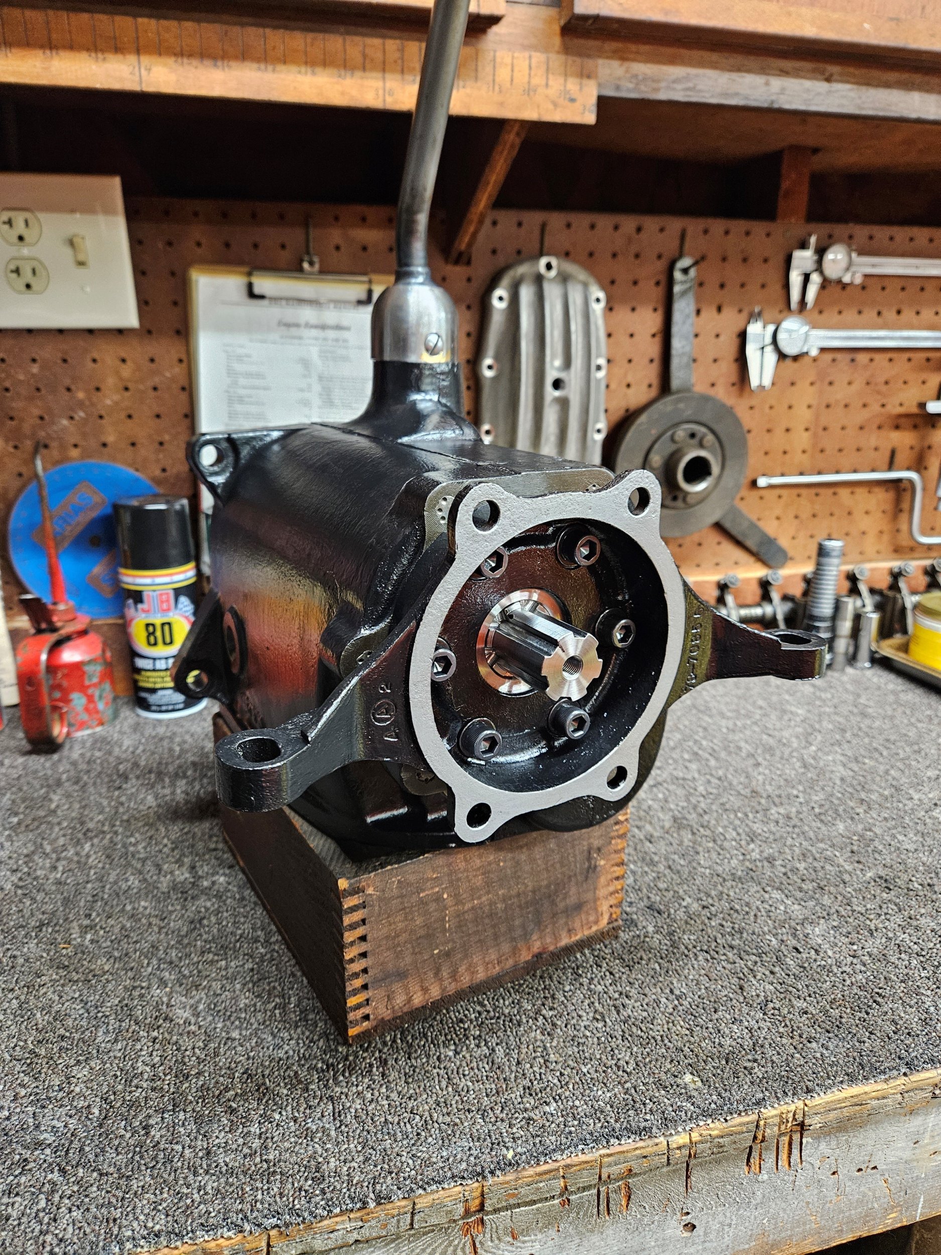

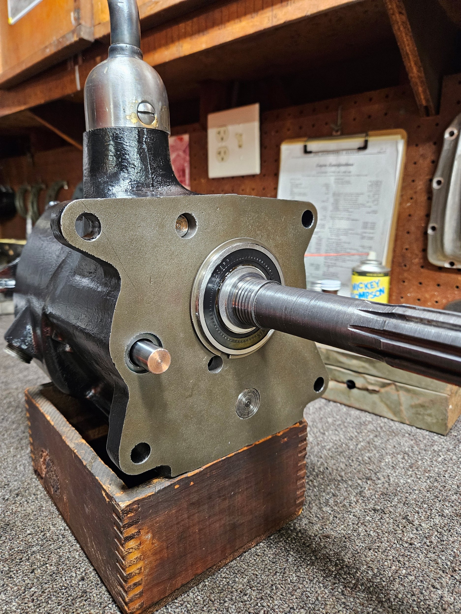

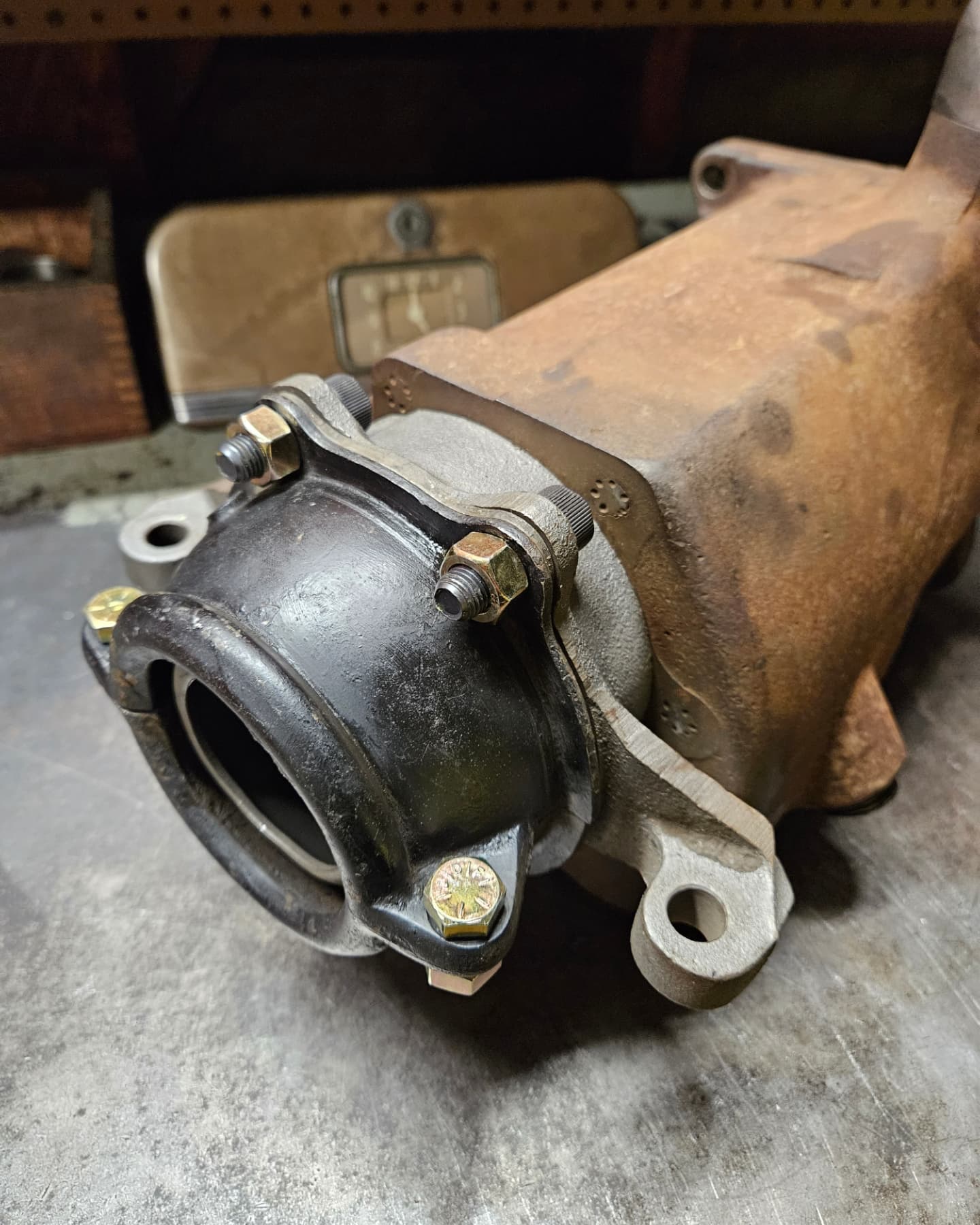

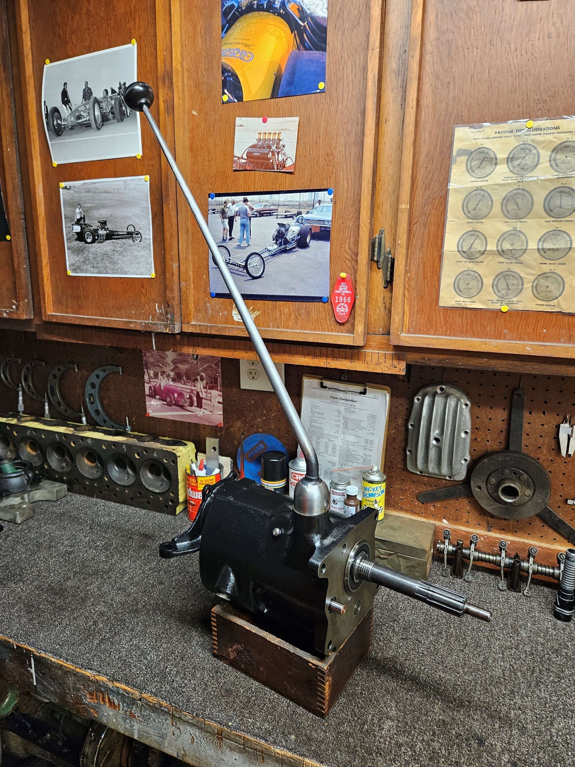

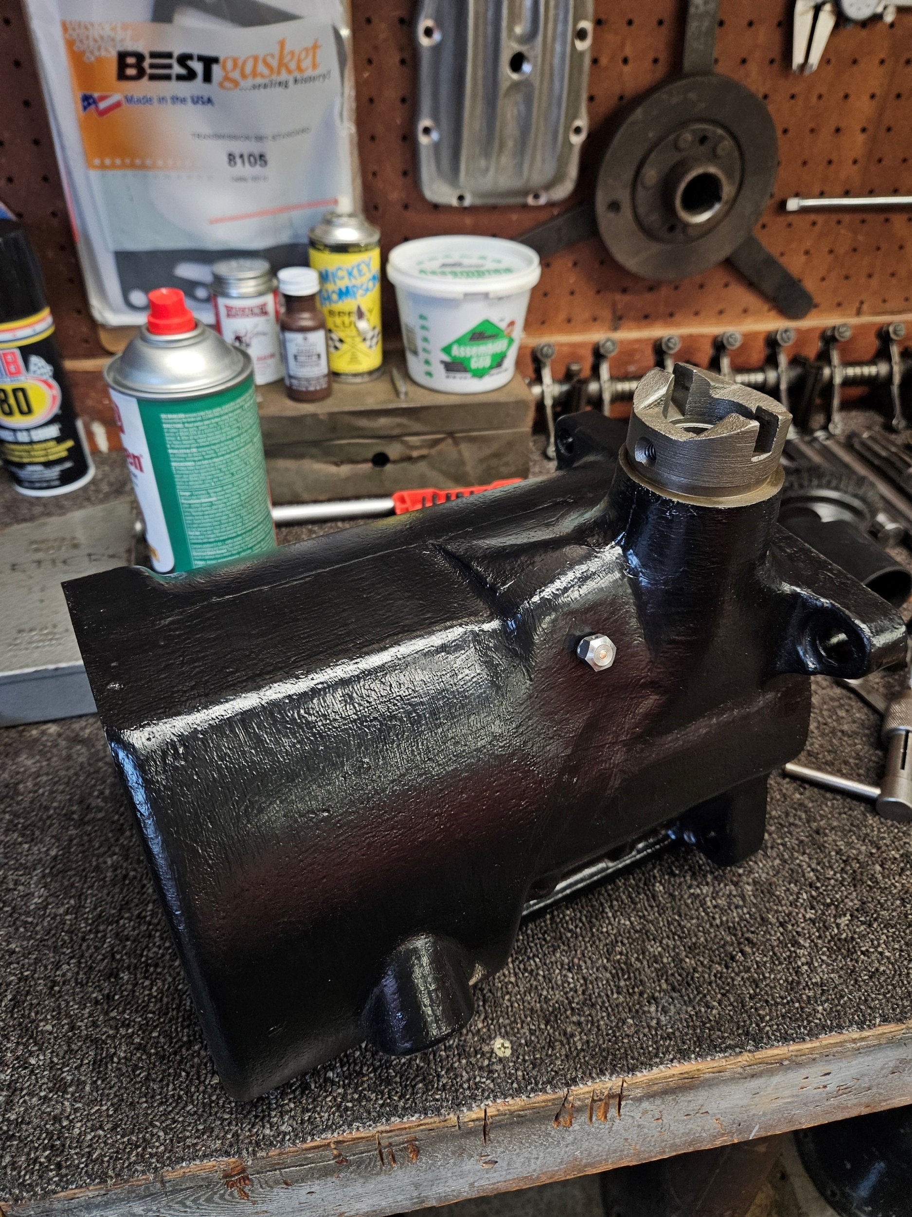

    The LaSalle is finally done getting machined, hot tanked (dishwasher) and prepped for final assembly. I got this case from local hot rodder Augie Esposito that was already modified for closed drive Ford, so the remaining work consisted of minor, but tedious, upgrades that'll help this thing live longer but more importantly, seal better. The shifter shaft hole was counter bored deeper for a press in lip seal and chamfered the rear cluster shaft bores for o-rings, and the rest of the work went into the internals, gears, and a bunch of custom parts that no one makes any more. For as simple as these transmissions are, this one was a task!
    Next step is to have Ken McAlister spline the main shaft for me and it's ready to go together.

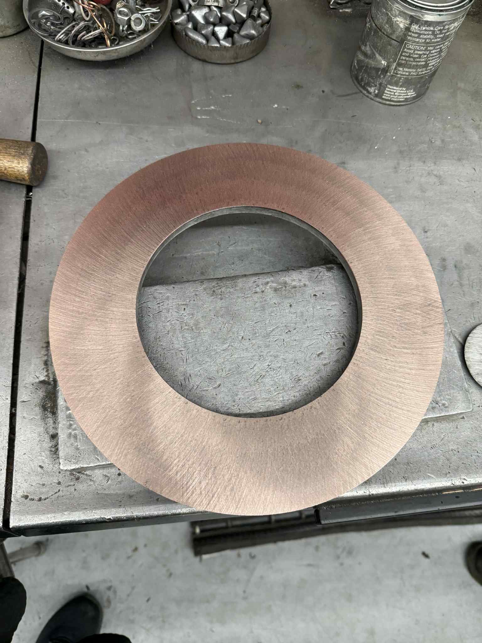

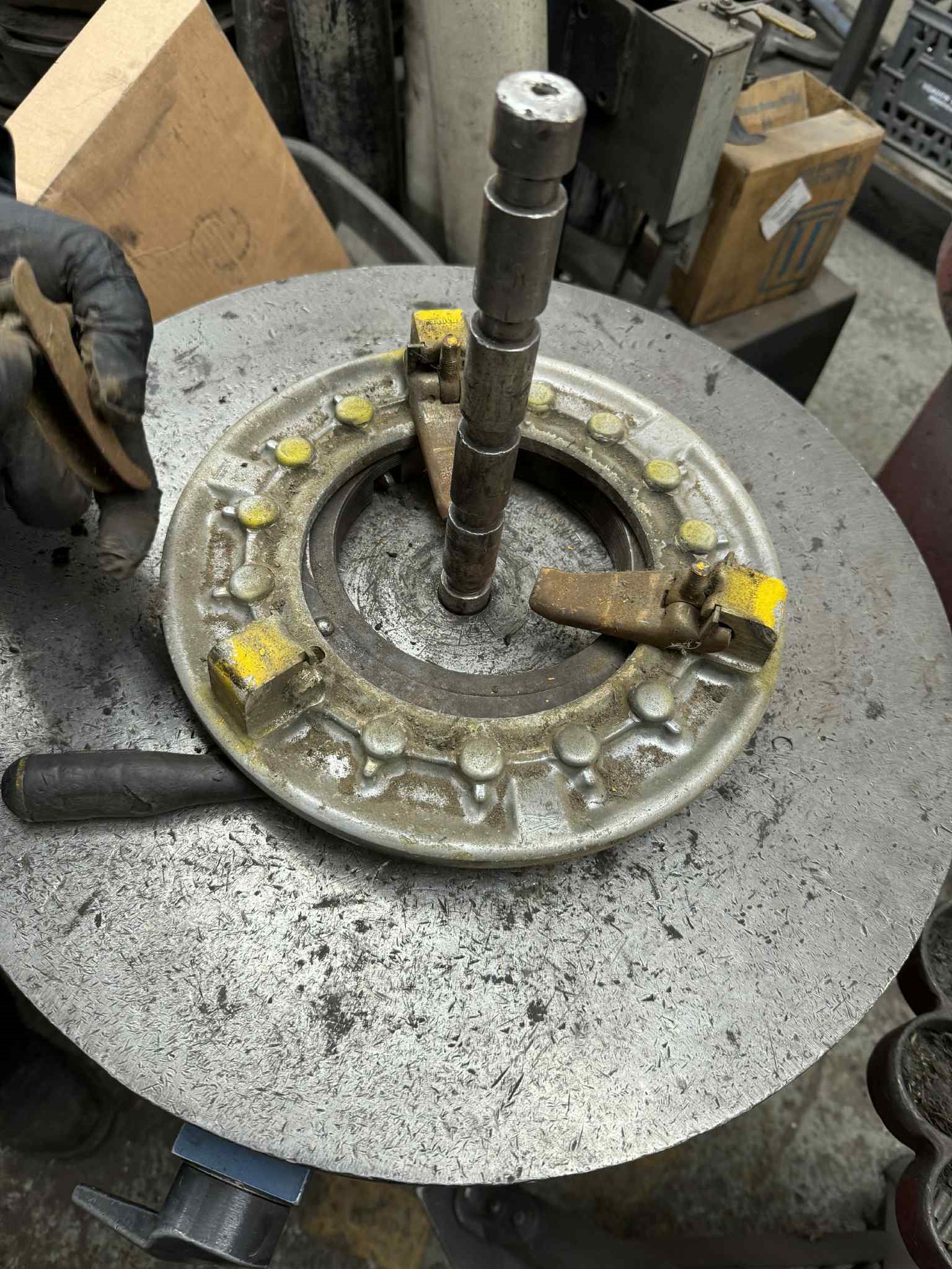

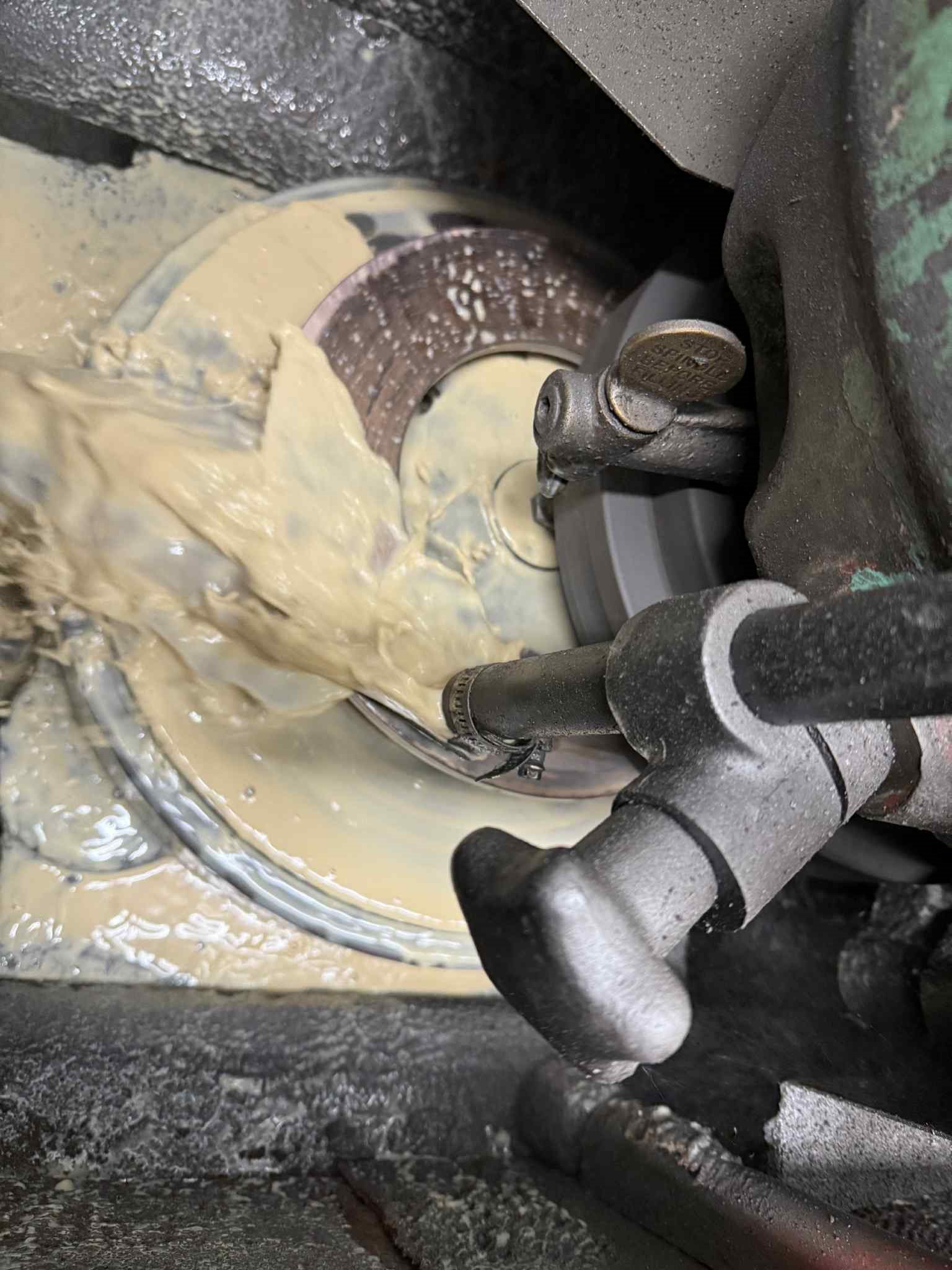

    Some solid progress being made. John Beckner at Montana Clutch & Driveline in Billings, MT is rebuilding and resurfacing the all-aluminum Schiefer clutch and flywheel, but is installing a steel insert into the flywheel like your typical aluminum type today. This one was just bare aluminum with some sort of face coating direct to the clutch and it did not like it, so it's getting a little facelift to allow me to drive it without worry. Ken McAlister has cut the Ford splines into the LaSalle main shaft for my Lincoln Zephyr u-joint, and I've been busy machining the rear mount for Cad bearing and other little miscellaneous things. I'm also very excited to finally run my sweet GM-LaSalle adapter by Cooks Machine in LA. My grandpa used to frequent Cooks, so it's cool to continue using period correct parts from the same area. New (old) center caps were added to the stock front wheels with a little adjusting of the retaining clips and they now just need to be wrapped in the correct Firestones to get the look. I've also begun the process of rebuilding the Strombergs, first of five. Tuning these will be a chore, I'm sure.
    Slowly but surely...

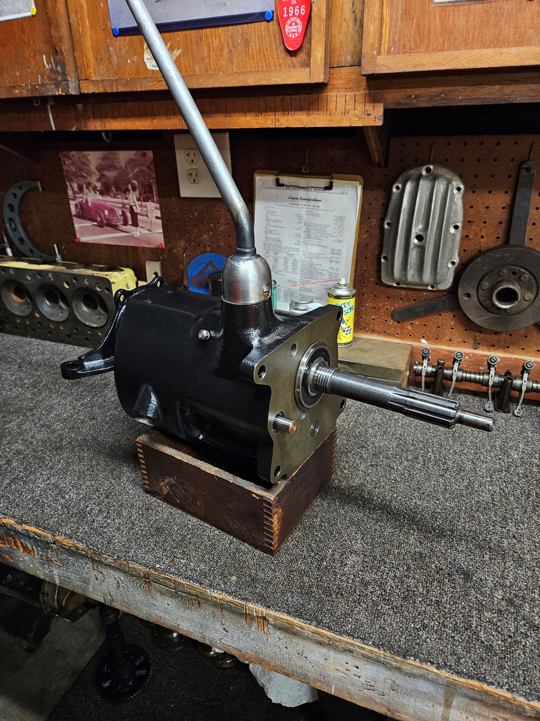

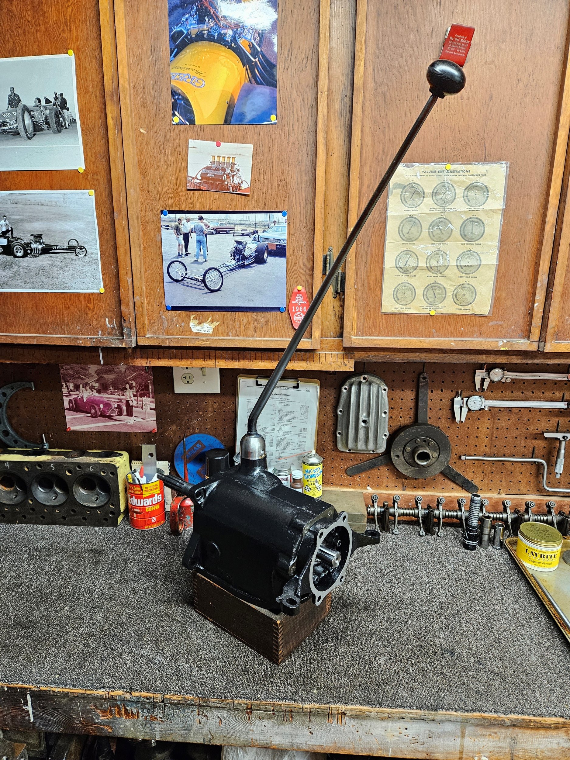

    Got the LaSalle assembled last night with my girlfriend and everything went pretty well! There's a lot of custom work in this thing and it's nice to see them all working together as a whole. On to the next!

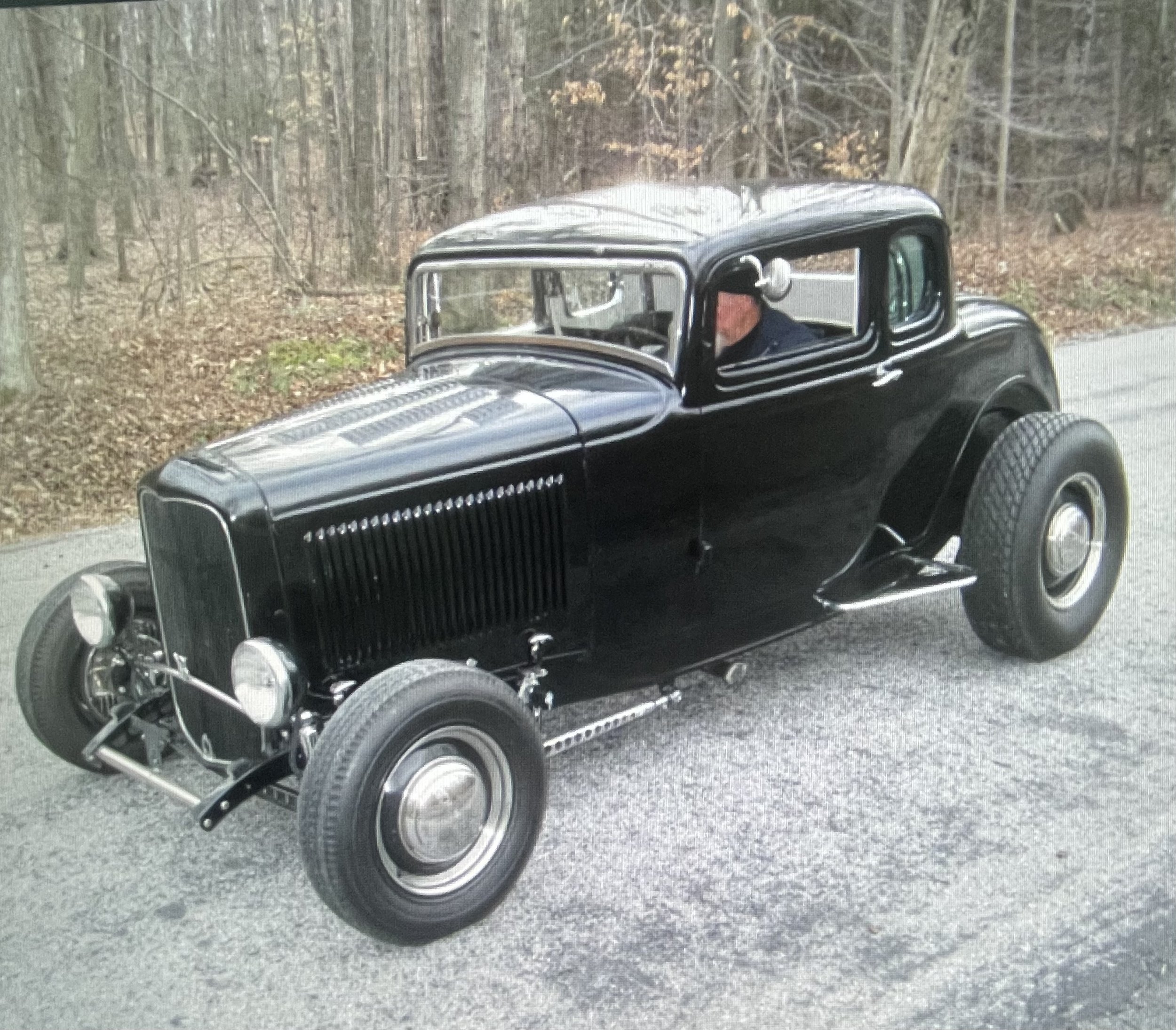

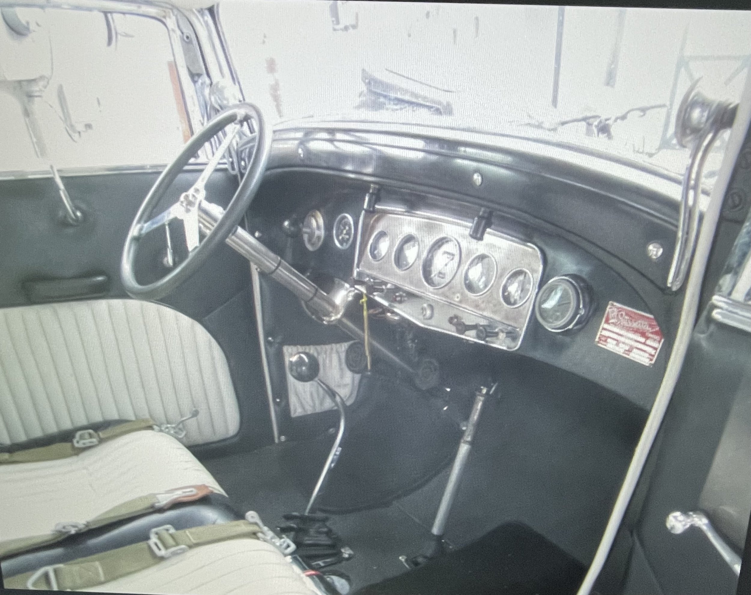

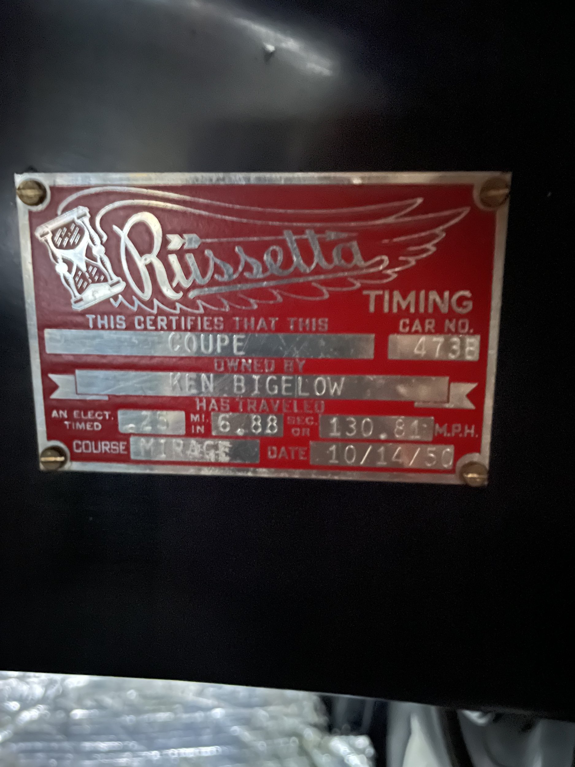

  21. So this Rusetta timing tag is on the Auburn dash in a 32 Five Window I bought some years back. The coupe was owned by Dwayne Rogers who supposedly was a friend of Kenny Bigelow. I'm trying to find out if Bigelow owned this coupe or Rogers just snagged the tag. Its dated the year before Bigelow died.
    Looking for history on this coupe. IMG_3685.jpeg IMG_8353.jpeg IMG_8351.jpeg IMG_8352.jpeg
  22. Talked with Dwayne Rogers yesterday. He did not remember where he got that tag. He knew who Ken Bigelow was but did not him personally. So no story here.
    porkshop, loudbang and chryslerfan55 like this.
