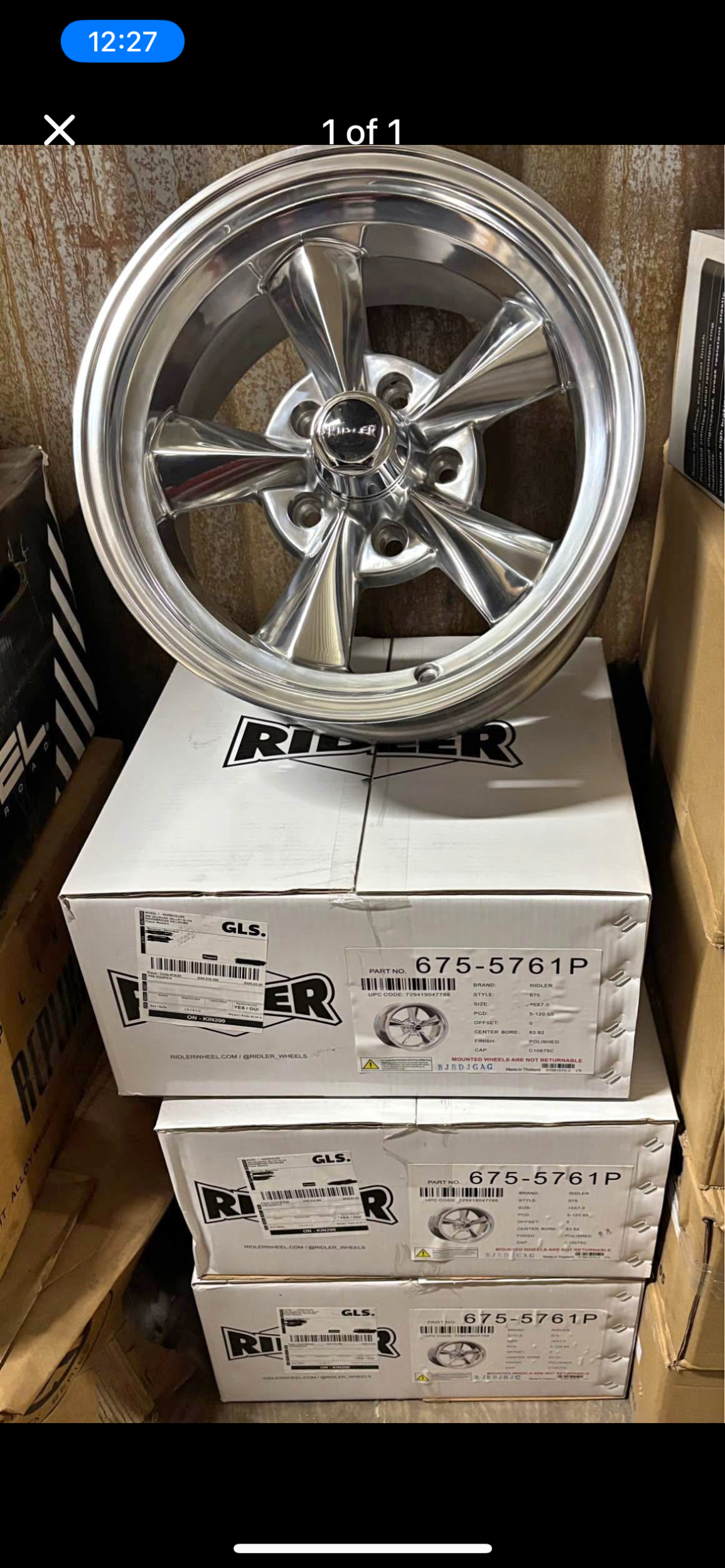

  1. IMG_0674.jpeg IMG_0631.png IMG_9362.jpeg Found a nice set of 15” x 8” wheels
    Have a nice look to them , look like old torque thrusts .

    Wheels look good, but isn't 8 inch wide too wide?

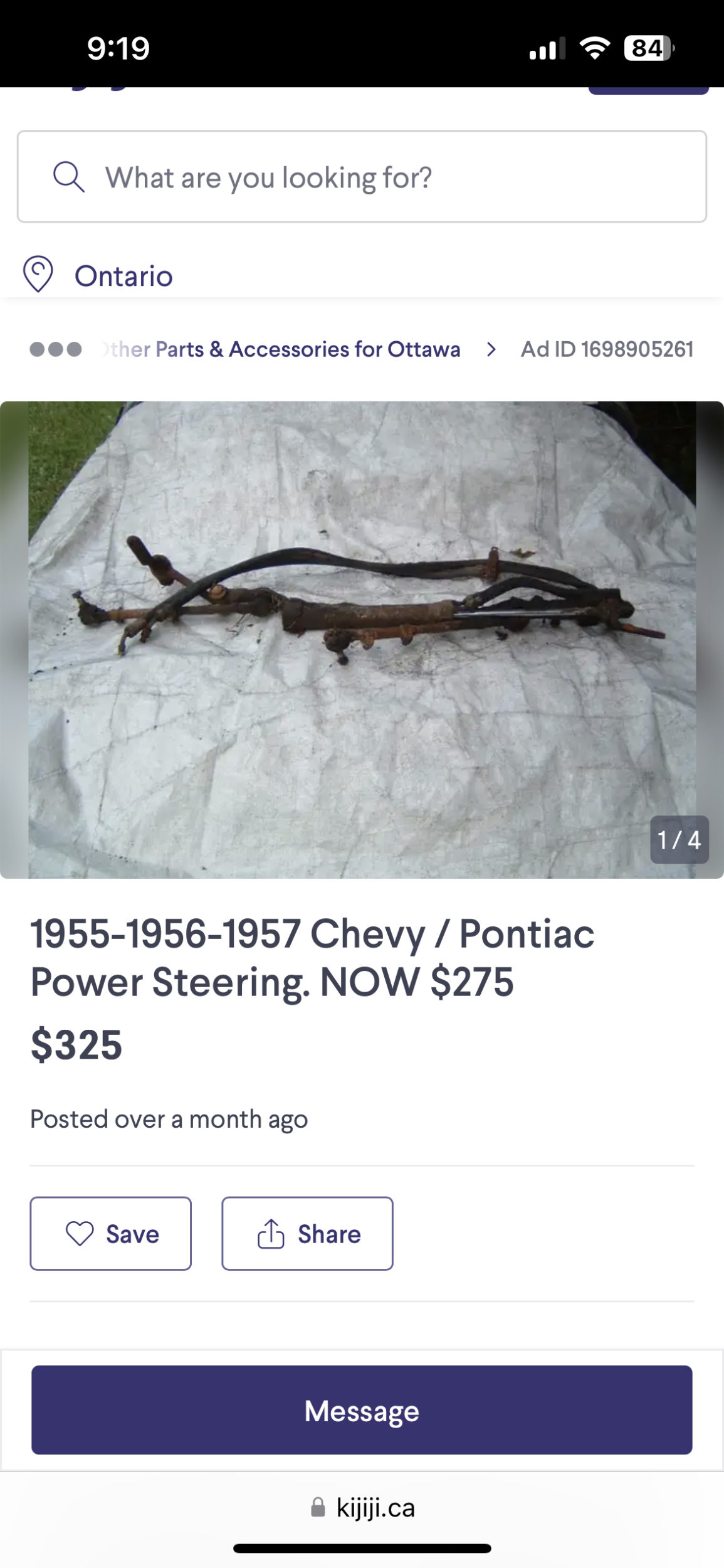

    do you have power steering?
  19. No I don’t , but was thinking of this
    Tow Truck Tom likes this.
  20. I have a 383 T5 going in it with a power steering pump
    I’ve seen v8 trifives with the power steering box and it’s awfully close to the manifold

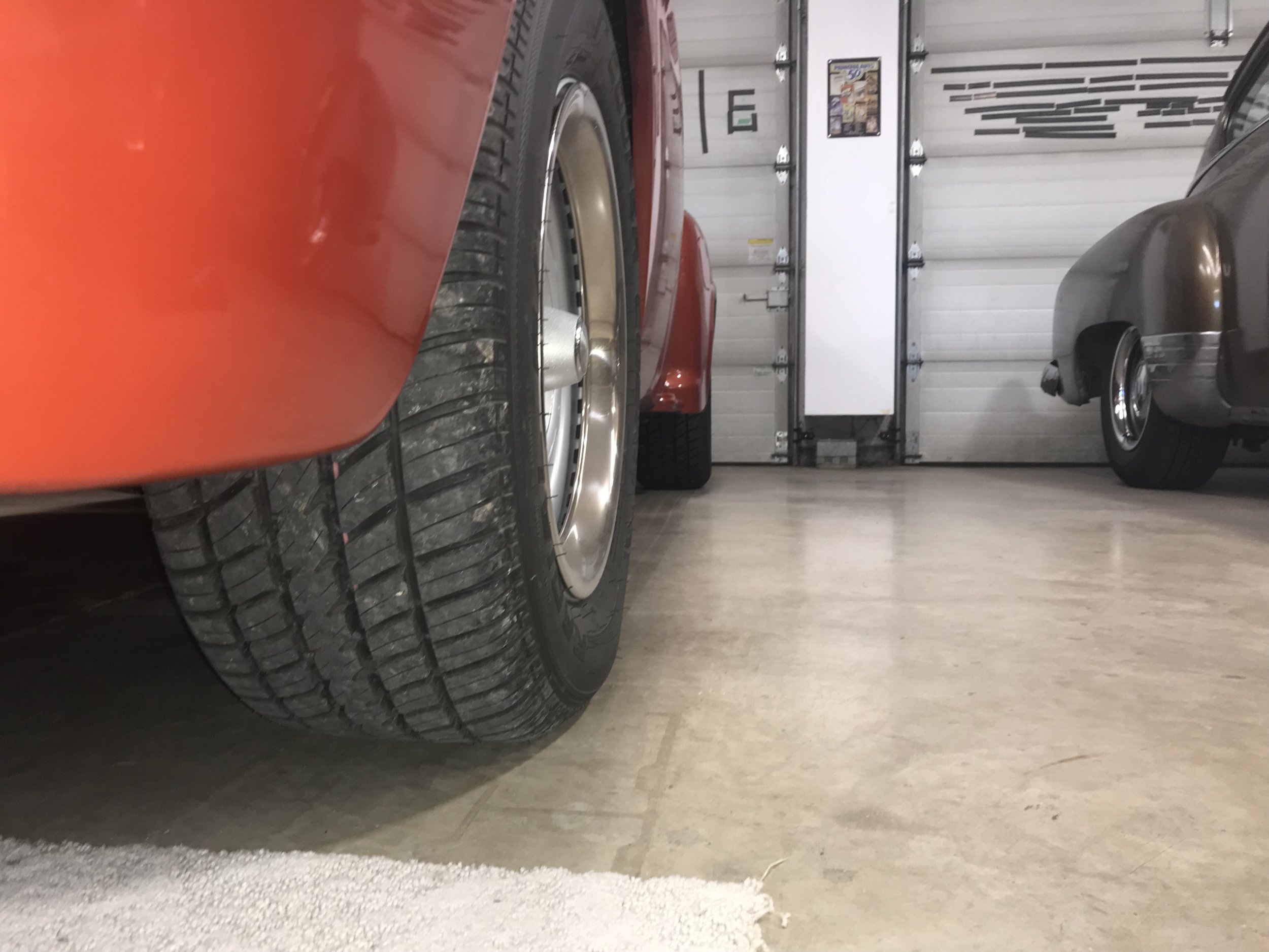

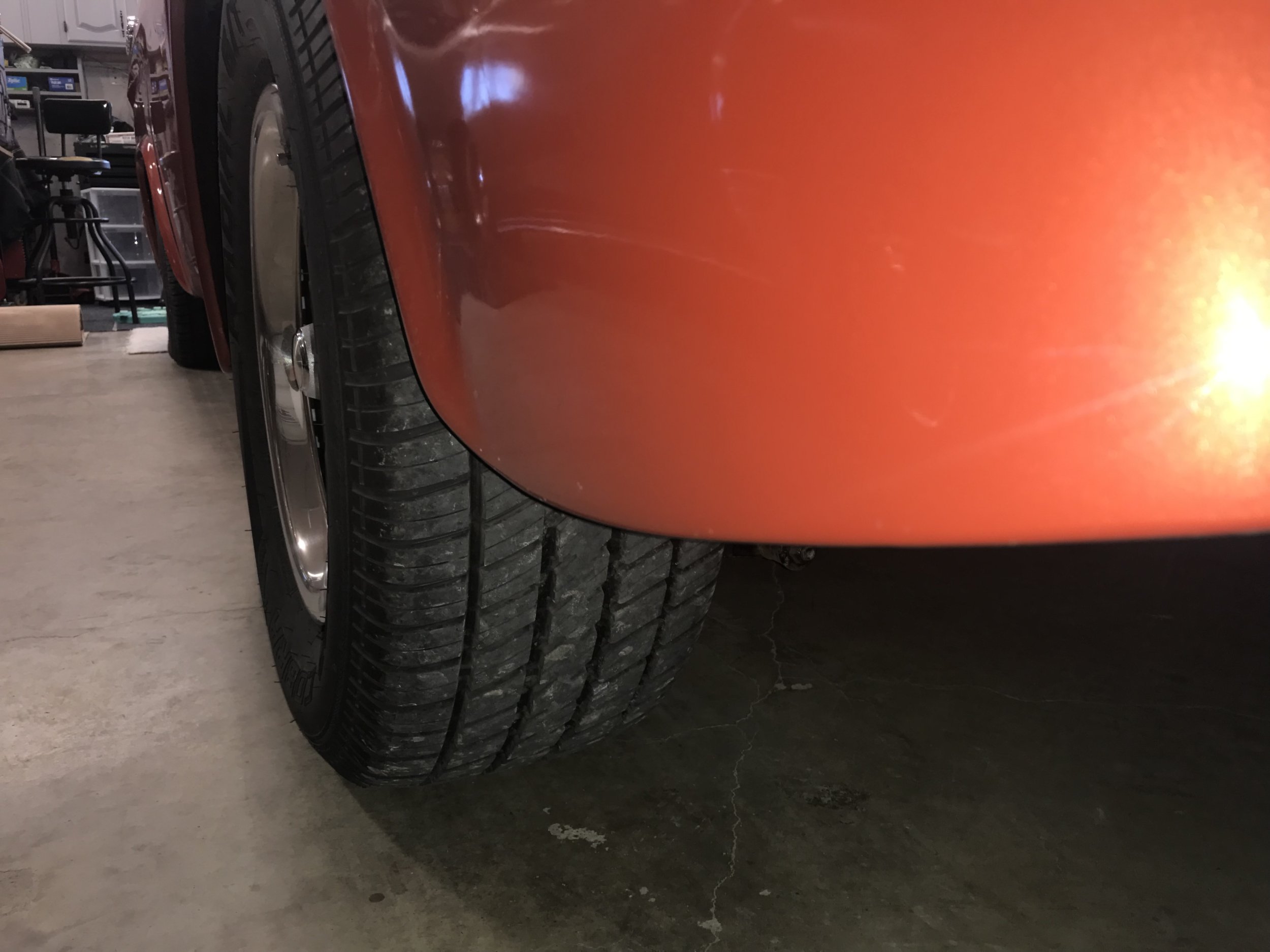

    To give some perspective…these are 255/60 -15 Cooper Cobras on a 7” wheel IMG_3670.jpeg And this is a 235/60-15 Cooper Cobras on a 7” wheel IMG_3672.jpeg

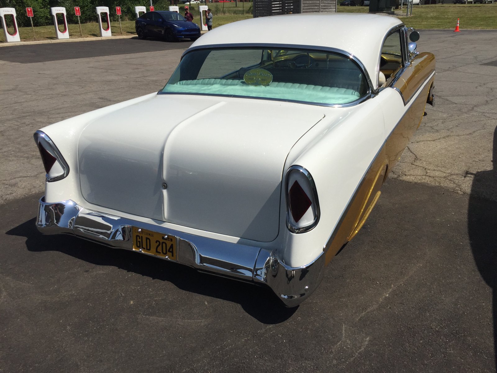

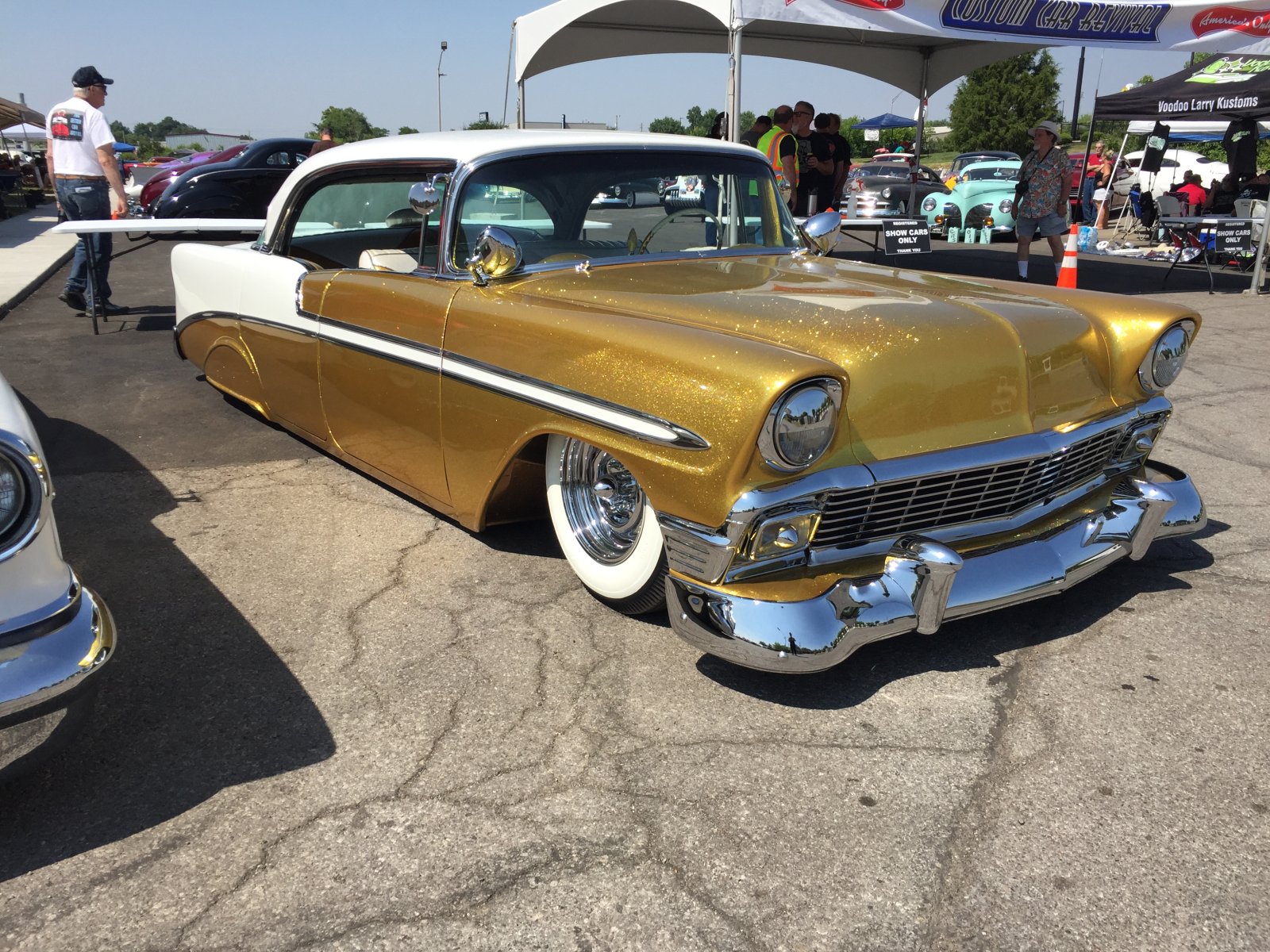

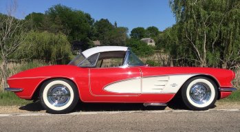

    before you buy 60 series wide tires and mount them making the wheels un returnable you had better remove a rear wheel and measure for room so you don't have rubbing problems. And yeah even though those are 15 inch 5 spokes, those ridler wheels are way too modern for my tastes. If it were me I would do something like this 56gold.jpeg 56gold2.jpeg

  26. @Moriarity that ride is faaaaaaannncy !!!
    thought about a set of tru-spokes , would not do Wide White on this car .
    thinking , shaved hood bird with a pretty cool part someone sold me :cool:
    The wheels I bought , with bullet caps , so no riddler cap
    Black wall tires .
    remove the over riders on the front bumper
    I found a wagon rear bumper center section , I now need to find the outer ends ( my car has one piece bumpers ) I like the plate in the bumper look
    And was thinking a set of mini side/lakepipes
    very similar to what you have on your vette .
    Like this with functioning cut outs ( would like to find a set of cable controlled cut outs .
    thinking the look I’m going for is a mild custom with a tiny bit of hot rod flair .
