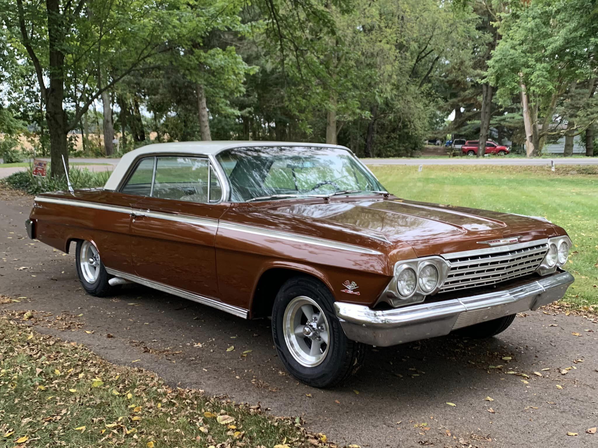

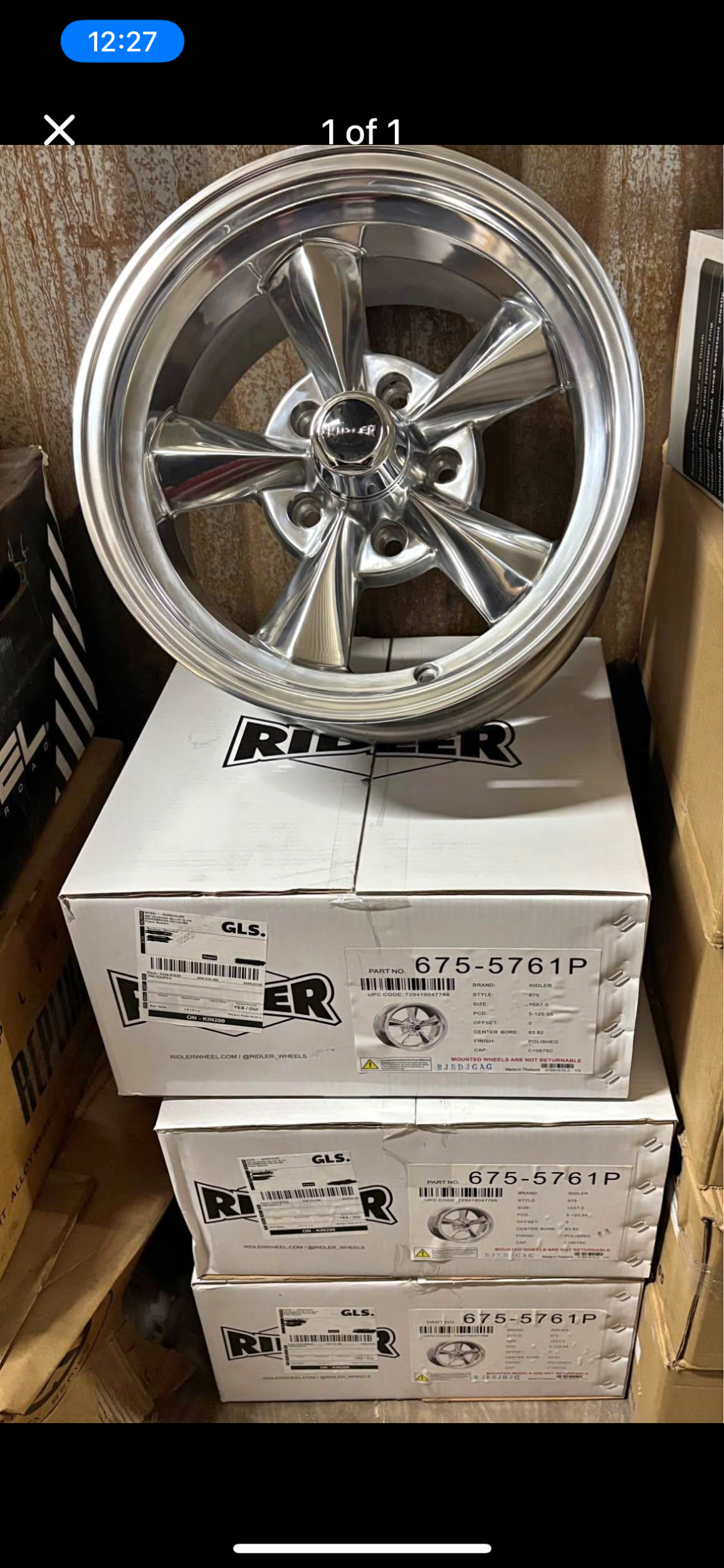

    A 255/60 on the rear would be a great look for your car (it's what I think I'm putting on my 62 Bel Air soon), however on a 7" there will be a lot of bulge to the sidewall, too much can look goofy. If you want matching heights, a 215/70 matches a 255/60 in height but looks best on a 7" wide wheel with just the right bulge.
    Those wheels you have seem to be all 7's, with the different widths you want 7's and 8's might be better, otherwise I would stick to maybe a 235 in the rear at most.

    15x7's all around. 23575R15's rear, 21575R15's up front. 60 series tires will look goofy on your (very nice looking) '56. Something with some sidewall will look, and drive, much better. 58CF8E71-1470-4C5F-8C06-814A7C752E79.jpeg 2FD2632E-20DC-4F9B-A151-DDDED4B1BC26.jpeg
