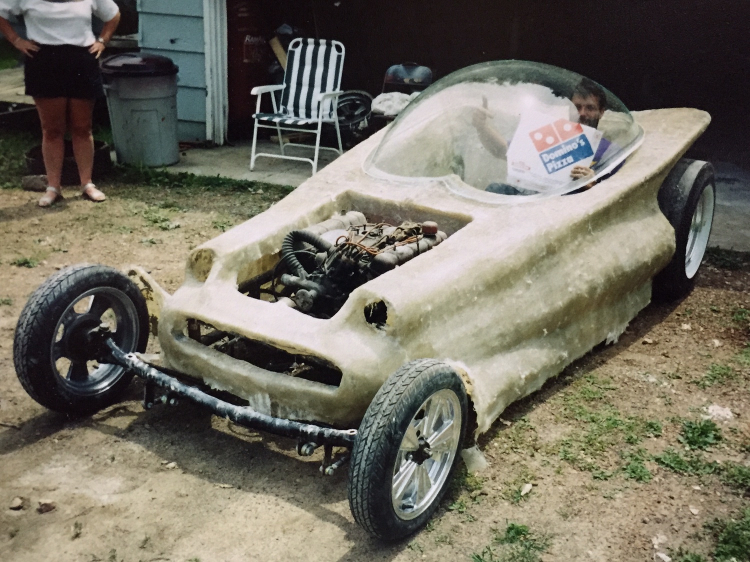

    I thought I would ad some more pics and make this sort of an after the fact build thread. I thought I had a shot of the bare frame but I couldn’t find it. It is made from 2” round tube, ladder style. I used a 57 Chev rear on coil springs and hair pins. The front axle is 37 Ford v8-60 with horizontally mounted coils. I covered the frame with sheet poly and started laying on plaster and vermiculite newspaper spit wads. These first pics are not for the faint of heart. I gotta tell ya that after a few nights of this it would have been real easy to quit. Looks horrible [​IMG][​IMG]

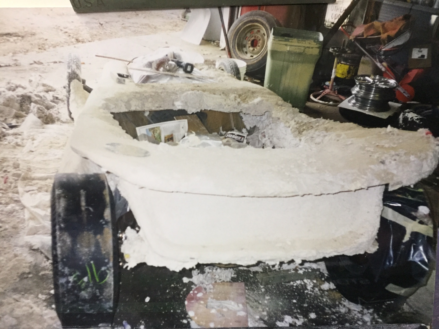

    The next step is to use a cheese grater file and whatever else works out to shape it[​IMG][​IMG]

    I screwed around too long trying to get the sides symmetrical ( I had cardboard templates all over the place) that the whole p***enger side dried out, cracked and fell to pieces on the floor.....

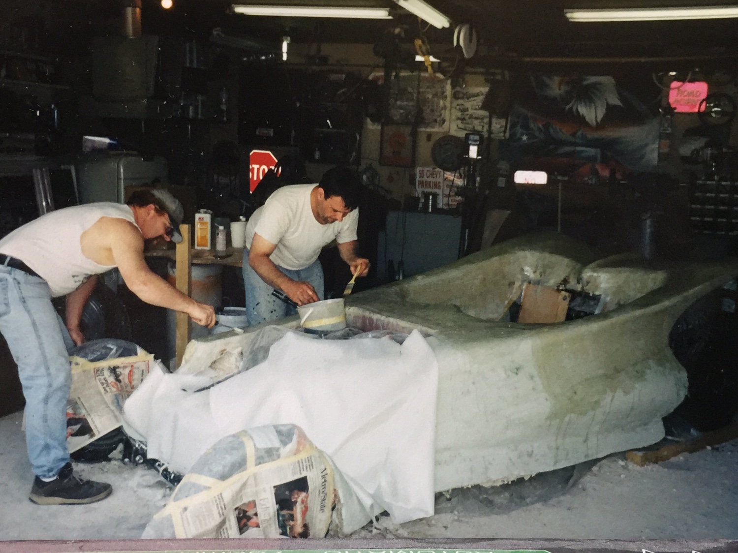

    After I finally got the plaster in shape, it was time to start laying up gl***. I used polyester resin and the first couple layers were done in cloth. I had never done any gl*** work prior to this and I was told the cloth was important for strength. The cloth was followed up with 1.5 oz mat which was far easier to with with.[​IMG][​IMG]

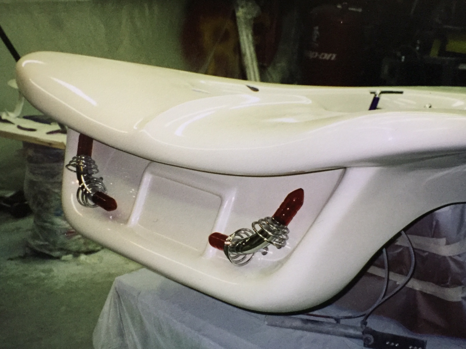

    I don’t have any pics of the bubble top mold. I made it from plywood as instructed by Ed Roth. It took 4 tries to get a decent one that wasn’t lopsided. One thing Roth said when I sent him pics of this car in primer was “I don’t know why anyone would want to build a car that looks like I built it in the ‘60’s, you should be building something futuristic “ that was actually a compliment in my eyes because I wanted it to look Roth inspired.
    Next I built some of the “fun stuff” like the tail lights. Because you can’t just put production car parts on a custom built car[​IMG][​IMG]

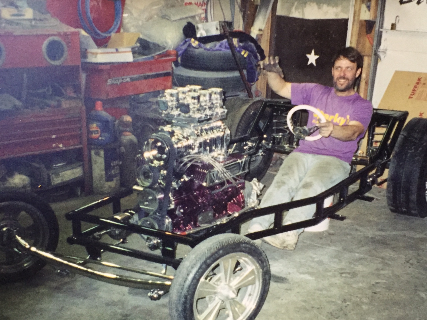

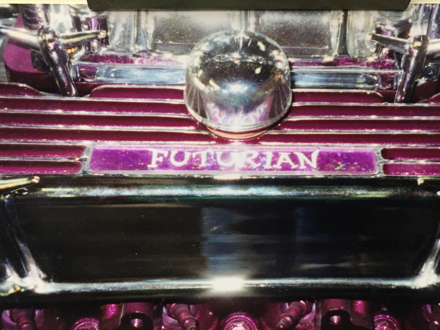

    Next it got blown apart, I rebuilt the engine which is a 215 aluminum Buick. I built my own blower manifold for the 4-71. A weiand plate holds 6 stromberg 97’s. Bored .030 over. Mallory dual point distributor, offy valve covers that I machined off the name and inserted a plexigl*** futurian name plate. The engine is painted House of color candy purple[​IMG][​IMG]

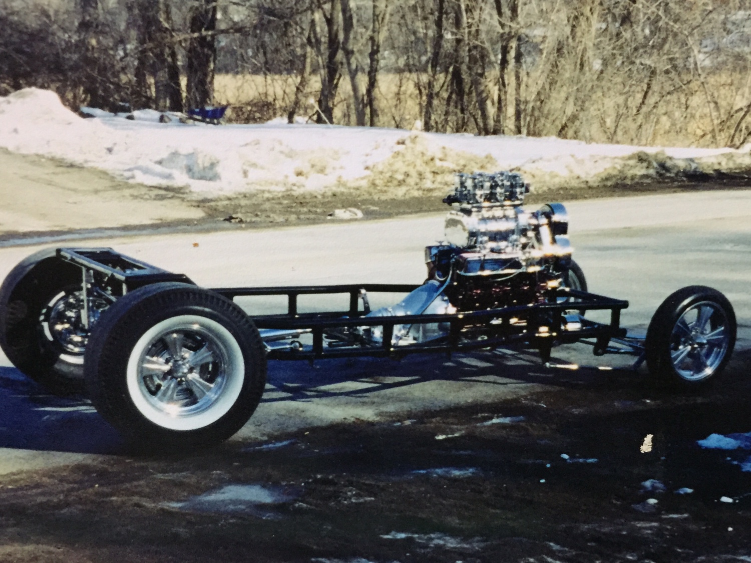

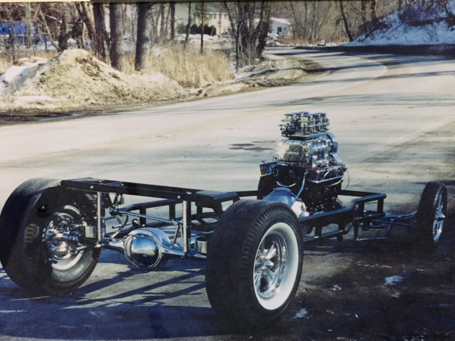

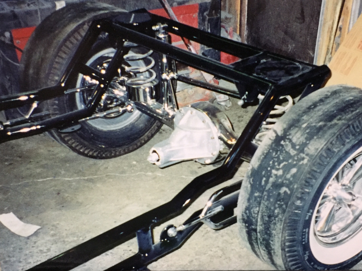

    I did all my own pre chroming polishing. That is some of the hardest and dirtiest work a person can do... pained the frame gloss black and ***embled all the suspension parts and installed the engine and trans[​IMG][​IMG][​IMG][​IMG][​IMG]
