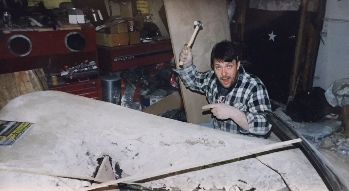

    ran across some more build pics. here I am demonstrating the finesse required i the plaster stage....
