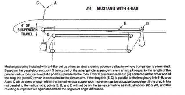

    Relax pal, like us, you're learning, none of us was born knowing it all. Just take the time to research and do it right, we know you can, look at the car from the side from fifty feet, all the 4 bars, drag link, everything should look as close as possible to the same angles, all the links need to be on the same plane, as paralell as you can get, all the hinge points need to be as close together as you can get, so the whole front end rises and falls as one unit, otherwise the different length links fight each other and create interesting driving characteristics. Got it?

  5. [​IMG]
    I know this is an old thread, but since it was brought back up, This should answer all your questions on the setup of a 4 link with Mustang steering
