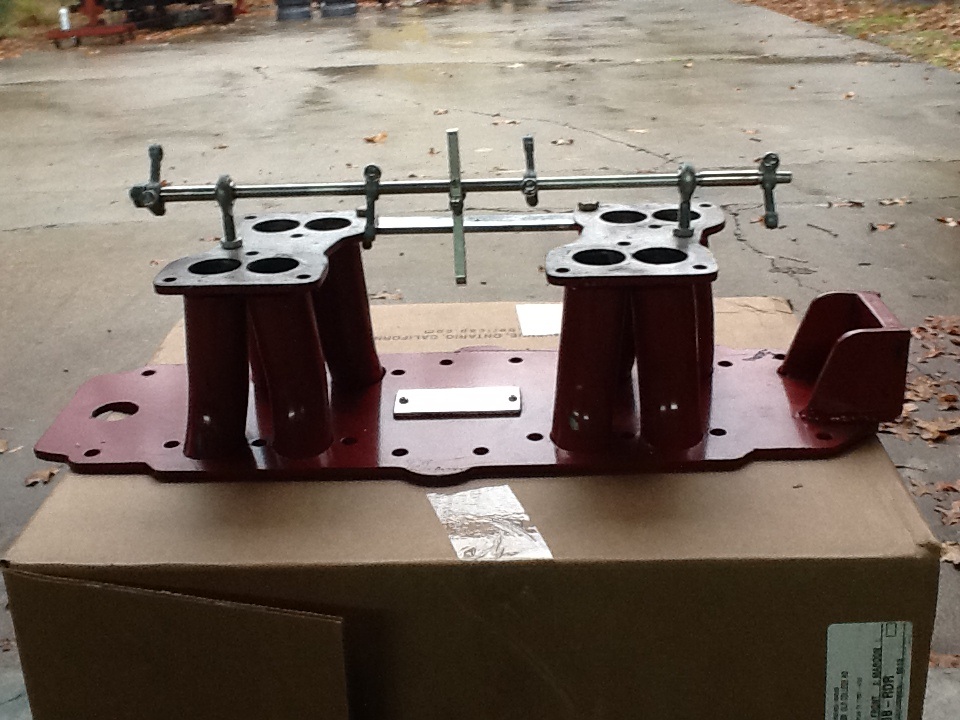

    image.jpeg I have a four carb intake(home built and named Pacific Jackrabbit) that in theory should work well;each throat feeds an intake valve and in theory(untested) each individual throat should be tuneable.All of my flat motors are always big inch,big intake valves,big cam shafts;usually lots of fun in a 2160 lb Henry cabriolet highboy
    LOU WELLS and stillrunners like this.
