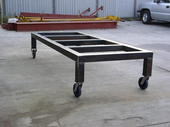

    I built mine very flat and and sturdy
    but on wheels,
    I don't use a level on it much
    but reference off the table itself
    when I do want to use a level
    I place shims under the wheels,
    plywood, plate or sheet metal
