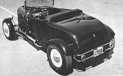

    As with other major elements of hot-rod design and engineering, front suspension schemes deserve more attention than they often receive. I agree in part that there have been some unattractive spring-in-front cars built over the years. There have been some signifincant stunners built with their springs located ahead of the front axle as well, however.
    Two of my favorite hot rods from the way-back are Don Ferraro's pure AV8 and Topper Chasse's Deuce-framed '29 roadster. Both of these car featured spring-in-front suspension and were well honored for their appearance as well as their performance. Don's AV8 held its own in beauty contests against Bill Neikamps first AMBR winner and Dave Mitchell's super little AV8 RPU. Don also logged some El Mirage laps in the 120s in the early '50s.
    Topper's roadster ran in the high 130s at Elmo when it was owned by Charles Scott, better known as "Scotty" of Scotty's Muffler Shop. Topper changed the character of the roadster when he bought it in 1948, changing out the front suspensiion for the spring-in-front scheme, blending a '40 dash into the cowl, and fitting it with one of his signature monster flatheads. For Topper, a streetable motor measured 7/16 x 1/2 over stock. During Topper's ownership and reengineering, the roadster was never beaten in a drag race, by anything! Just as important, the roadster was the sweepstakes winner at the very first LA Autorama in 1949. That was also the only time the car was ever entered in a beauty contest; that just wasn't Topper's style.
    Topper sold the roadster in late '59 to purchase another car that had caught his fancy -- a new 356 Porsche coupe. He immediately immersed himself in racing the Porsche and caught a wonderful fever that took over his life from that time onward. Topper is one of the founders of the POCA -- Porsche Owners of America, organzation president/president emeritus, super-succesuful POCA racer with track records that still stand, and a thriving consulting business for Porsche racers and teams.Pretty impressive for an old SoCal hot rodder.
    The only pics of Topper's roadster are scans from a feature story that appeared in HRM, September 1960. It was a bogus story, attributing the great vision and work on the car to its then-current owner, a student at Art Center. The car featured fenders which it never had in Topper's time, plus a really ugly windshield located midway between the '40 dash and the rear edge of the hoot. When Topper massaged the roadster to his own vision there were no provisions for a stand-up windshield. As he built it, and as he intended, he drove the roadster with his prescription glasses covered by a pair of tanker's goggles pulled down over a Navy watchcap. It was a great look, kind of manic, this intense warrior out in the wind in the cockpit of a killer and absolutely stunning SoCal hot-rod roadster.
    I'll share a couple of images of Topper's roadster scanned from the HRM story. Please edit out the hideous windshield and its grinning author. He was probably a very nice person; it's a shame he wasn't honest about the provenance of the car.

    Look close, Jay, and you'll notice that the body has no character lines on the rear quarters. It's an interesting and very difficult detail to pull off in a well-finished car. Topper was always quick to point out that Scotty was responsible for the work. It's one of the details that appealed to Topper, prompting him to buy the car when Scotty put it on the market to go racing in a bellytank.
    Topper's big 7/16 x 1/2 motor -- about 312 cid, was massively ported by Topper himself, was fitted with big Smith heads amd an Edelbrock four-pot manifold with Topper-massaged '97s. Topper built his own exhaust system with 1-3/4-inch runners feeding into a pair of '33-'34 torquetube housings. Ignition was provided by a large Pounden-modified aircraft magneto that stuck out on the front of the motor so far that the radiator had to be split to provide room for it.
    I've long felt that if Tooper Chasse had been more of a trophy hound or publicity seeker he would have a prominent place in the pantheon of our hot-rodding gods. As it turned out, he carved himself a very special place in the ranks of folks who are serious about racing Porsche motor cars.
