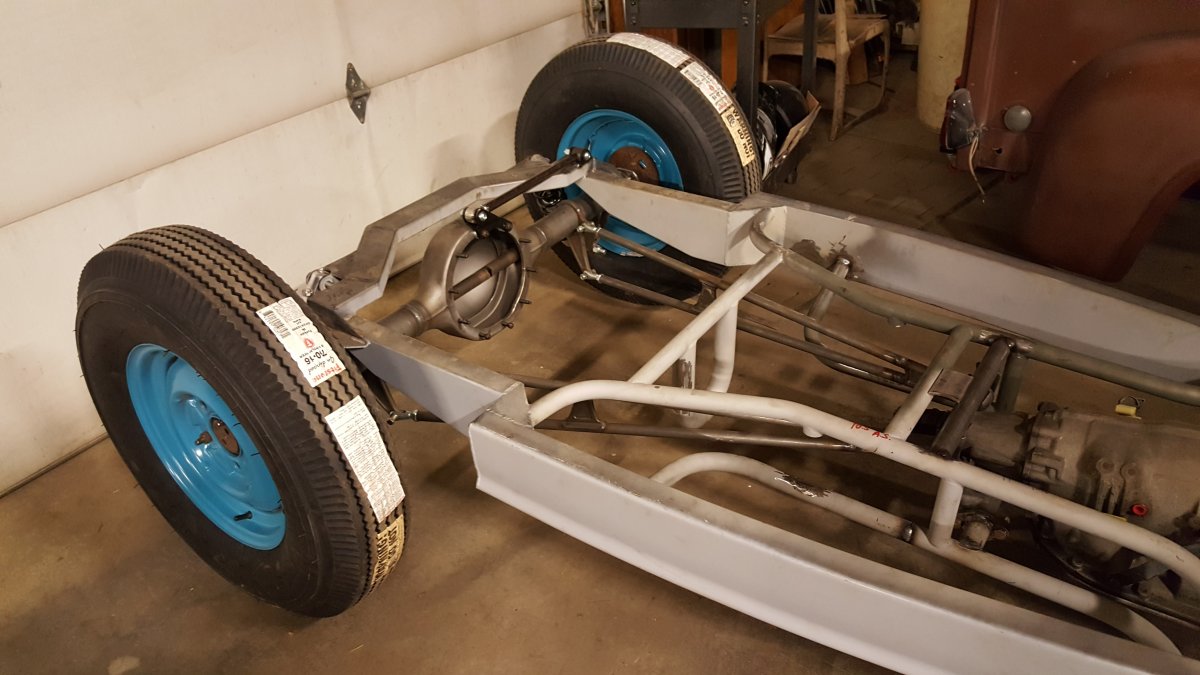

    I tried searching but havent found what im looking for. So.....I have a little over 2.5" of clearance at the frame where it comes over the rearend. How much clearance is needed? And what could I do, I would like to keep it at this ride height.

    Marginal clearance! It will work but you will need a heavy spring rate to control the travel. Probably end up with a rougher ride

    What could you do to improve the situation? Either raise the ride height to allow for reasonable axle travel....or...modify the frame shape/contours (aka 'C' notch for example) to accommodate axle travel at the current ride height. Not much else come to mind if you want to gain/retain a decent ride quality.

    I will have to get a better picture but my frame tapers to nothing after the crossmember. So a notch would have to be 1"-1.5 At the most. How much clearance do I need?

    I see your dilemma. The easiest solution would be to raise the frame in relation to the axle....different spring? Short of that, altering (raising) the frame rail at some point ahead of the axle/spring is about the only alternative that comes to my mind. Which is not to say, the only options, only all that I see. Other may have different suggestions.

    Once the frame is loaded, you may have to install taller or stiffer coil overs to maintain 2.5 inches of ride. Then put snubbers at the axle and frame contact point and you'll be fine. There's a lot of red polyurethane snubbers available in a variety of designs, that have give built into them. I wouldn't worry at all about 2 inches of ride.

    The ladder bars look perilously close to the crossmember - but that might be the camera angle? Have you sat it down without the coilovers fitted to see what the true travel is?

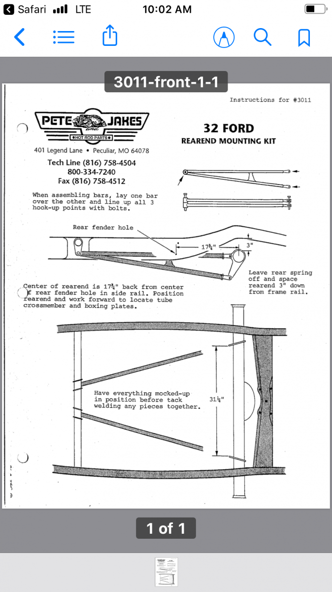

  15. Here ya go.
    Make your setup like the pic and it will all work just fine.
    The front part of your frame is ‘32 but the rear is something else and not like a 32 so it won’t work like a 32 either.
    If I were in your spot, I’d re do the *** end of that frame and make sure the ladder bar doesn’t hit that tube crossmember at full suspension travel. It would be pretty easy to fab up some 32ish tails. It’s more like a model A back there and needs a tardel traditional Z

    Those P&J instruction are what I used except I moved them in on the rear to miss the frame rail, I think its 29" on mine. The first thing to hit is the axle tube everything else has clearance. I should have done a full 32 rail but I like A's at A wheelbase and with this rear crossmember I dont have to do subrail work. It's my first hot rod so I learn as go and with help from you smart MFer's on the HAMB!!!
    Just camera angle, the ladder bars are just inside the frame rail.

    I do have 3 hole shock mount on the rear but would like to keep this ride height. If I gusset or box the 2x3 crossmember to tie in at the upper frame rail and notch the bottom of the frame rail would it be strong enough?

    I think we're at cross purposes. The crossmember I was referring to is the one with the driveline hoop on. There doesn't look to be much ladder bar clearance below that - it's about half way along the ladder bar so would need about half the travel that the axle has. If it's not going to hit then fine, but I bet it's close, and any increased travel made available to the axle (by c notching the rails or whatever) will bring the ladder bars even nearer to said crossmember.

    Car sits nice so I can see why you wouldn't wish to raise the ride height! You just have to make everything else work within those confines. I see subrail modifications in your future!

    The picture looks like the frame rail tapers to from maybe 4 inch to ?? at the area where the crossmember is attached. Looks like the top Coil over mount is very close to the frame rail, this is good. the weak point will be the cross section of the rail tubing at a location on the c notch vertical centerline. Fish plating what is left of the tube after c notching will strengthen the cross section at the c notch area.

    It does not look like there is a place on the rail to put a c notch because the rail tapers from a large cross section to very little cross section above the axel tube.

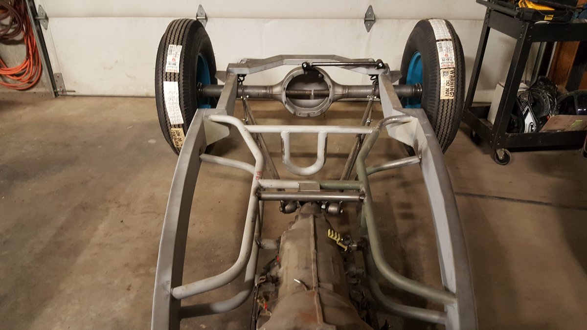

    What about the crossmember? Will the ladder bars hit before the axle tube hits the frame?

    Show us a picture straight down on top of housing and cross member so I can get an idea how much room we have to play with in the cross member to housing clearances.

    Can you eliminate the frame horns and have the frame end just ahead of the rear axle tubes? No frame, no bump!!
    You would have to mount the coilovers in front of the axle, but that just takes a little noggin' time to figure out...

    Can you add a piece of box tubing to each side and C-notch it if you need more clearance...like I drew on your pic?
