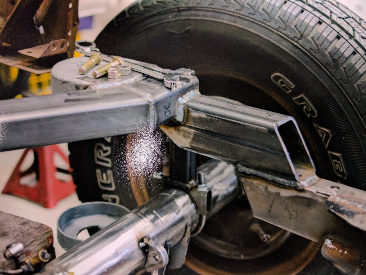

    Similar to guitar's suggestion, raises the rear cross-member for added clearance. Looks like it would entail some sub-rail work. ( FYI the ends of the tube and boxed A frame were filled when completed)

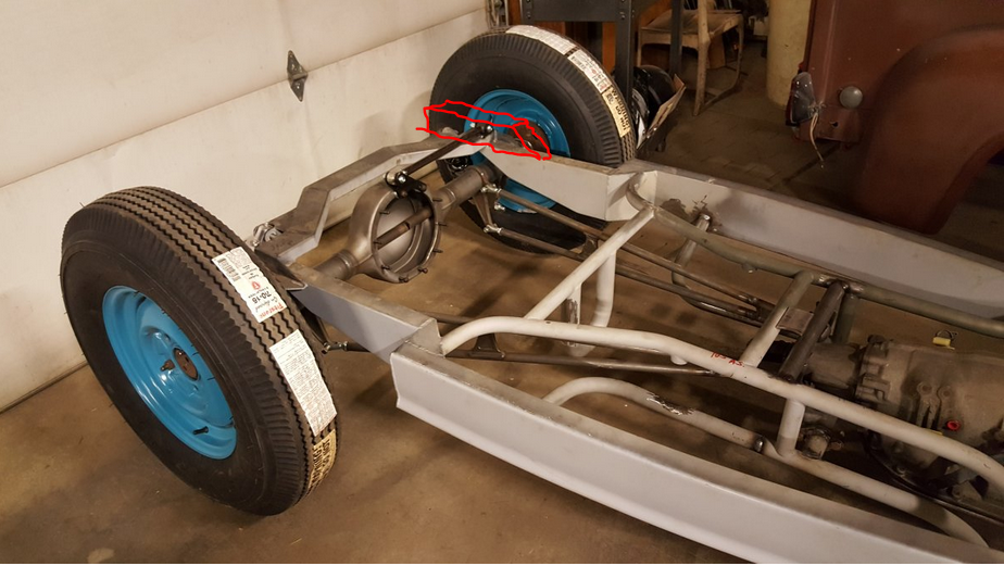

    No, axle tube will hit first and i still have clearance at the driveshaft loop crossmember. If the rear gets notched for clearance plus the 2" for compression it might get close. I will get some better pictures tomorrow
    Model A coupe. And there is a body mount at the rear most framerail.
    This was one idea I had if it would be strong enough?

    I got a deal on the frame, so now I have to work with what I got. Looking back I should have done full 32 rails. With the funny rear crossmember the body goes right on without any modification it just sits really high in the rear. I have a 7.50-16 tire and the wheelwell body line was 4" above the tire. I want it where it is now, just following the top of the tire.
    How it sat before I switched to the lower coilover hole.

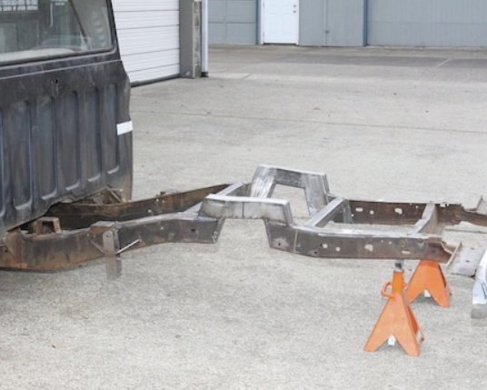

    Yes, it will be plenty strong enough. You have to have overlap of the two rails.

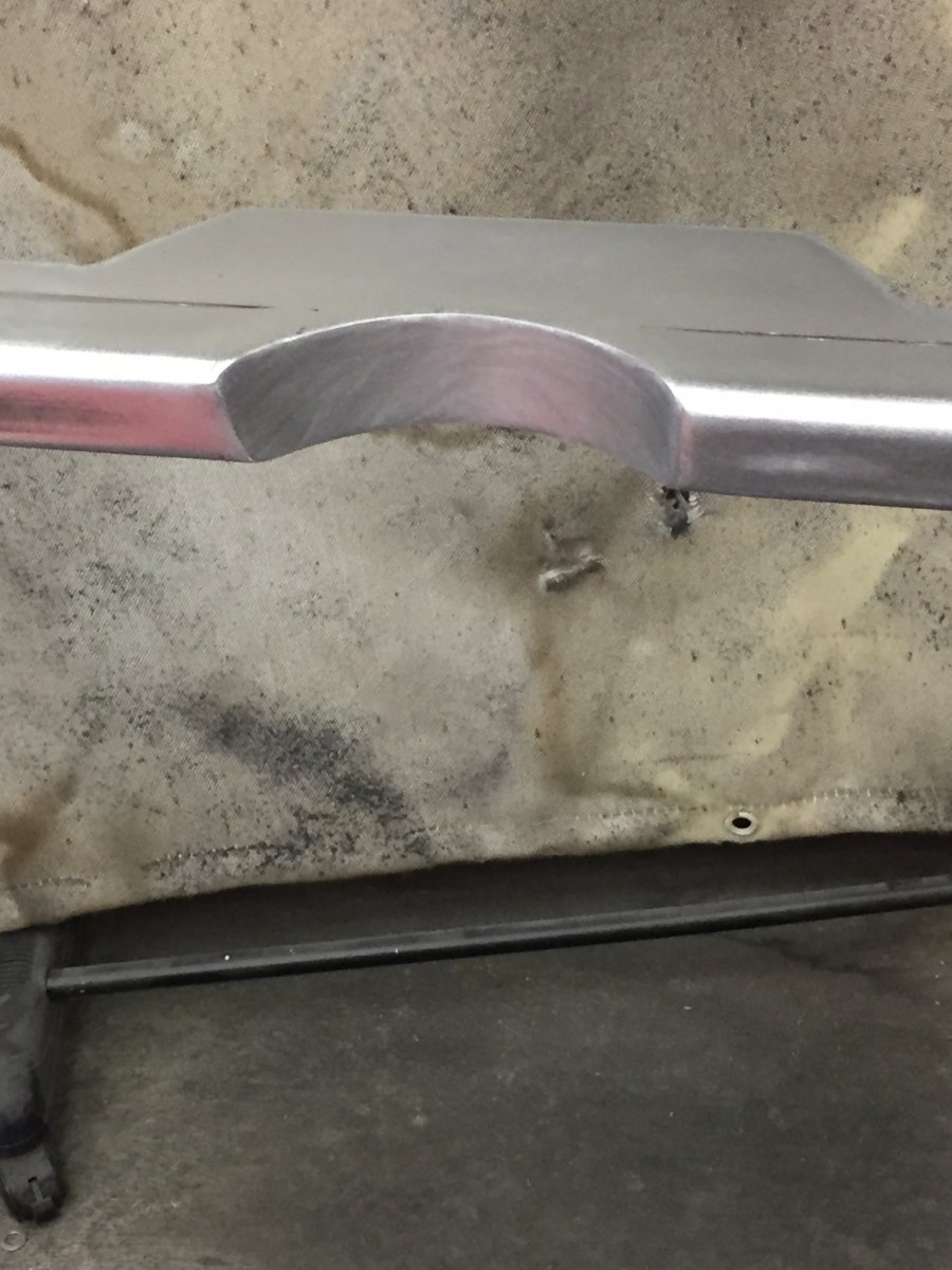

    Rich B's pic I am reposting below is how you would do it. Close in the ends of the box and original frame and weld everything all around. If you need to drop the crossmember to where it was, add another piece of box tubing under the first higher piece you welded in. Effectively creating a C-notch--see the second pic for reference. Yes, you will probably have to make mods to the body to get it to sit back down.
    I know it's not a hot rod, but you get the idea of the C-notch with the front and rear original framing.

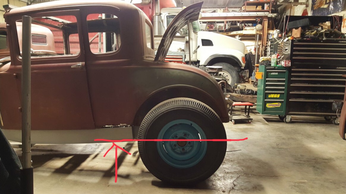

  7. Now you know why you got a deal on it
    That’s your normal high boy stance
    Bottom of frame (lowest line) thru center of wheel. It’s lifted 4x4, ground clearance
    You ain’t stuck with it, just bite the bullet and change it.

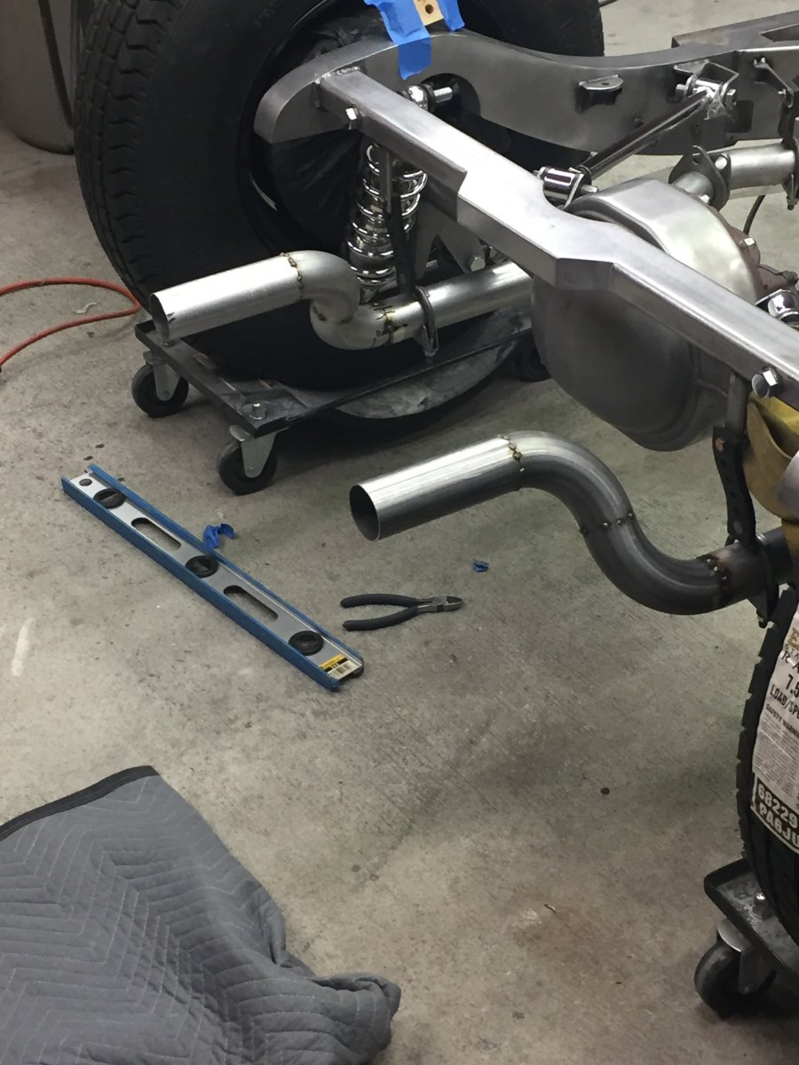

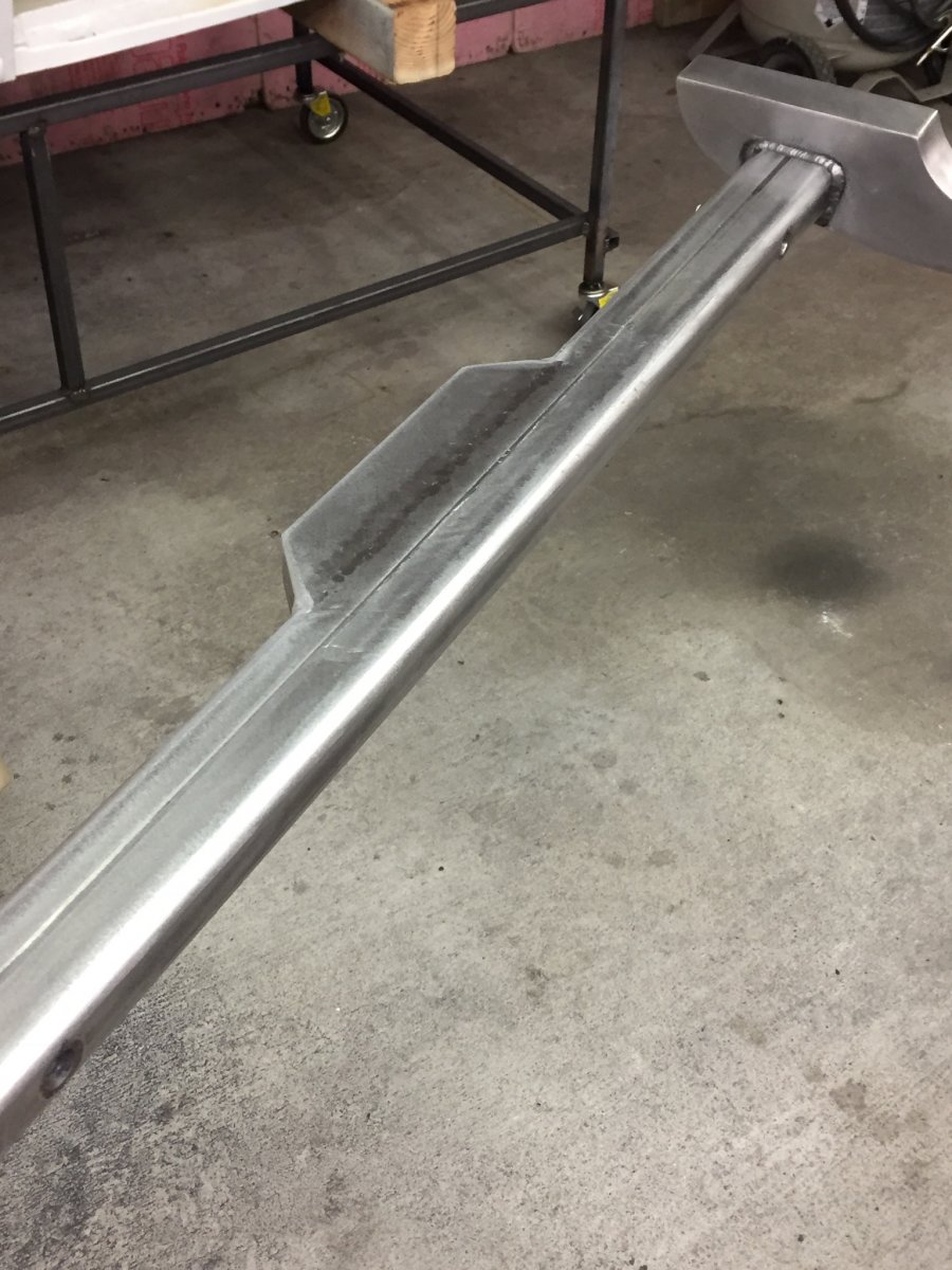

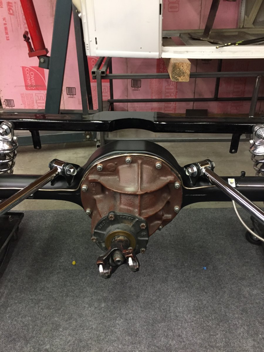

    2BA6A85A-92C6-479E-8377-A36708A8BDCD.jpeg 1E3BD102-ED09-4992-A6F5-AD70ECC16DB9.jpeg 67E297B5-5B3A-4514-92D7-C334E4AA34B7.jpeg 23797AC5-448C-49DC-8E6B-7463C07BA6BC.jpeg This might help, I had a similar problem and C’d the crossmember to provide clearance. Added a piece of same size square tube, then made the cut out.

    Pics out of order:rolleyes:

    I ***ume the appearance of this is due to some front-to rear angling of the C-notch tubing, which makes the two notches look totally mis-aligned.
