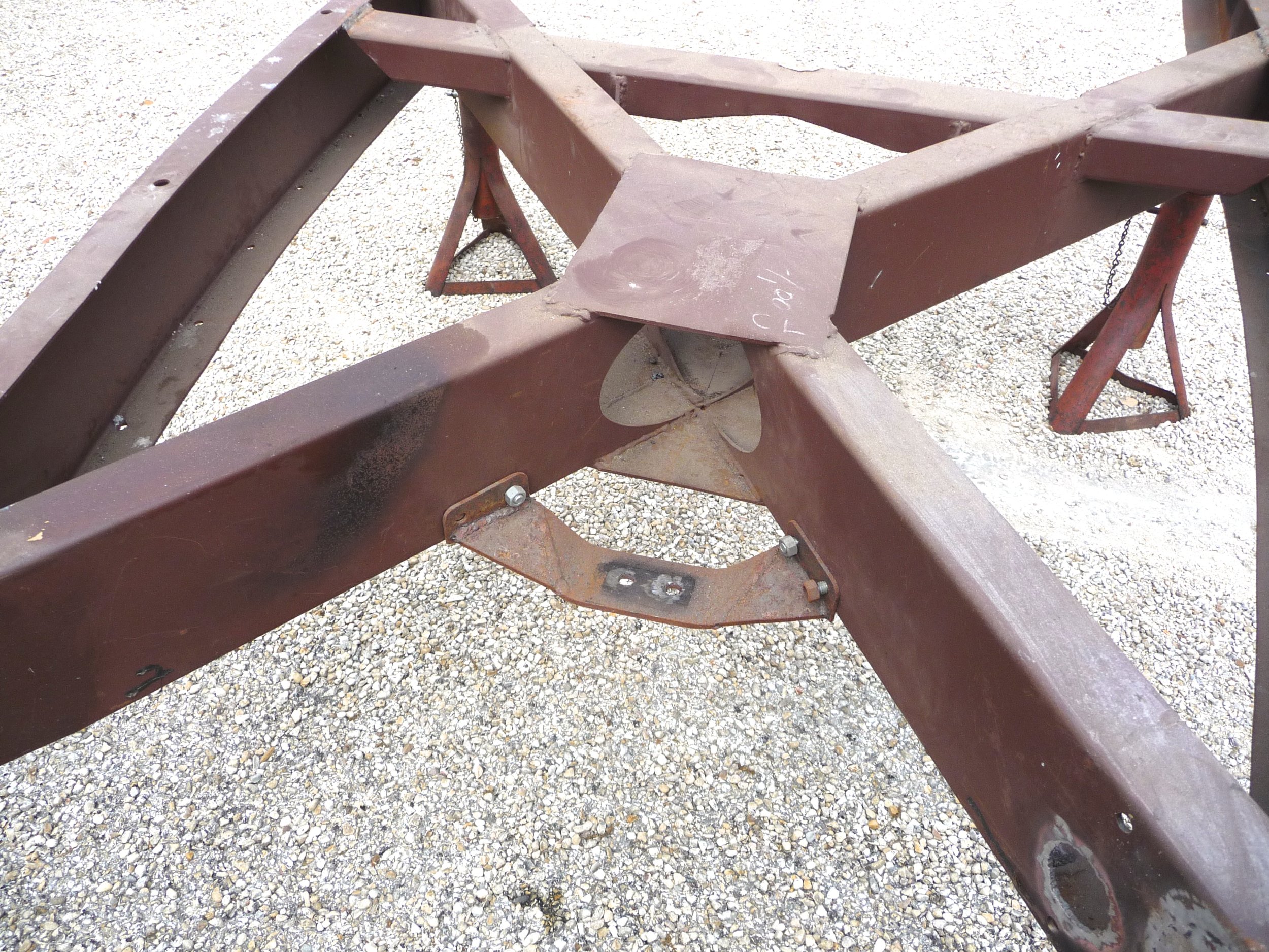

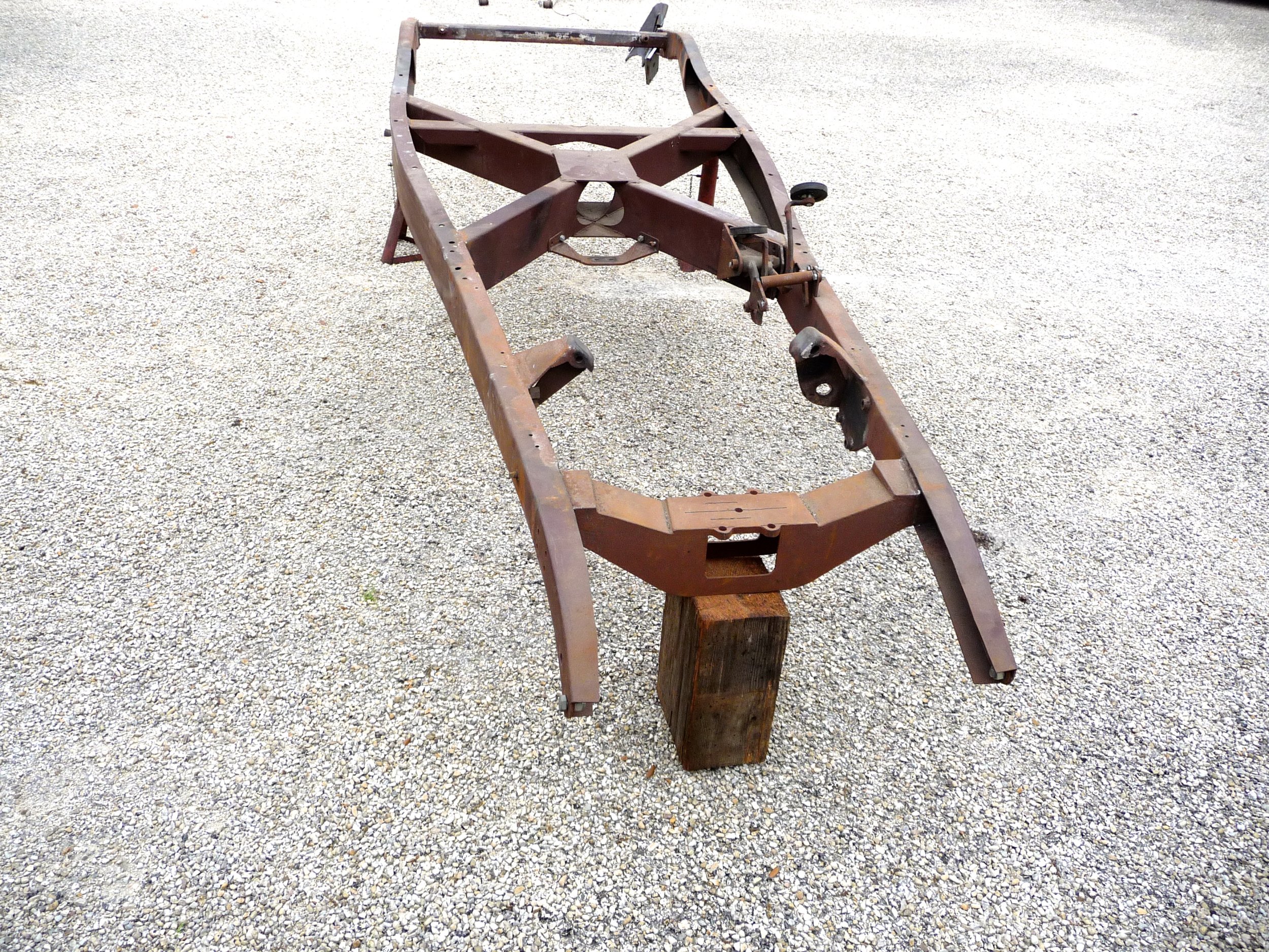

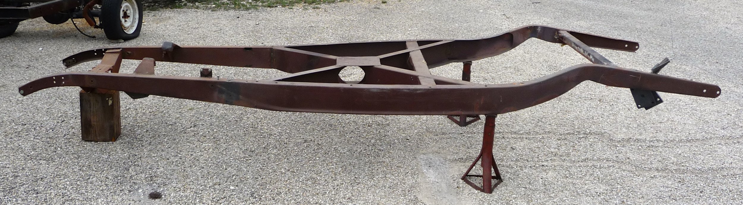

    This is a frame I did. I tested it and it was super stiff. Also cheap and easy. You don't need threaded inserts for the body bolts. A sheet metal shop bent the channels for very little money. It is easy to check the stffness. Just put it up on three supports and put a twist load on it and measure. P1060972.jpeg P1060971.jpeg P1060967.jpeg

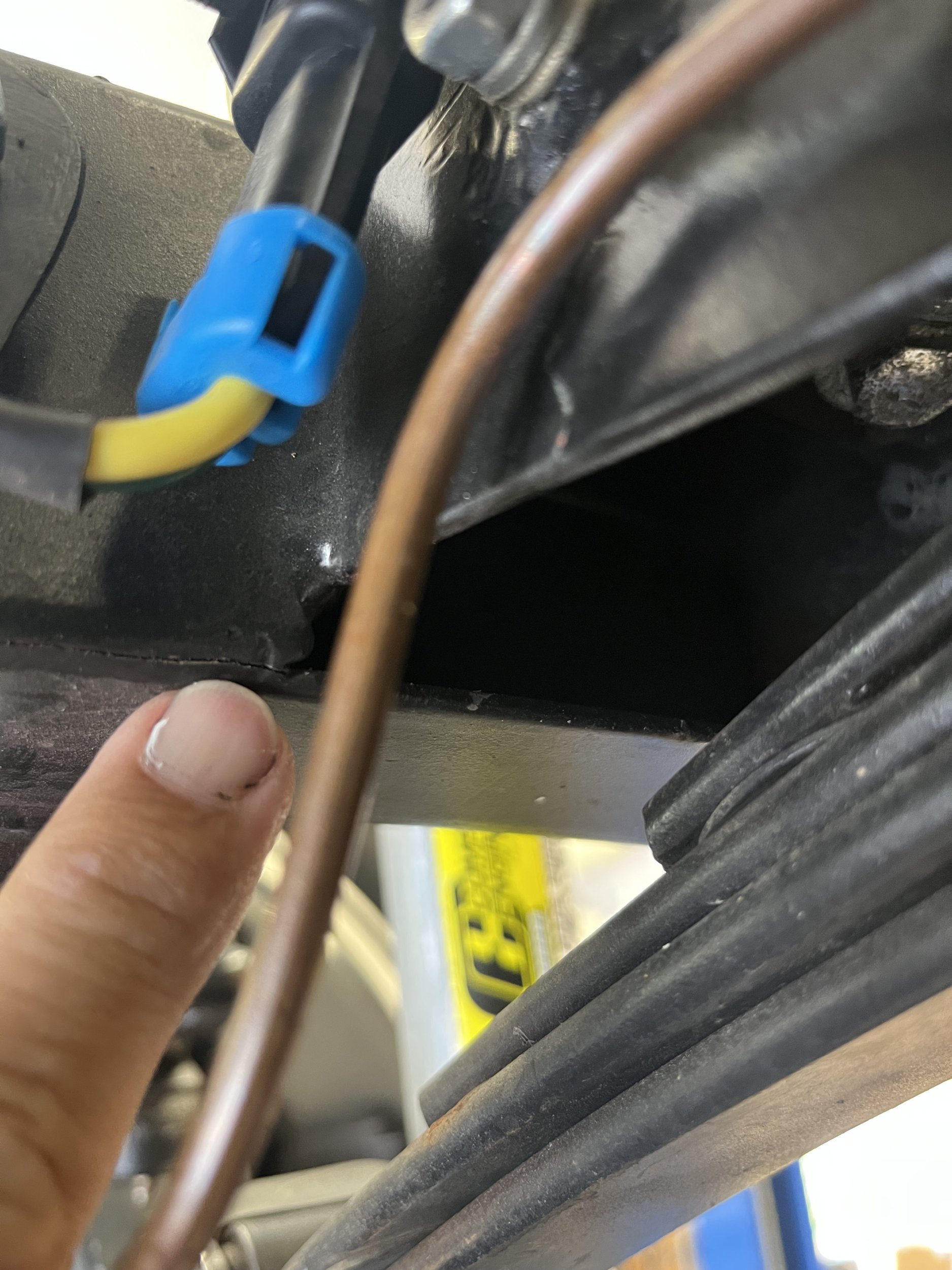

    Sure enough fellas, my frame is cracking where the front crossmember attaches to the boxing plate. I disconnected the shocks and there’s a bit more movement when I bounce up and down on the spreader bar. I’m going to completely remove the shocks and go for a careful drive and report back. Looks like I’ve got some all-nighters ahead!

    Stress concentration?

    Gussets on the back corners of the front crossmember would be a good addition for your high stress application. More like the original Henry crossmember that had a full length horizontal lip on the back of the crossmember.
    Andy’s frame is a great example of tying the center of the X member together. As one corner tries to rise, it will try to shove the opposite corner down. If the center of the X is tied on top and bottom it will keep the two sides from operating separately. It will be better in keeping the whole frame in a singular flat plane. A tube or two underneath don’t have the same strength.

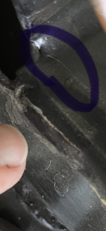

    Hard to tell but is the frame not boxed after the crossmember? If not, for sure it’s a stress concentration area.
    Is this also a crack?

    Yes, it looks like another crack where you indicated. It kinda looks like whoever put this crossmember in the frame thought that welding the back half of the crossmember to the boxing plates and not to bother welding it to the c-channel AND the boxing plates. I took the car for a drive with the shocks removed and there was still a lot of radiator shake over bumps. I’ve torn down the front spring and am working thru removing one or two leafs. I’ve been very proud of how this car has had plenty of clearance between the frame and the suspension. I may have to use up some of that clearance in softening the front suspension. Spring bind doesn’t seem to have been an issue. But, there is a lot of “stiction” before free movement in the plastic shackle bushings. I also likely had them tightened too tight. (I’m gonna get this suspension nice and slick!). But they don’t seem worn. What do you guys grease those with?
