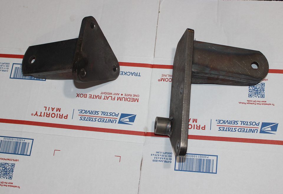

    Made myself? Nothing pretty enough to show on here.
    You have to put your visualization cap on as these are for my 292 in my 48 but could be knocked out in one's home shop with minimum tools for a V8 you just have to cut the angles for the V8 on the piece that runs out from the plate that bolts to the block . This uses a Ford Biscuit mount and a similar tab on the frame. These came from Ch***is engineering inc and were some of the last parts the family sold before Heidts bought the company. Actually I think they were shipped after the company sold. They had them in their close out for 15 dollars and gas to go get the steel and the steel at the place that sells small pieces would be more than that if one doesn't have the metal laying around.
    These photos are looking at the bottom sides of the mounts.
    I saw this on a T bucket back in 2007 and it is simple and clean.

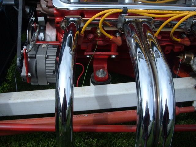

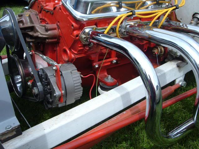

  4. SBC. 51 merc ch***is. Useszfkathead biscuits
