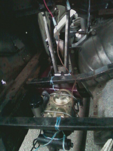

    I'm running a new corvette master cylinder, no booster, front disc brakes and read drums.
    The corvette style master is what you want. I'm running a wildwood master and a hydraulic throughout bearing.
    I pieced together a kit from welderseries.com for my pedal assembly and am very happy with the results. Total cost of assembly was under $ 100. I had to add to the main bracket to accomadate for the clutch master cyclinder
    I can get you part numbers if your interested
