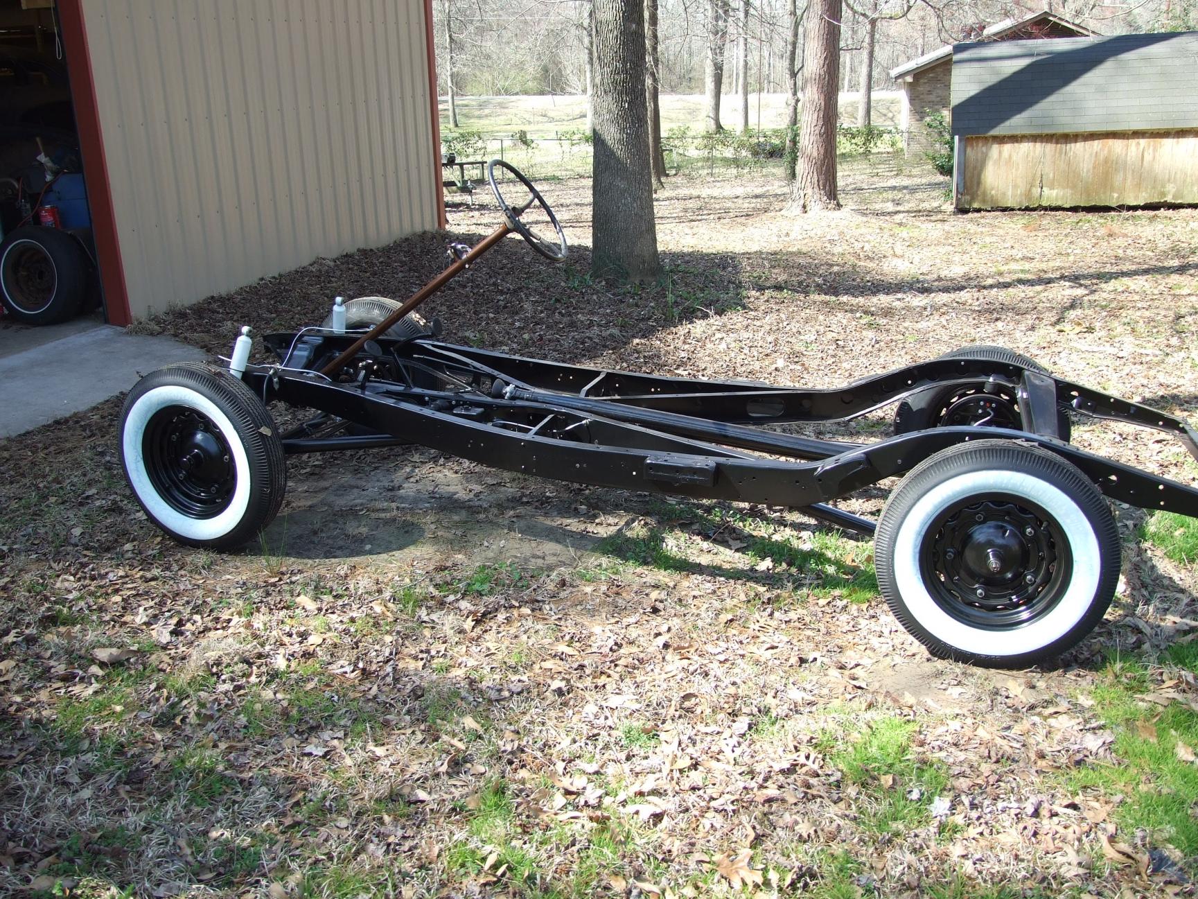

  29. scooterseats
    Joined: Dec 12, 2008
    Posts: 59
    scooterseats
    from East Texas
    I had my '39 frame powder coated. They baked the grease off, sand blasted it, primed it and coated it black (yes baked it twice) all for $175. They used silicone plugs on all holes with threads to prevent messing up the threads. These folks are great. This was at DK Industries in Marshall, Texas.
