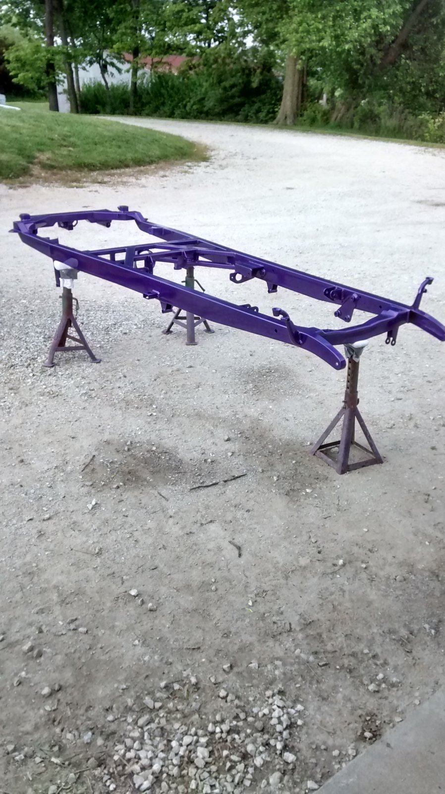

  14. rawcjw19
    Joined: Oct 8, 2012
    Posts: 581
    rawcjw19
    Didn't turn out too bad,but its a channeled high boy. I didn't think I needed to block out the rails and you can see the tube seam. I am going to try to fix the front outside of the rails. Took a little bit of the wind out of my sail.
