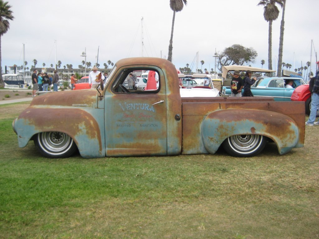

    mine sits really low. I have stock frame with a camaro clip, hopefully this year i can get 4 link install.

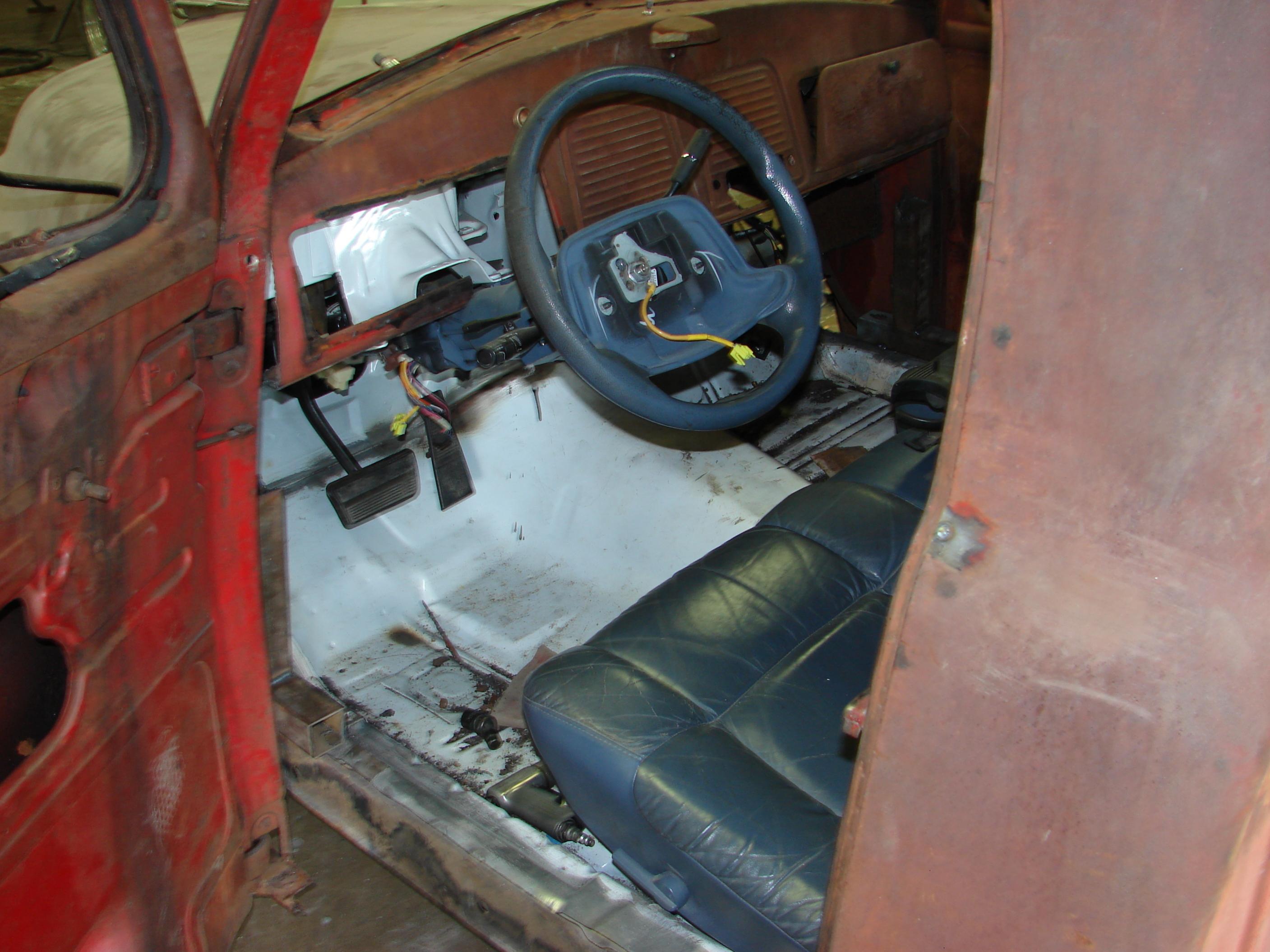

    ha ha, its almost to skiny for the fenders! yes caprice floor, firewall, abs brakes, powersterring, ac/ heater, rides like a grandma's car

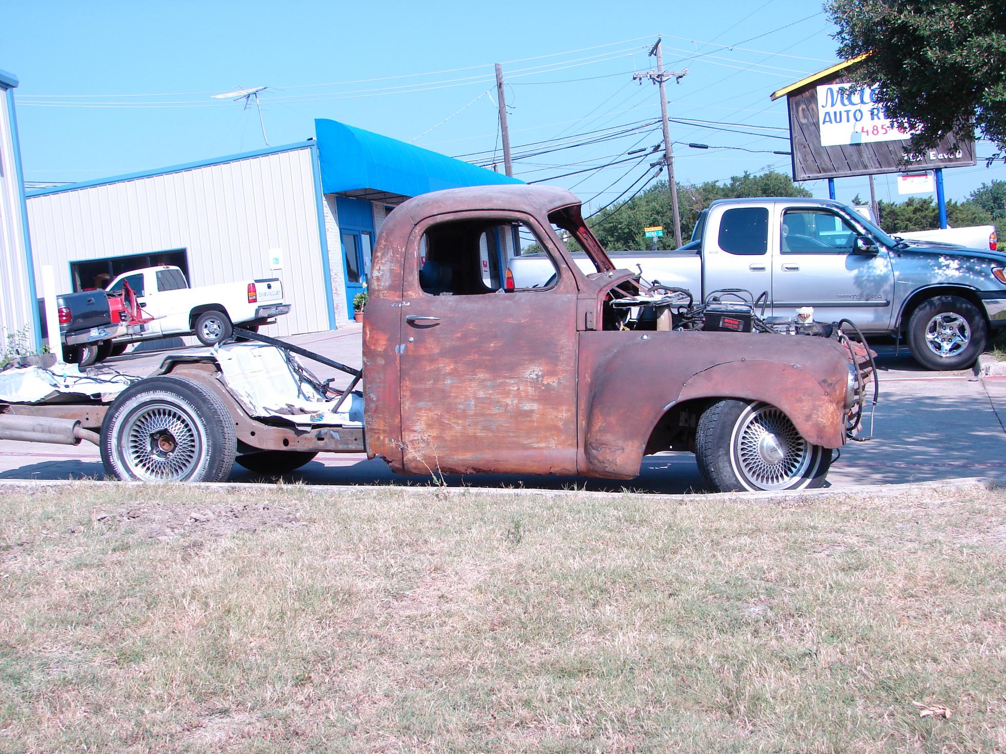

    this one has 79 firebird front and rear
