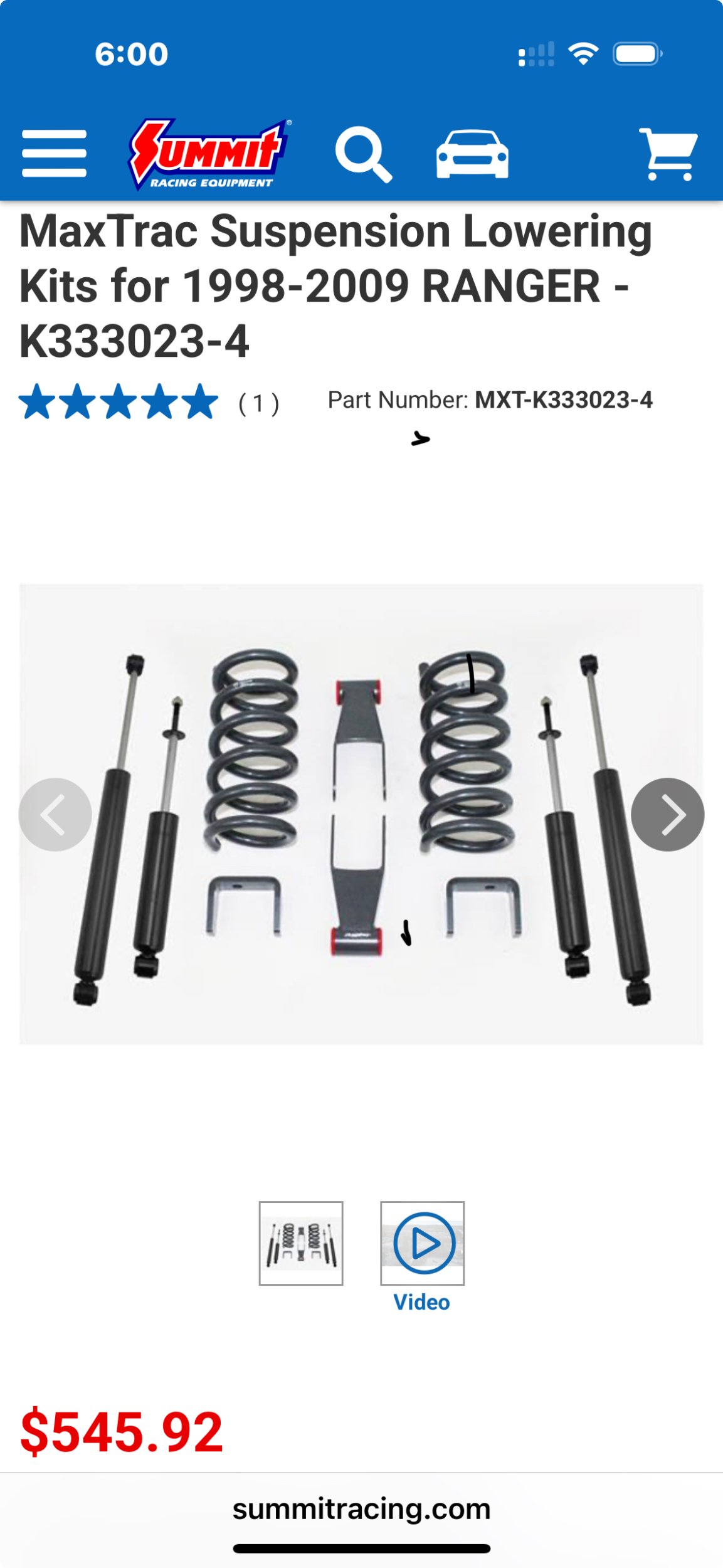

    Quick Google search.

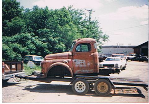

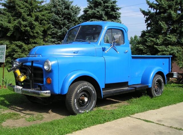

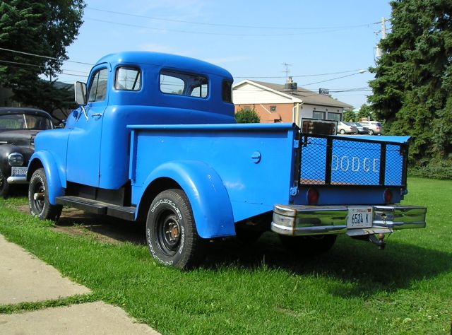

    When I built my 50 Dodge 4x4, I used a cab and front fenders from a 2 ton truck. Those front fenders had fender extensions that bolted into the fender lips to extend outwards to cover the large tires in turns.
    When mounted on to the 1/2 ton 4x4 ch***is, the wheel openings were way to large to look right with the big 15" tires. The only part of the fenders I could use were the top curved part. Then I needed to add a large piece of sheet metal to fill in between the fender top, and the wheel opening. The nice part was I could position the wheel opening any place I needed it to be. The biggest challenge was resizing those fender extensions from the 24" wheels the 2 ton truck had down to the 15" wheels I was using. I still needed the fender extensions to cover the tires when the wheels were turned.
    Obviously, the 50 Dodge truck fenders are not the same shape as the 36-40 Ford fenders, but I'm betting you will still need to gain some width on those front fenders.
    Just for kicks, the front fenders on my 50 Dodge, before and after. 50 Dodge 4x4 045.jpg Before. 50 Dodge 4x4 029.jpg After. From the rounded top of the fender to the very bottom, and from the nose piece to the door edge was the added sheet metal.
    The truck sat up in the air pretty high. The top of that roof was at least 8+ feet off the ground.
    50 Dodge 4x4 030.jpg The ch***is under this truck is a stock 1980 Dodge 1/2 ton 4x4 pickup (including the wheels). Notice how far outward the the fender extensions reach, and where the tires would be with out the fender extensions. Also notice, the rear tires and fenders. This bed is hand fabricated and the bed floor is about 4" wider then the 50 Dodge was, which has moved the fenders outward 2" on each side.
    This 50 Dodge cab is a 3 person wide cab and may be 5'-6" wider then your Ford cab.
