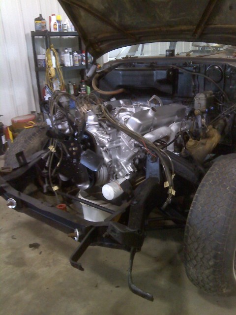

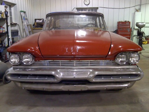

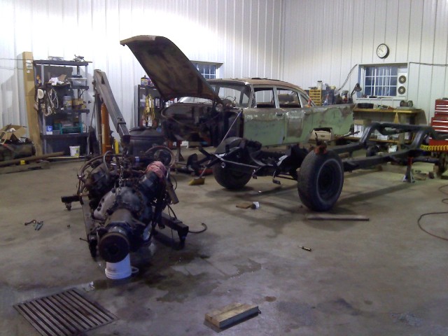

    Just an update. I found another '59 frame that was in much better shape than mine so after treating it with Eastwoods Rust Converter and painting it with their Rust Encapsulator it was ready to go. The body was jacked up and the old frame was pulled out from under it using a small floor jack under the rear diff. The leaf springs had been pretty much removed making it much easier. After the body was back on the new frame the new leaf springs were installed as were KYB shocks. It now has new wheel cylinders on the rear and rebuilt on the front along with new brake lines. IF these don't cut the mustard, I plan to upgrade to disc brakes in the front and a later Chrysler rear to get rid of the tapered axles. *phew* Now, I am working from front to back putting it together and still need to get the metal for the trunk, tailpanel and driver's side quarter panel.
    The moral of the story is: I used just basic hand tools and the swapping of the frame, body and engine went just fine. Like some of you said, nothing fits better than the original part. Thanks again for all the advice.

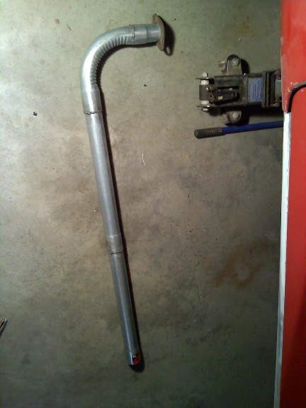

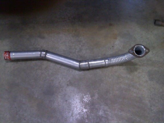

    And working on an exhaust:
    Only a million more things to go :rolleyes:!
