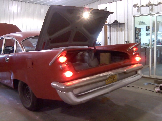

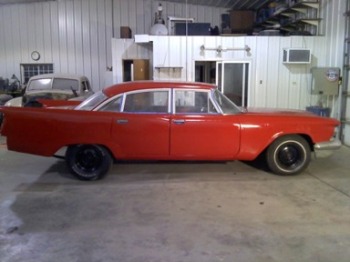

    It's finally on the road!!
    I have built my own exhaust to the mufflers (Cherry Bombs),
    have wet sanded the thing like 19 times
    mounted seat belts, and used the rest of my money for a new intake and carb
    Also, all the taillight sockets were changed for new ones

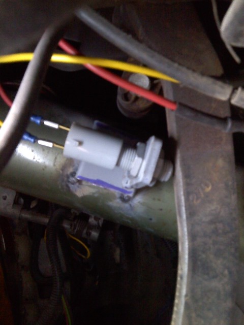

    and the brake light was switched to an electromechanical one under the dash
    The next area to learn on will be the interior. My girls want a "fuzzy" (hairy) headliner :) And yes, they still want flames...thanks for all the encouragement, I appreciate it!
    Lisa -
    GREAT work! I'm impressed!
    BTW, where did you get the brake light switch, and what's the part #? I ask because I'd like to do the same conversion on my Galaxie.
    Thanks...

    Pimpin37zephyr
    Ditto here what is the number for the switch Lisa, I have a 59 Desoto Firedome sportsman with a bad brake switch and would like to fix it like yours. I've read your entire thread. The student becomes the master. Nice job!

    Thanks guys! I keep trying things I haven't done before after reading the posts here, you all are very inspiring. The part number for the brake light switch appears to be SLS62. It also has GP Sorensen and Standard Motor Products, Inc. on the box It was originally purchased for my OT '78 Jeep CJ :eek:
