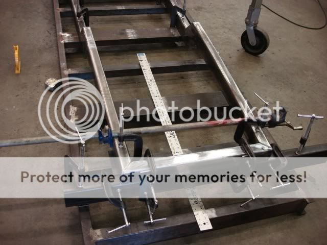

    When my Son Dan built ours years ago he made it from some heavy steel channel and made it so we can prop it up against a wall when not in use. We didn't want a 4 x 8 table taking up valuable floor space when we might only use it every two to 3 years.
    This is the one he made, and it has served us well. Probably 7 or 8 frames have been made on it and all we do is clamp the frame pieces down with C clamps every so often and things can't move. Not the fanciest one around, but it works.
