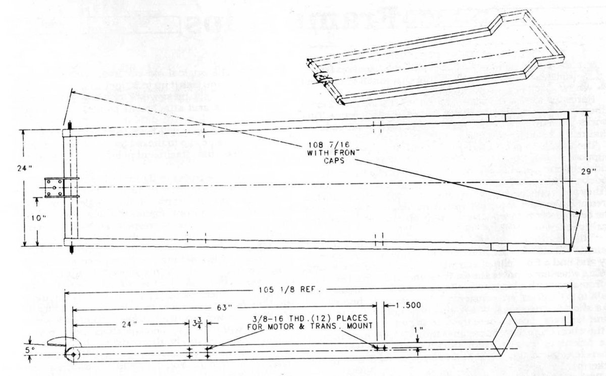

    The download shows how to build a frame, and how to set up the front suspension using parts that are no longer available, and says zero about how to mount the engine, etc.
    Usually when starting a complex project like building a car, it's a great idea to have a plan for how to do the whole thing. Especially before you spend money and time building one part of it, with no plan for how to attach all the other parts.
    But as for how to build the car with the frame you have...you might want to take a look at pictures of various T buckets on the internet, and see where the engine usually sits, relative to the frame. You might find that it sits up pretty high, and the starter and pump might actually sit above the frame, and the motor mounts would also sit up kind of high.
    this pic is in the download....although it may not use the frame in question!

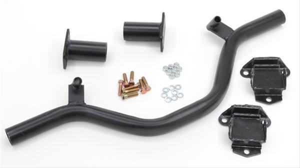

    Kevin you should be OK with that width. If you built the frame you can build side mount also. But a lot of companies offer weld ons like this;
    Trans-Dapt 4100 Engine Swap Motor Mount Kit
    I prefer side mounts in my builds, the Transdapt is the simplest but I tend to do things the hard way and would use stock Chevy motor mounts (pick a car say 69 Camaro) and make up my steel brackets to weld to ch***is. You can adjust side to side and up or down of engine with all accessories on it. Also you should let us know where you are from there may be someone around that can help.

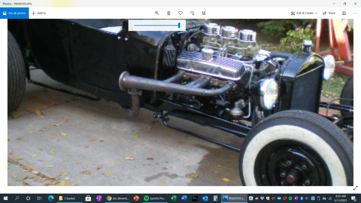

    I measured an old 283 I have on a stand and the fuel pump is about 11" out from the center; but you may be OK. Here's a pic of the last T I made and the pump is above the frame rails.
    The front of this frame is 20" inside like usual; but the back is 26" inside also as usual with frames I build.
    I may be putting a starter on the 283 later today if I get to it and could get you a measurement of the width there.

    Engine's are usually higher in t frames than model as or later cars

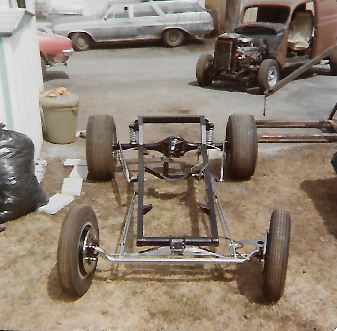

    This picture of another old T I built shows how high the frame mounts (used with stock side mounts) sit above the rails.
