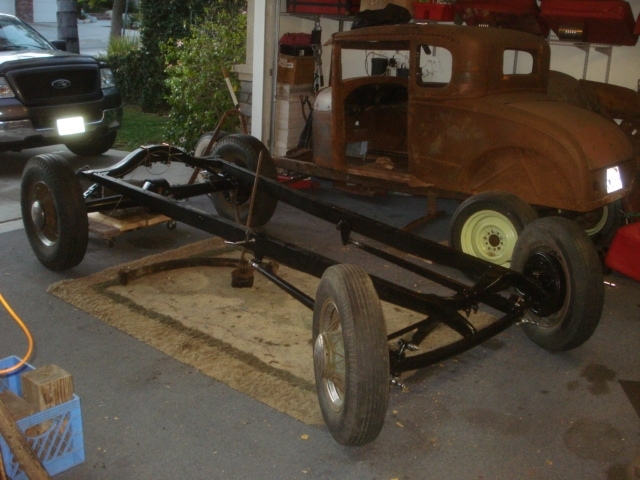

  2. gilby's garage
    Joined: Oct 12, 2011
    Posts: 380
    gilby's garage
    how about this one...

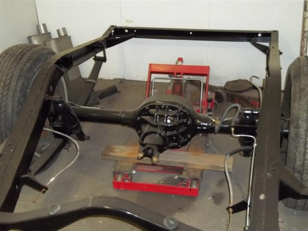

  9. Martin_F
    Joined: Mar 3, 2008
    Posts: 2,527
    Martin_F
    Semi-Gloss Rattle Can.
    Looks better in the pictures. But they always do, right?

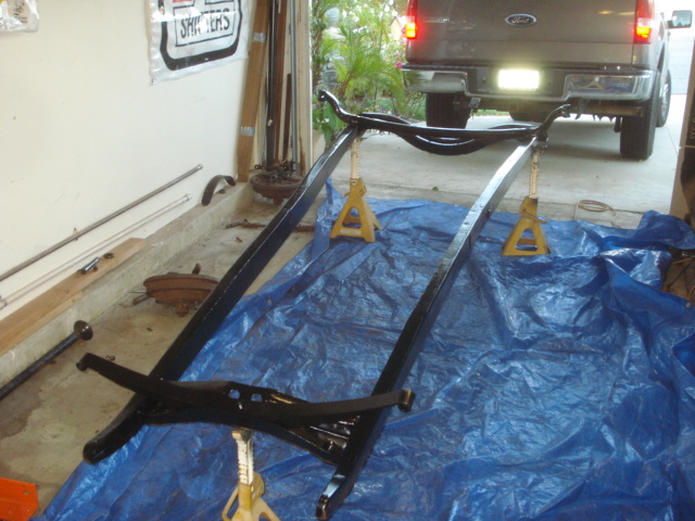

  20. Fat47
    Joined: Nov 10, 2007
    Posts: 1,600
    Fat47
    I just finished the floorboards in my 60 wagon. Used Rustoleum and it turned out great. I had been using POR 15, but this was much cheaper, flowed on well with a brush and foam applicator and hardened overnight. For around $25 at Menard's (midwest version of Lowe's or Home Depot) I got a qt of rusty metal primer, a quart of gloss color and a pint of rust converter (basically Phospheric acid). I had patched the bad spots in the floor board, used a couple of aftermarket back seat floor pans and wire wheeled the solid but surface rusty spots. Brushed on the rust converter, let it work over night. Next day brushed on a coat of the red primer. Next night gave it a second coat of primer. The few brush marks that were visable from the first coat disappeared. Third night bushed on a coat of Rustoleum gloss color (Menards carried about a dozen different colors and they will mix any color on their color chart). I wasn't quite satisfied with the coverage of the color, so I used a disposable foam brush for the second coat of color. Excellent rusults. So, for under $30, including paint and disposable brushes and foam pads I did the whole floor boars in a wagon and I have over 1/2 of the paint and rust converter left.
    Like "Hotrodprimer" , I wouldn't hesitate to use this method ,and paint, on a frame and I would brush it on. Given the cost of thinner for the paint, the time to clean the gun, ***uming you have one that will spray it, and the possibility of overspray or time to make sure nothing gets the overspray, the brush technique is way more time and cost effective.
