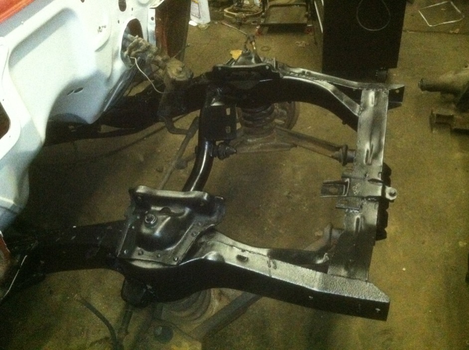

    Put on with a brush. 20180414_115505.jpg 20180414_115505.jpg 20180414_115549.jpg
    bymanr and Tim like this.
  25. Tim
    Joined: Mar 2, 2001
    Posts: 20,827
    Tim
    from KCMO
    @chop job how many coats? Did you thin it? Looks fantastic
    chop job likes this.
  26. chop job
    Joined: Feb 16, 2013
    Posts: 596
    chop job
    from Wisconsin
    One coat epoxy and two coats satin black and no thining.
    Tim likes this.

    Looks good. You may catch it for that rack and pinion shot though! LOL
    Whereabouts in our great land are you?
