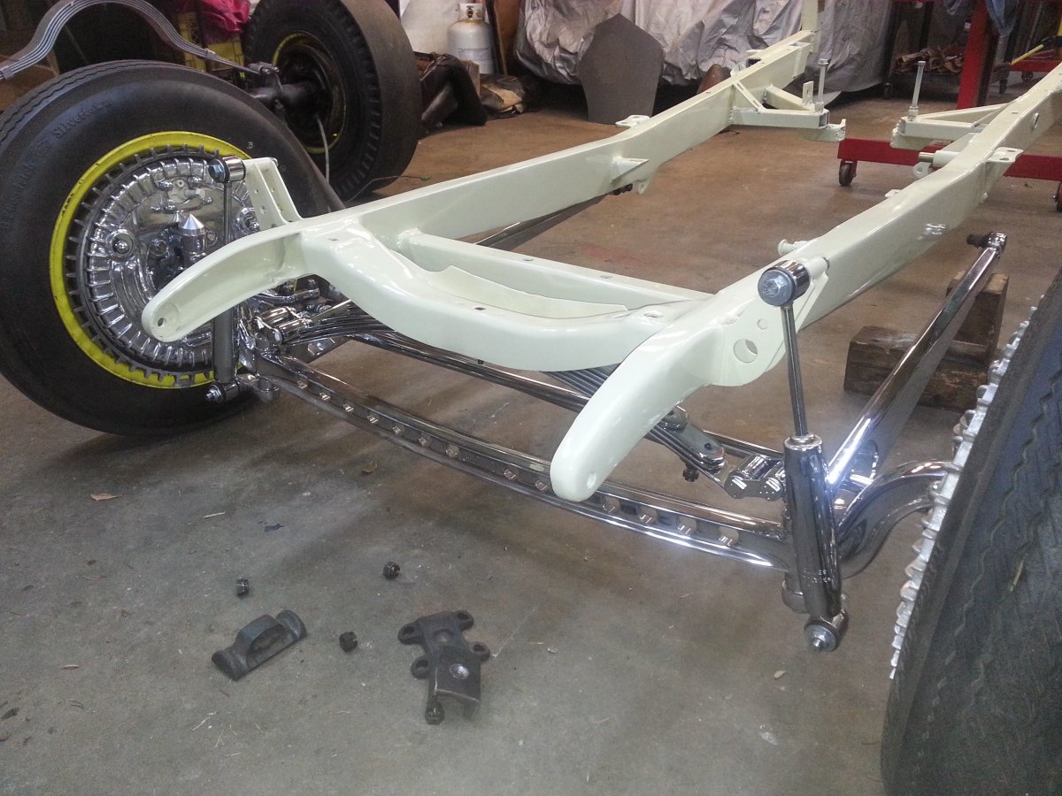

  2. Here's one I did.
    mcsfabrication and Tim like this.

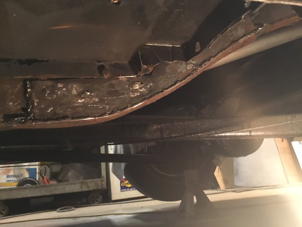

  3. Did this one with a brush
