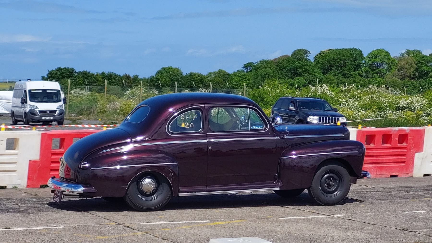

    Imported my ‘46 Super Deluxe into the UK from Connecticut, been working on the rear end and drive train. But now it’s time to lower the nose.
    But by all that’s holy what the hell is this lash up? I know the previous owner used it as a tail dragger, no maybe to keep the nose up when dropping the rear? IMG_0271.jpeg IMG_0465.jpeg
