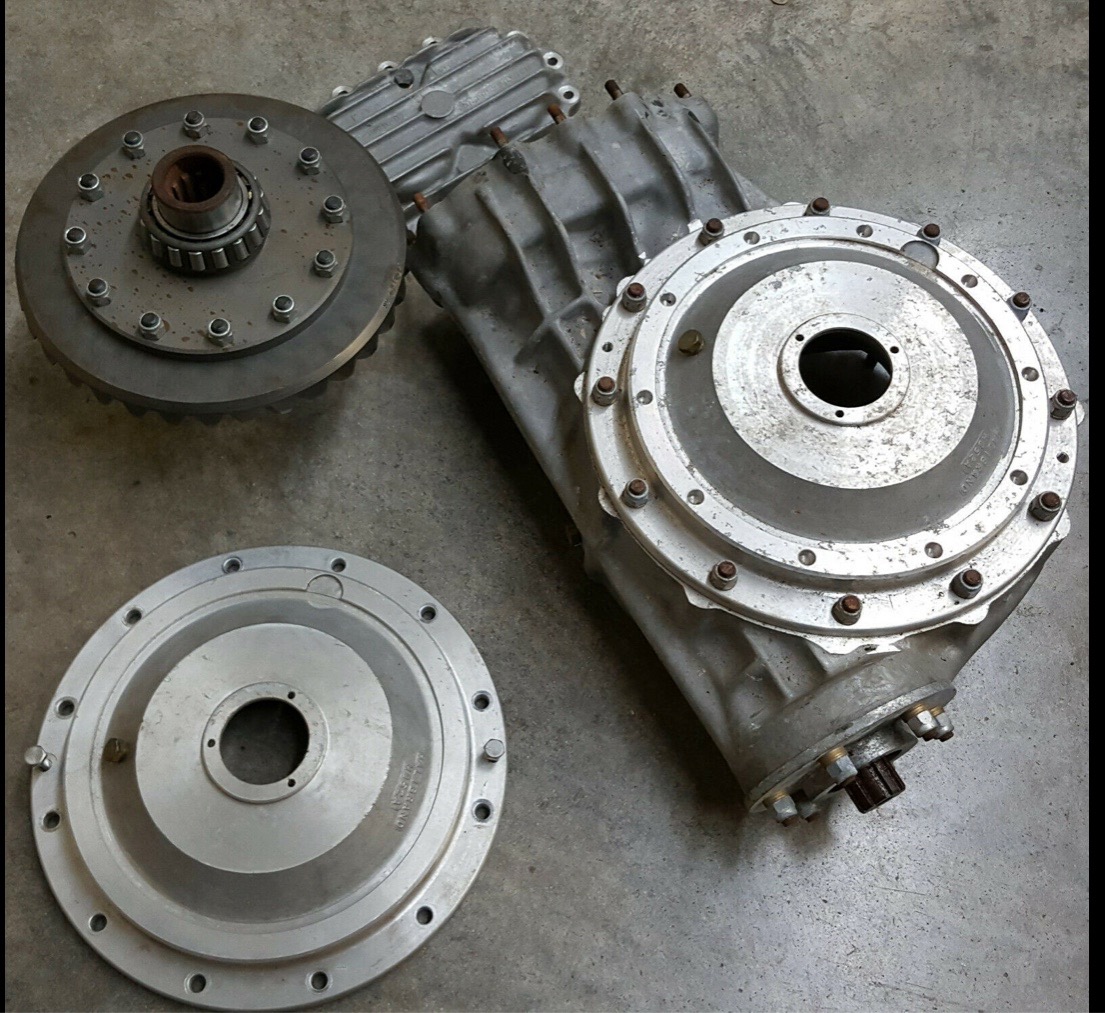

    I believe all v8 Ford banjo bells require an adapter to use with the Champ style Quickchange. Winters makes and adapter as does Quickchange Exchange here on the HAMB. He is in MI. I would search for a Halibrand 201 or 301 rather than the Franklin. It doesn't matter what the center section was used for as you can use the housing in any application.
    Winters Plate.jpg 126800998_10223734387932887_8415496376429152551_n.jpg Image 12-28-20 at 10.22 AM (1).jpg

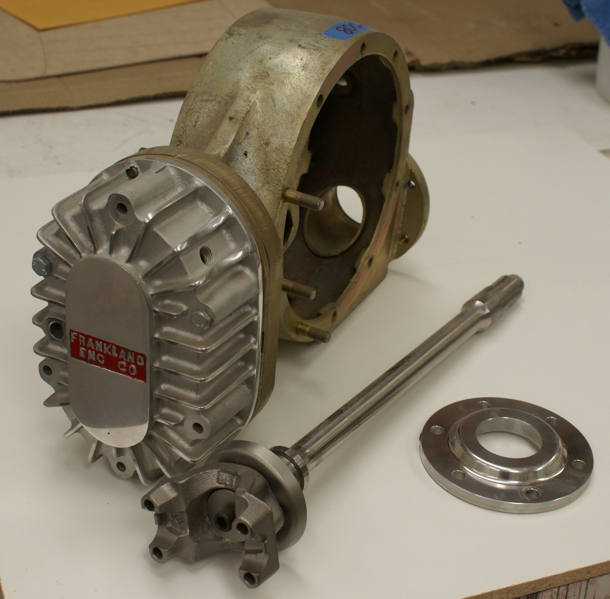

  4. Blake 27
    Joined: Apr 10, 2016
    Posts: 1,554
    Blake 27

  5. GearheadsQCE
    Joined: Mar 23, 2011
    Posts: 3,669
    GearheadsQCE
    Alliance Vendor
    As Blake 27 showed above Frankland did indeed make a V8 based rear end. I'm not sure of the time frame, but they were early. As far as I know, they were welded units made from Ford banjos.
    Pewsplace is also correct in saying that there were no direct bolt up bells from the large truck based rears to the p***enger car trumpets. Winters adapter plates as shown in his first picture, fit 11 bolt center sections. Not easily adaptable unless you use a specific Winters differential.
    Halibrand made the adapter plates in both 11 and 12 bolt 3/4 ton center sections. Halibrand made centers in both 11 and 12 bolt. My reproduction plates are also available in both configurations.
    Frankland 3/4 ton center sections are all 11 bolt just like the original Ford truck. (although I seem to remember that Frankland did make some 12 bolt bells to fit other manufacturers centers).
    The downside of the adapter side plates is that they will only work with narrowed differentials, and only certain differentials can be narrowed. The Frankland (and most other current centers) are 3 3/4" wide while the Halibrand and a few older designs are 4 3/8" wide. This means that you have to cut the differential more to use the narrower centers.
