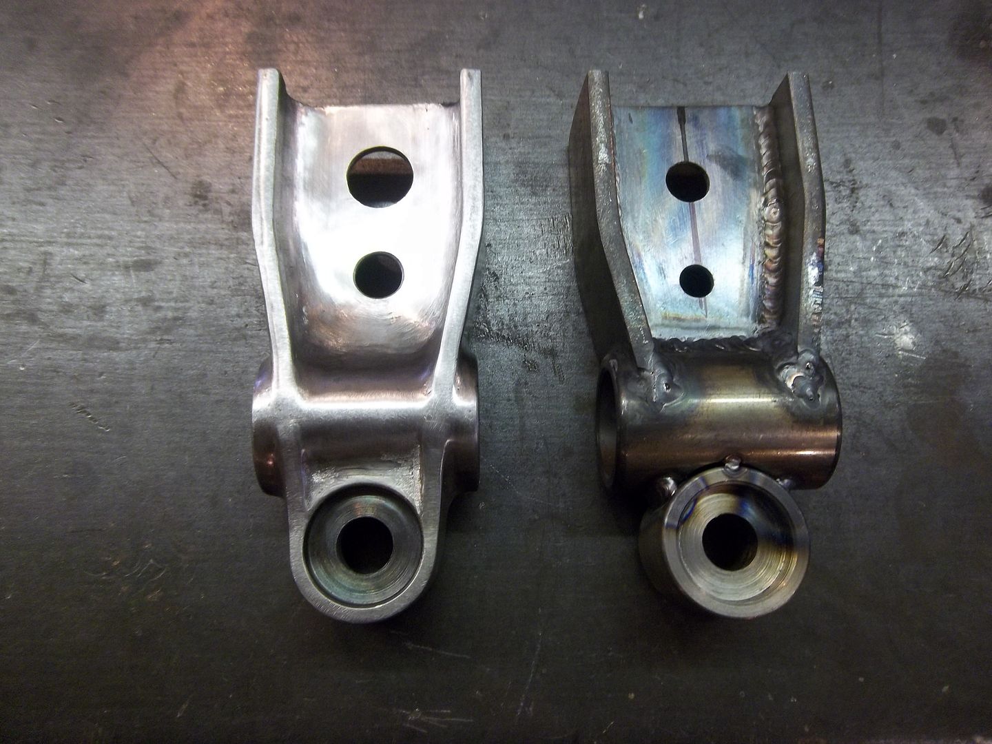

    The next logical move was for me to make the front bushing ends for the ladder bars. I couldn't find a bushing kit that would fit the 3/4 bolt I am using for the bar mount, so I had to make some. Something I've never done.
    I bought some 1 3/4 OD seamless tubing and a couple pieces of UHMW plastic.
    I cut the steel pieces, trued them to the right width, and turned the inside of them out on the lathe until they had a wall thickness of 3/16. I then chucked up a piece of the UHMW and turned it to the right diameter (2 1/8 was all was in stock). I used a blunt shaped cutting tool for this and ramped the lathe speed up to about 1400 rpm.
    Once I worked the pieces to fit the way I wanted them, I made some steel sleeves by boring out a couple small pieces of the 1 inch OD tap tube s**** that we are making the ladder bars from. I drilled 2 small grease holes in the sleeve and tapped the bar end for a zerk. The bushings don't totally touch in the middle, which allows for a p***age for the grease. The two 1/8 inch holes in the sleeve grease the bolt. It's simple and it works.
