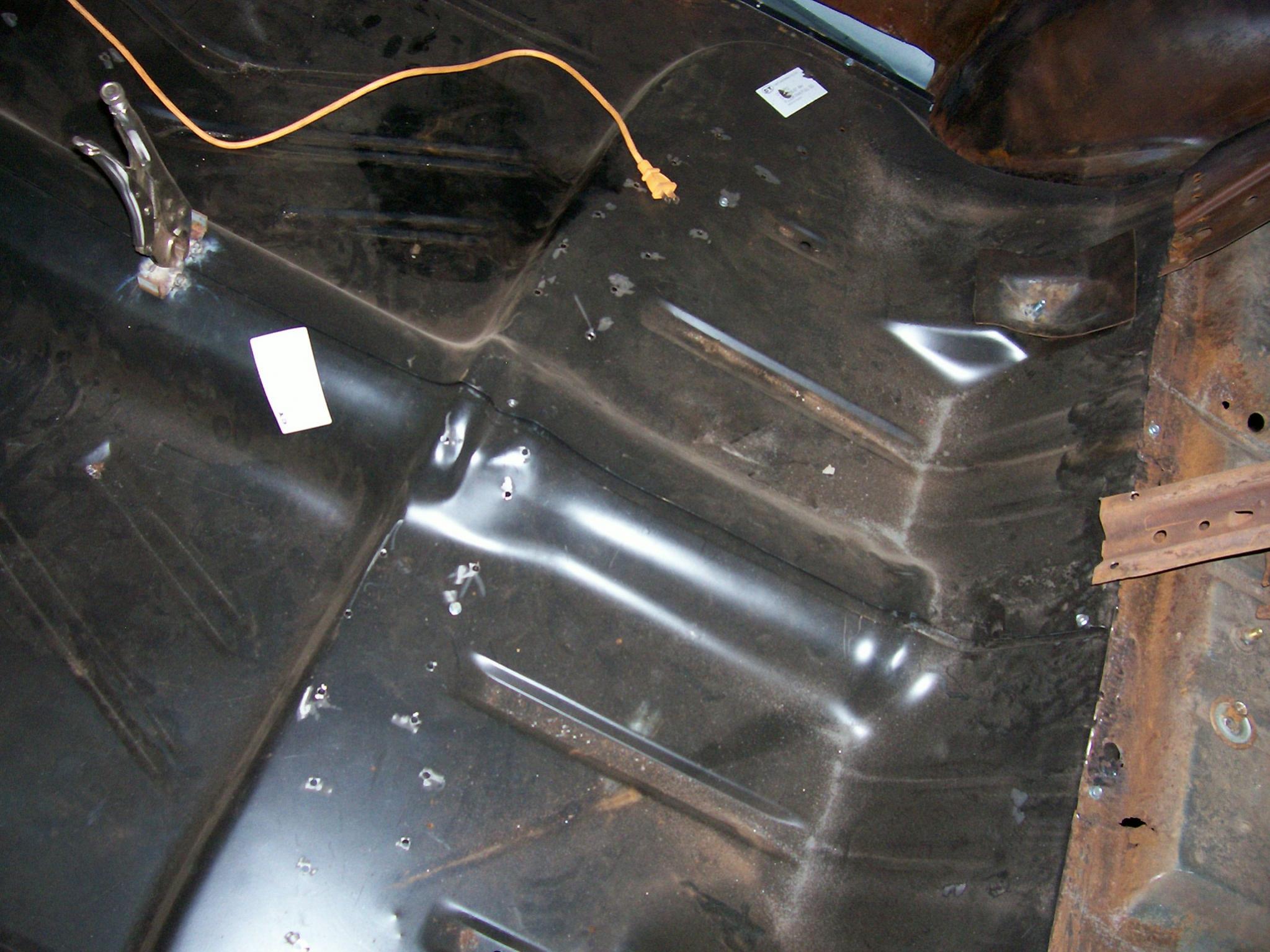

    Not final welded yet but some progress.

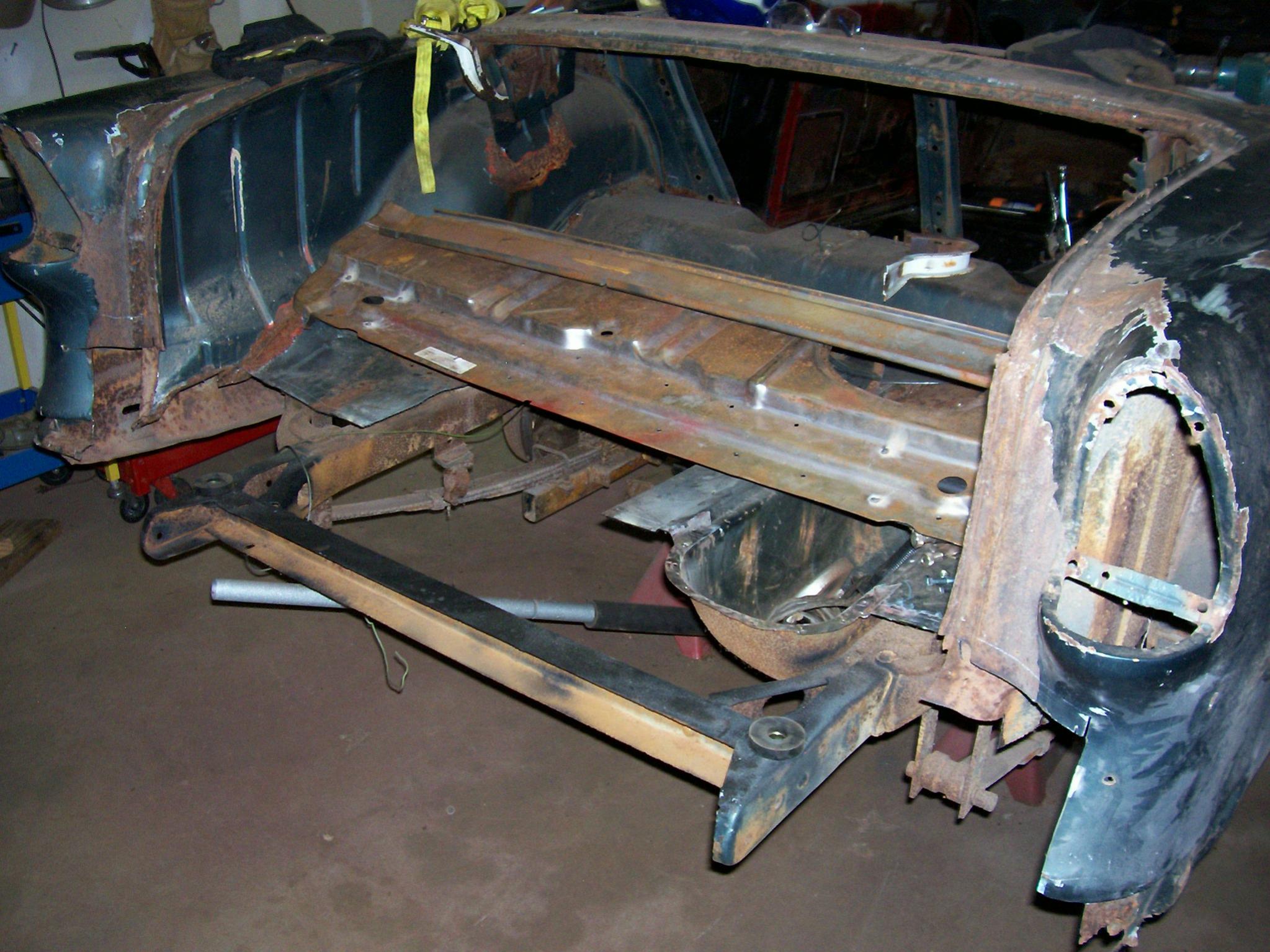

    Started on the trunk

  18. Have you checked the frame for straight? How did the body/frame mounts look?
    A hit that hard my have moved something you haven't found yet, and you are about to put floors in. Good for you saving a POS no one else wants. That's how you learn.
  19. chopped
    Joined: Dec 9, 2004
    Posts: 2,153
    chopped
    The frame is in good condition, did replace half the floor braces. Body has some small kinks in the rear, nothing serious. It's an old car, has some old age flaws but so does it's owner.
