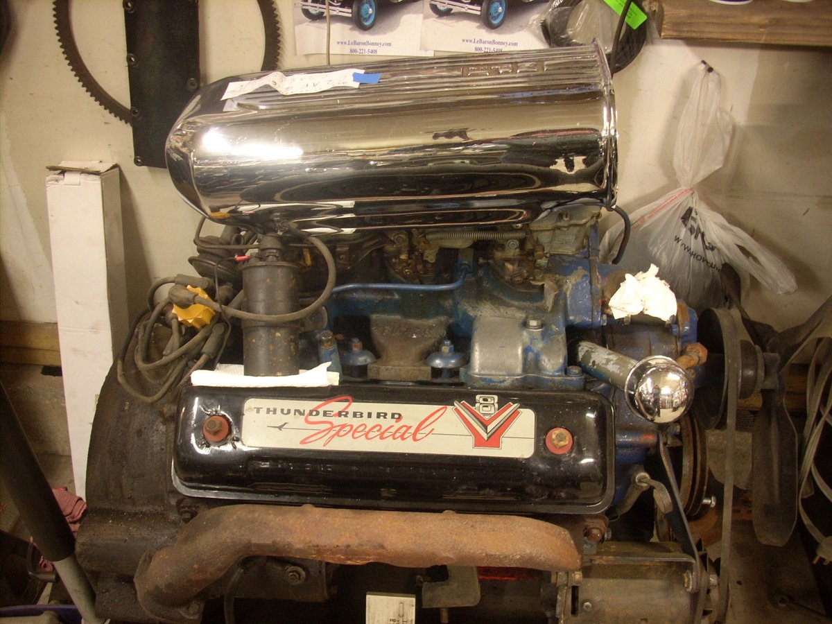

    Nice score , lots of interest in flathead mopars , they're just cool....Hamber just scored one from me...a 25 incher..... image.jpg Got a 1950 Plymouth 6 available , rebuilt for reasonable offer ..Mac

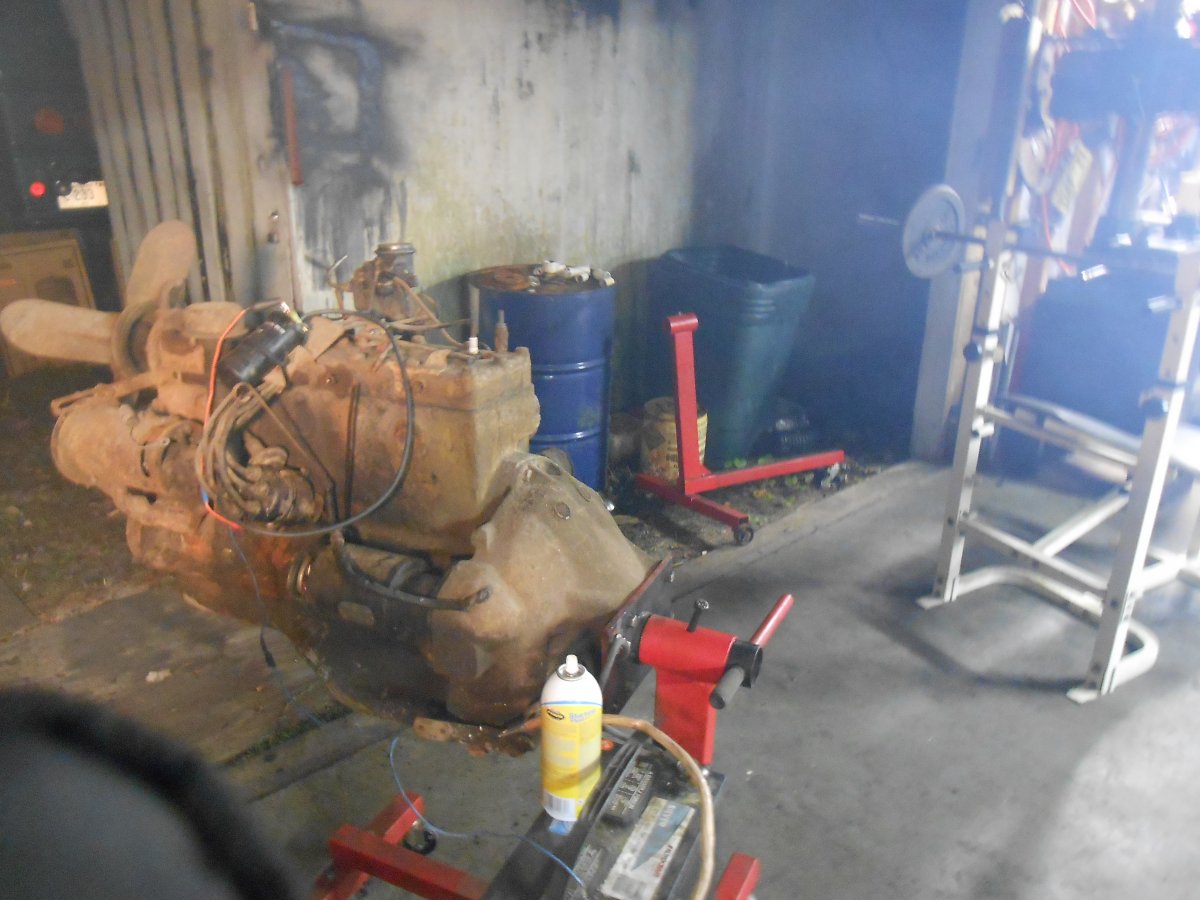

  20. steinauge
    Joined: Feb 28, 2014
    Posts: 1,507
    steinauge
    from 1960
    I got the engine to run today.Not well,it has a couple of sticky exh valves,pretty typical of a flathead that sat a long time.Has oil pressure and no bad noises.All I really had to do was clean and set the points and hang a coil on it.I did have to fix the starter,the C clip that retains the starter clutch lower thrust washer had fallen apart.Replaced it with a modified H.D mainshaft 3rd gear snap ring,seems to work.I cant do video,but if you look at the pic you can see the smoke hanging in the shop. DSCN1127.JPG

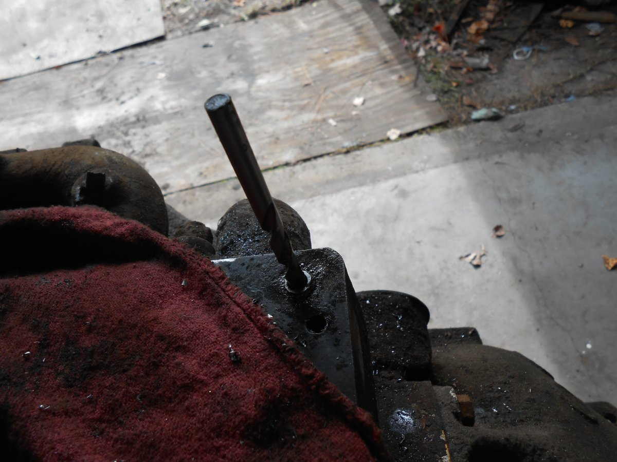

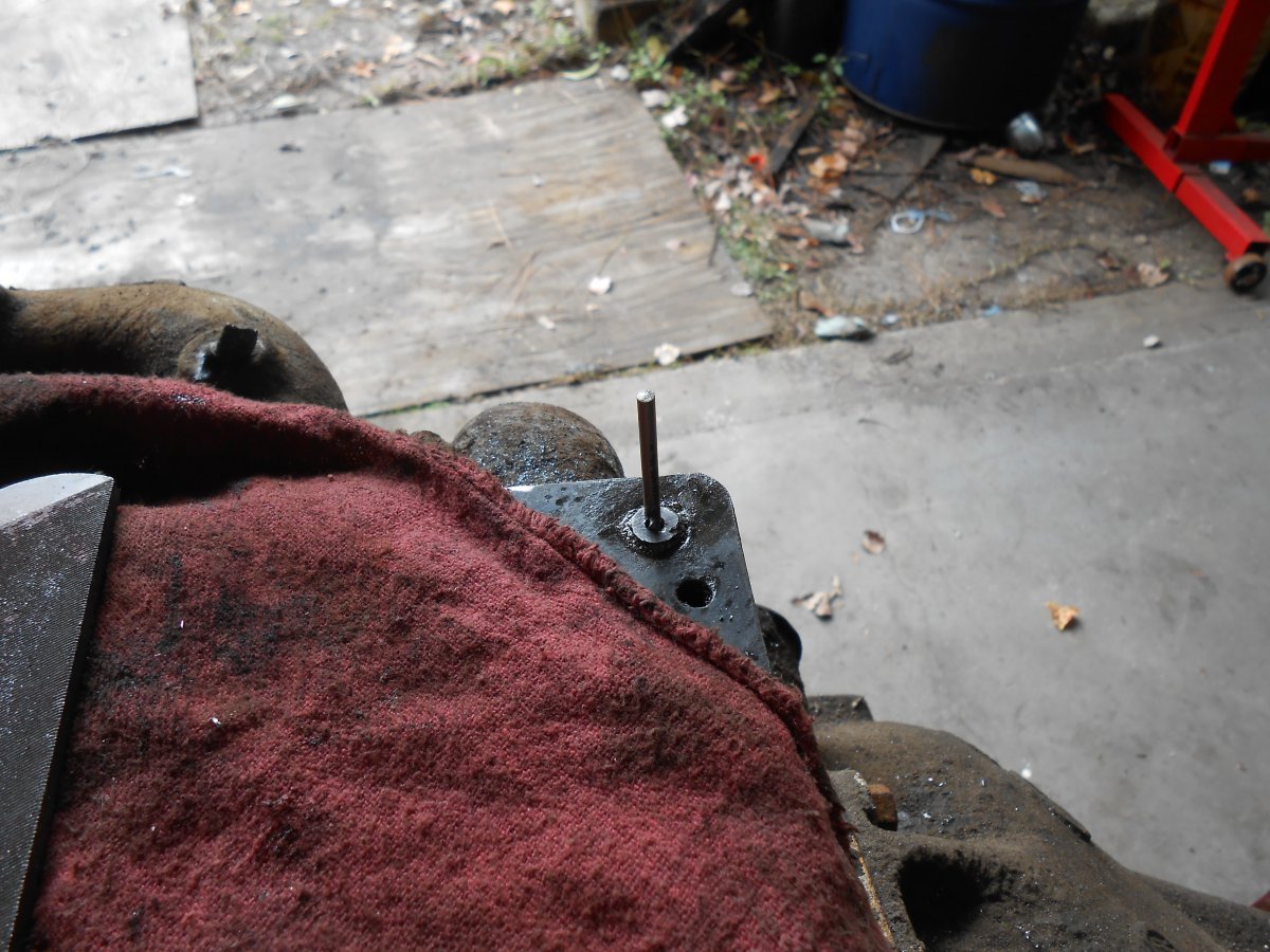

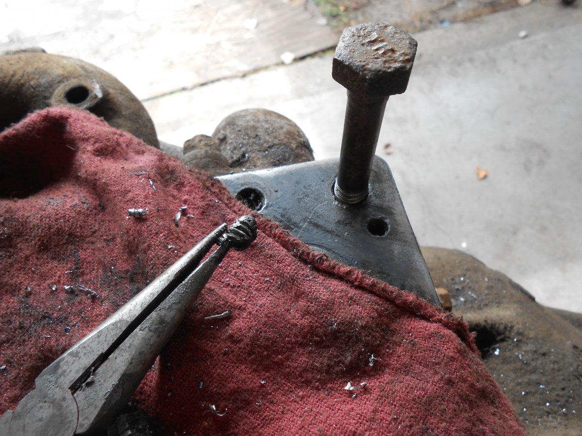

  21. steinauge
    Posts: 1,507
    steinauge
    from 1960

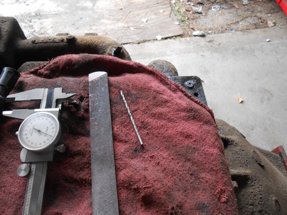

    I pulled the head today.Actually I started yesterday,loosened all the bolts 1 turn,applied penetrating oil,turn bolts back in ,back out and more penetrant etc.I have never ever taken a mopar flat six apart that didnt have stuck head bolts.This one is no exception. They all have "wet" headbolts and corrosion can make them really hard to get out.This morning I took the O\A torch and heated each bolt ,squirted more penetrant and took them out.3 broke .I got all three out at about an hour apiece.Engine is a 218 all stock,no appreciable ridge.Likely worth rebuilding.Pics are getting the broken head bolts out,might be useful to someone.To remove a broken head bolt-. First carefully file the broken off end flat,coat the end with ****m or magic marker,measure the OD of the bolt with your calipers,set calipers to 1\2 diameter-IE if bolt is .400" set caliper at .200",set caliper jaw against side of bolt,use other jaw as center line,move caliper 90 degrees and repeat.The center of the cross mark is the center of the bolt.Centerpunch bolt at that spot,note that if you hole goes in off center all else is in vain---Drill about a 1\8" pilot hole all the way through the broken bolt-use really good drill bits(USA) and go slowly,use lots of cutting oil and clean bit frequently.Once you get this done try a 1\4" bit,then 5\16" then 3\8".This leaves you with a thin shell of the bolt that can be
    collapsed with a small punch and picked out.You can then run a tap through the hole and you are all set.

  22. steinauge
    Posts: 1,507
    steinauge
    from 1960
    Sorry,I hit the wrong DSCN1133.JPG DSCN1134.JPG DSCN1135.JPG ****on,here are the pics.

  23. steinauge
    Posts: 1,507
    steinauge
    from 1960
    And the rest of the pics.The object in the bolt hole is the collapsed piece of the drilled out bolt.The little piece on the needle nose pliers is the last piece of the bolt to come out.BTW the intermediate length head bolts from an SBC are exactly 1 1\2 threads longer than the stock head bolts-just enough for a washer ! :) DSCN1136.JPG DSCN1137.JPG

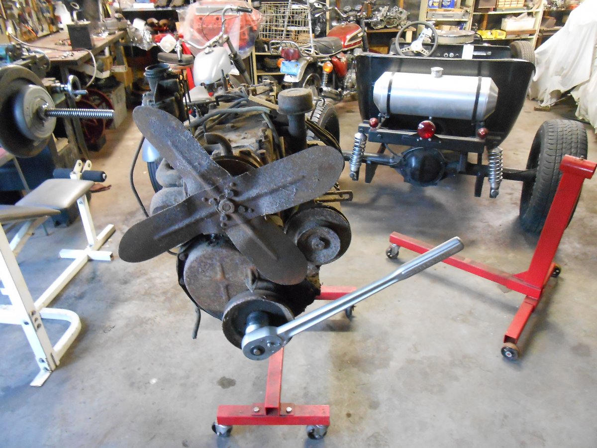

  24. Ebbsspeed
    Joined: Nov 11, 2005
    Posts: 6,479
    Ebbsspeed
    Are you concerned at all about hanging that heavy engine on that stand by the trans mounting holes on the bellhousing? I may be overly cautious but then again I've seen an engine stand fail.

  26. steinauge
    Posts: 1,507
    steinauge
    from 1960
    I have too.IME those chink engine stands usually fail at the top of the vertical post or by the lower tube (that goes to the front wheels) collapsing where the pinch bolt squeezes the rather thin tube.You cant see it in the picture,but that stand has a piece of 1\4" flat stock reinforcing inside the lower tube with a bolt and nut retaining it rather than the pinch bolt.As far as the top,that stand has been in use for several years and shown no weakness there so I reckoned it as an acceptable risk.If I rebuild the engine it will go in the hot stand for any further running.

  29. Mike51Merc
    Joined: Dec 5, 2008
    Posts: 3,855
    Mike51Merc
    I think you have a problem with the engine's center of gravity being over the front wheels because you have the bell housing on. Looks to me like it can easily topple head-over-heels. Oh, and let's please not use racial slurs to describe Asian inferior quality manufactured merchandise.
