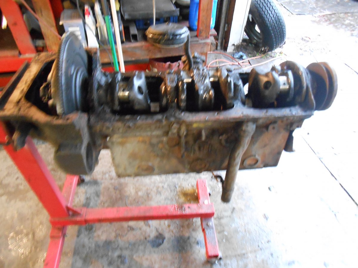

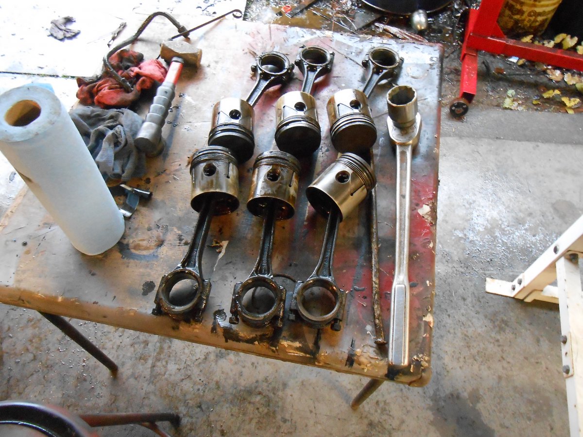

    Gschwen I believe Edmunds made one?It rained all day again, couldnt work on the Ford. I got the pistons out ,not enough ridge to make that hard.Nothing looks bad,rod journals measure to spec.I will get the crank out in the next couple of days. I am hoping a valve job, DSCN1140.JPG DSCN1141.JPG rings and rod and main bearings will do.That way I dont have to bother the local machine shop.I can do everything in house except bore cylinders,I have a boring bar but it is a"cycle-cyl boremaster" and is designed for motorcycles.I reckon I have about a weeks worth of parts cleaning ahead of me.

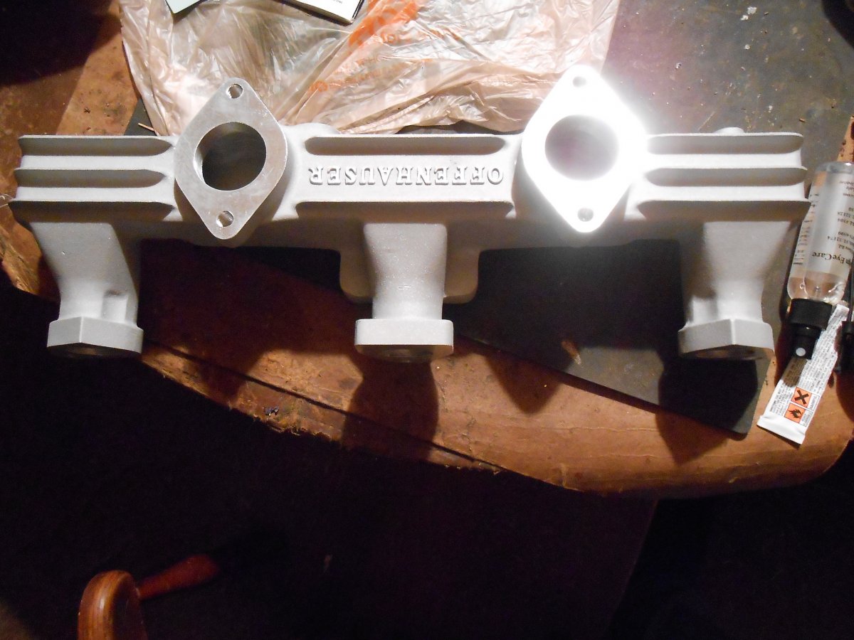

    My new intake manifold got here today,that was fast! Headers should be here monday.I looked in the carb tub today and I actually have one of those old Ball & Ball carbs .There is one on the engine,so I should be OK for carbs. DSCN1145.JPG

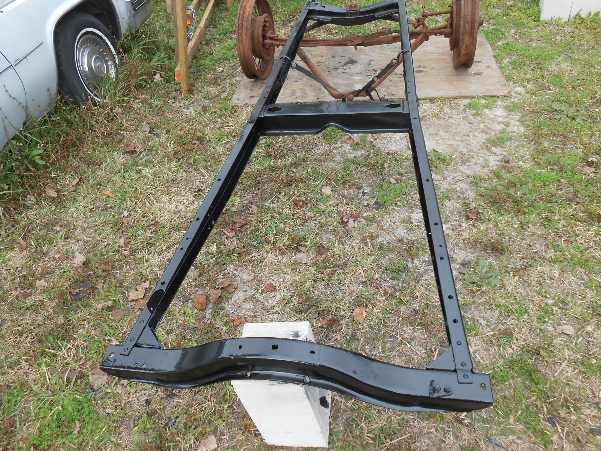

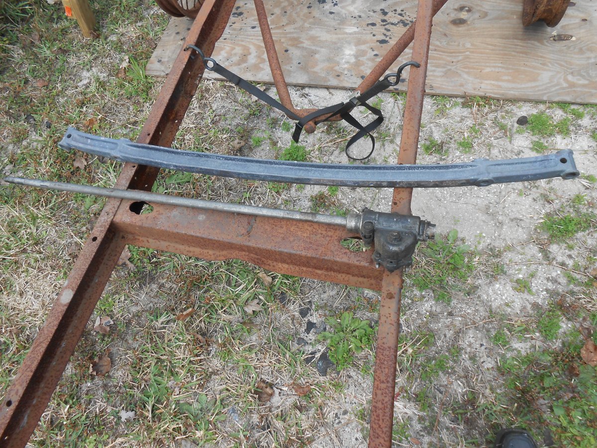

    Went to look at the A stuff.Came home with a decent frame and a junk front end and a few pieces.whole pile cost very little.I can definitely use the frame and can likely pick some parts off the front end.So I reckon this is the plymouth\ford bobtail frame. DSCN1155.JPG

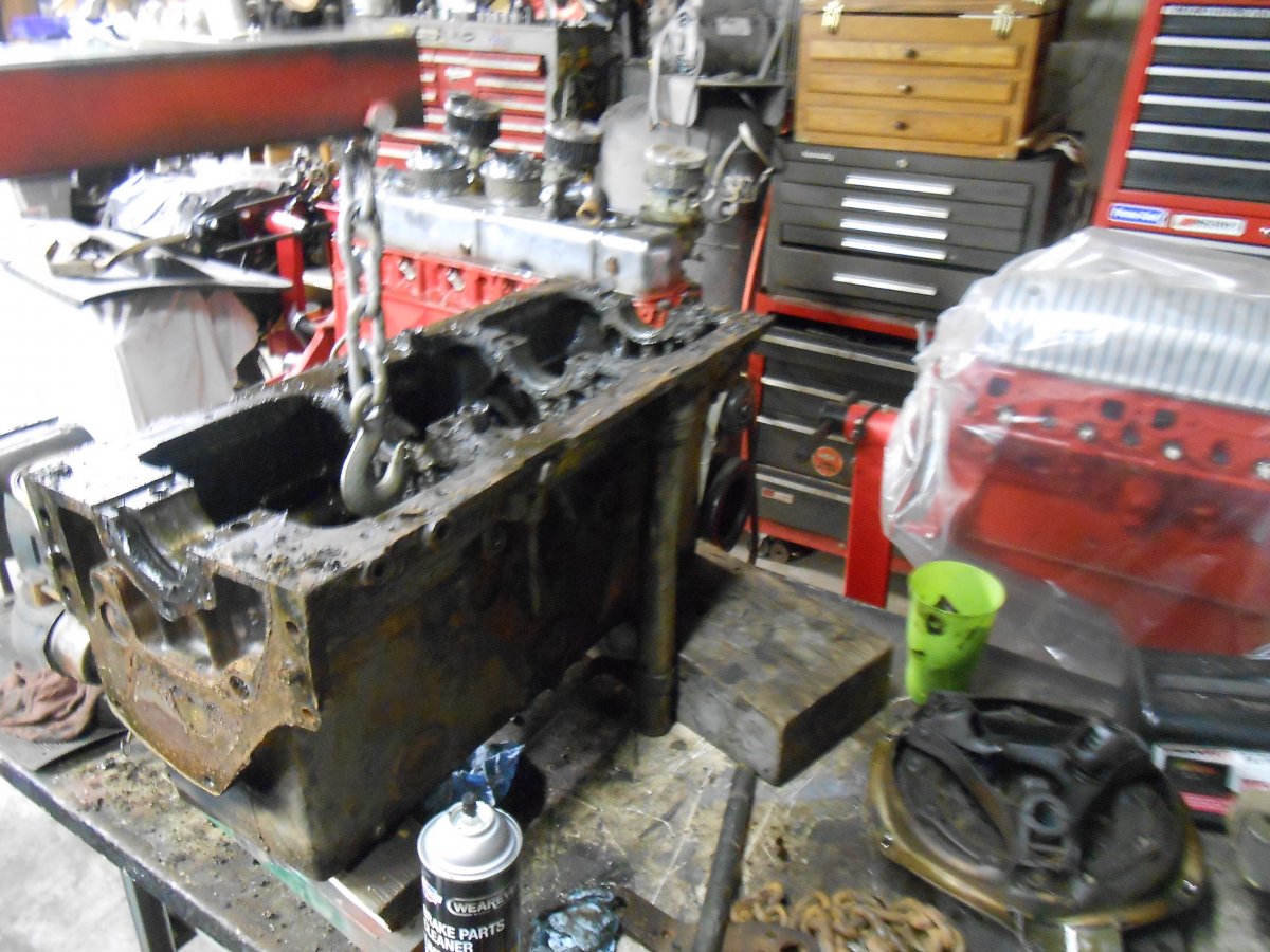

    I finally got the engine apart tonite,looks pretty good other than being really,truly filthy! I believe I will take the cowards way out and haul the pile to the machine shop and get it tanked.I am going tomorrow morning to look at a supposedly good "A" front axle I found on CL,wish me luck. DSCN1160.JPG

    I bought that ratchet and a cardboard box full of 3\4 and 1" drive sockets used in the mid 70s.Not sure when it was made.That 3\4" drive stuff is kind of like a pistol or a big hammer,you dont need it often,but when you do you need it bad and right now!

    Went and looked at "A" stuff today.Guy has a real nice A V-8 sedan DSCN1161.JPG going together.I got a good front axle and a steering box and shaft from him for 55 dollars.

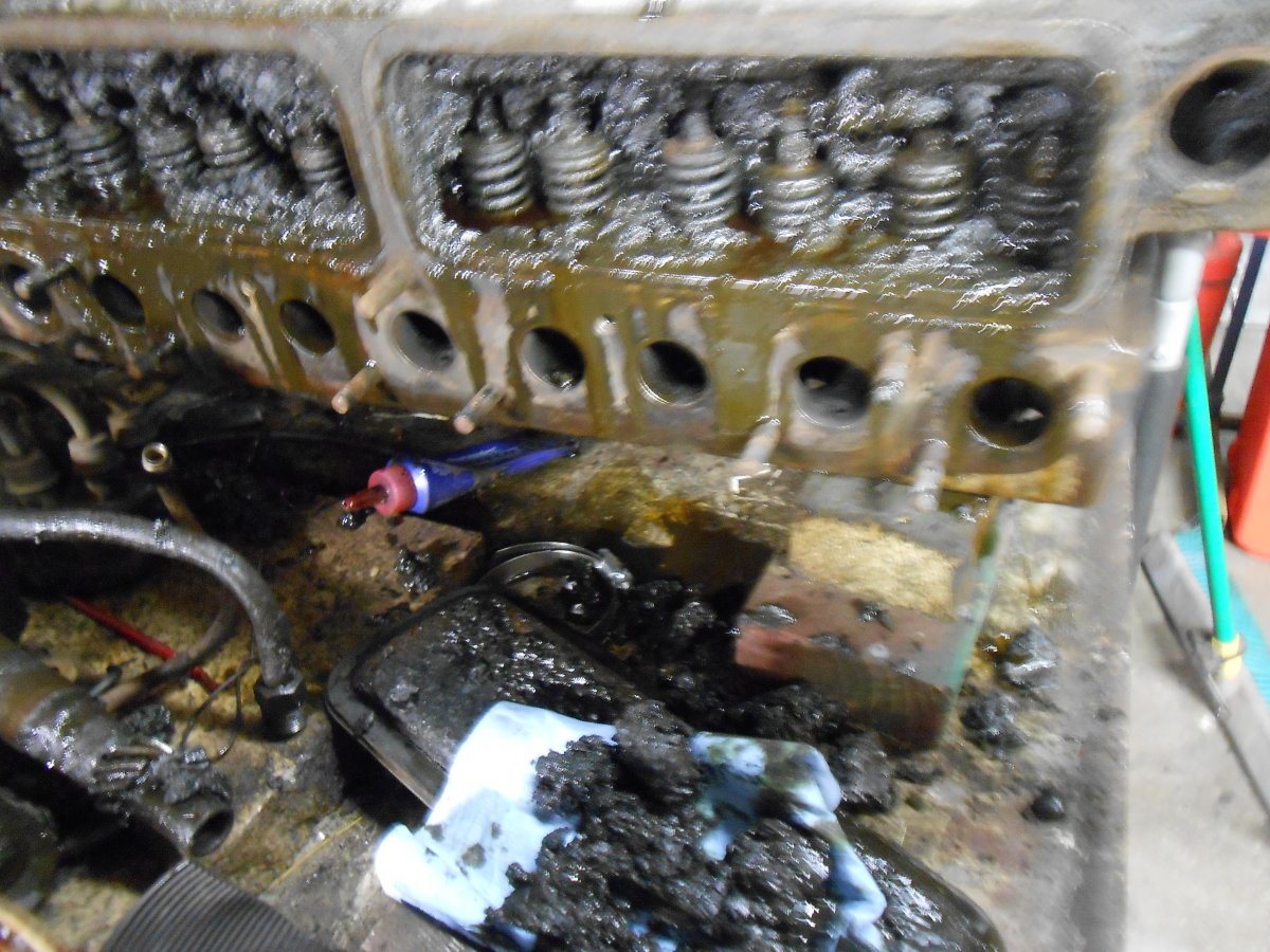

    Had a chance to wire wheel the "A" frame today and get it PORd.Also got the valve covers off the Plymouth,this has to be the dirtiest engine I have ever seen! DSCN1164.JPG DSCN1167.JPG

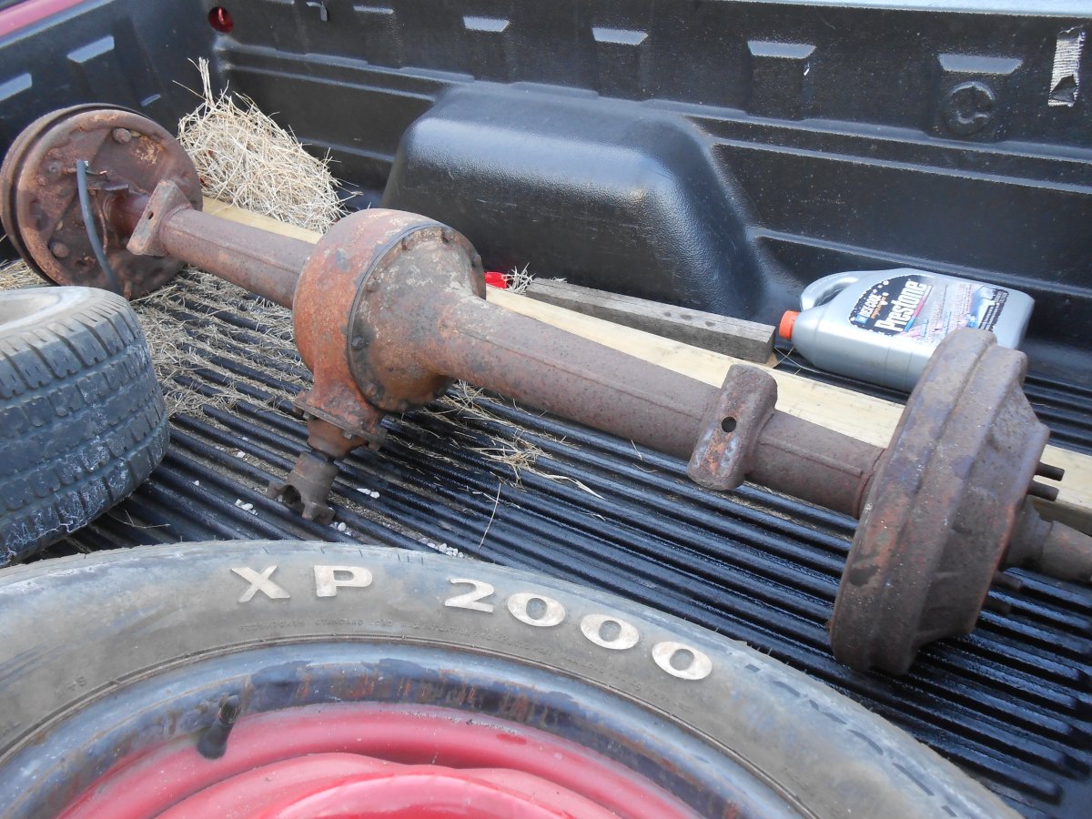

    Spoke to a friend tonight at the weekly cruise who knows about the speedster project.Turns out he has a banjo type 46 ford pickup rear that uses an open driveline?? Says I should come and get it. I will surely do that,but I never knew there was such a thing.Can anyone tell me about it?I will of course take pictures when I go get it.

    All Ford pickups 1946-1948, I think, used the Banjo rear with open drive. Most were 3.78 or 4.11

    Well I went over there today and sure enough,complete right out to the brakes.Turns OK after we got the brakes unstuck where some damn fool tried to pull the drum without backing the adjuster off.He gave me two wheels and tires that supposedly fit it.They dont,but I will take them back and see if we can find the right ones.Now I need to convert this to accept a transverse leaf setup. I am pretty pleased with all this.I have a good portion of the speedster ch***is and havent quite spent 200 dollars.Of course this aint even the tip of the partsberg---- DSCN1182.JPG

    If you use parallel springs on the rear and transverse on the front you get that ol' time traditional bounce while driving it. We could always spot those by the way they rode down the street.

    Manyolcars it looked to me like the A frame is kind of short to use paralell leaf springs or I would do so.I reckon I could go to the junkyard and see what I can find for short ones.Whtbaron I am thinking of going to 12 volts but may not since I have the generator that came with the engine.Thank you zapato.
