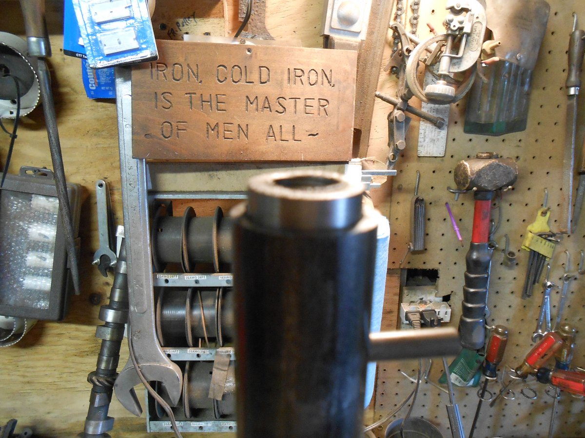

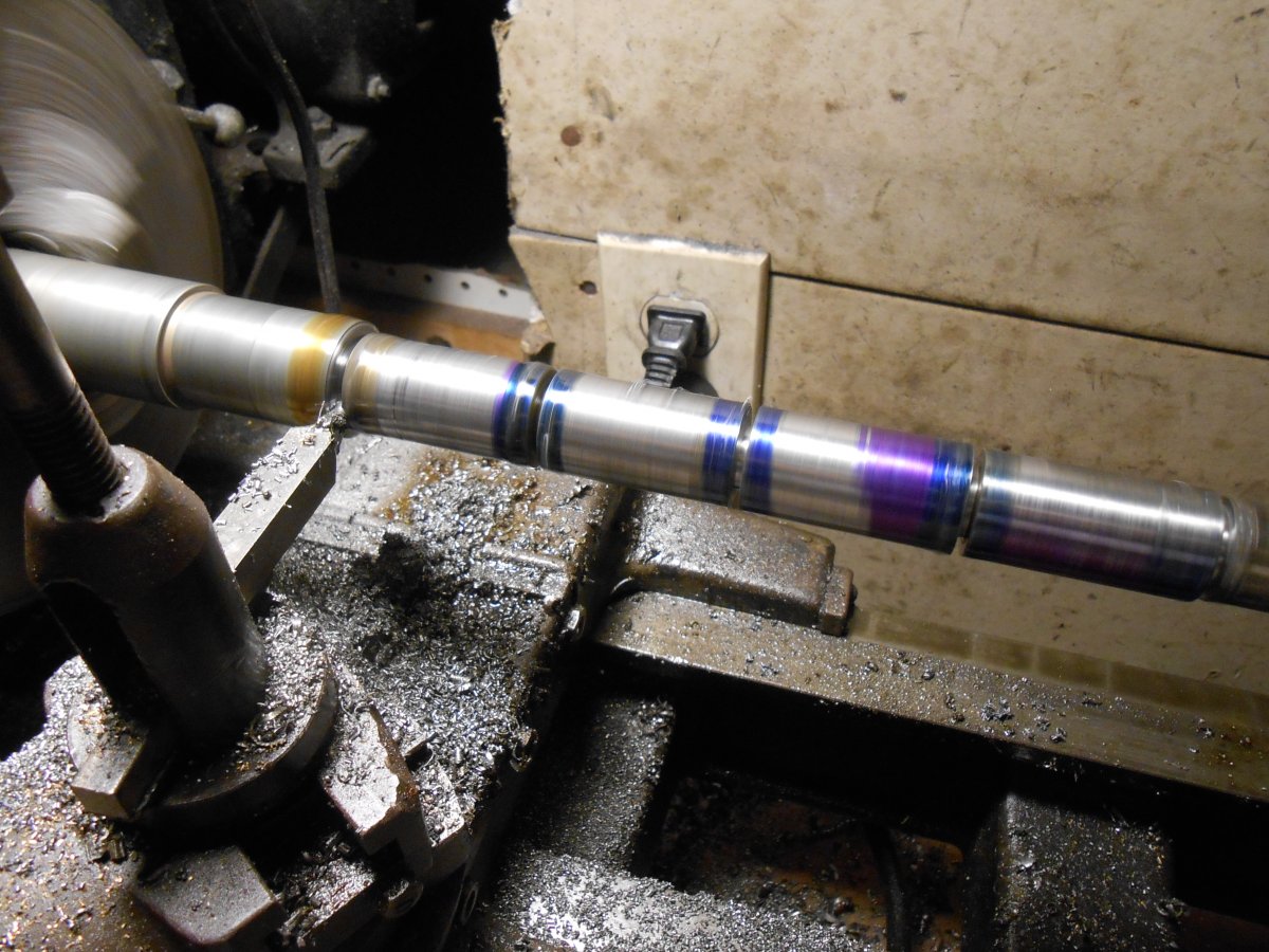

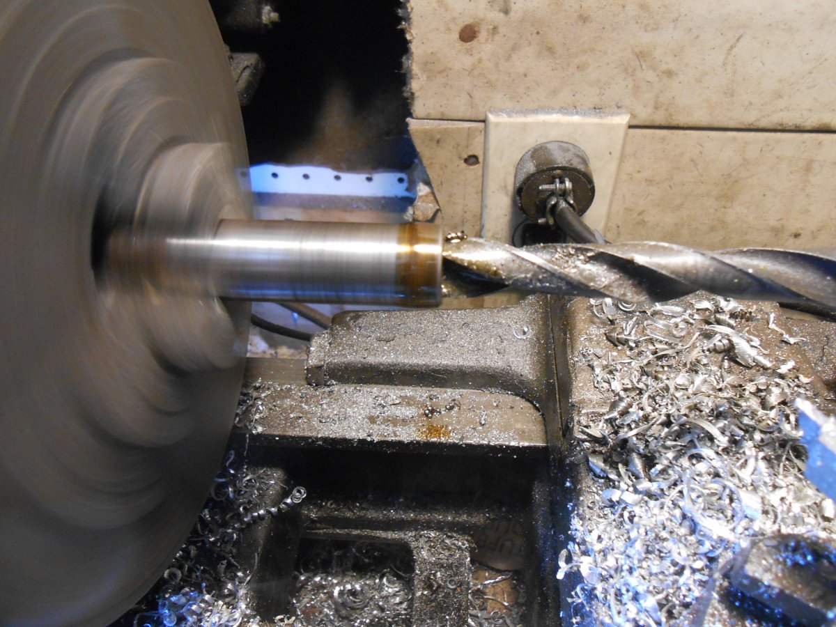

    The spring shackle mount holes were pretty wallered out so I thought I would try fixing them.I bored the holes out a bit,made a sleeve on the lathe and turned it to be a light press fit.Put some Loc***e 680 on it and pressed it in.Seems like it will work.I hope so anyhow.Unfortunately the spring shackles are beyond any reasonable repair.I suppose I could cut the pins off and cut a grease groove DSCN1277.JPG DSCN1278.JPG in a grd 8 bolt and replace the pins that way.

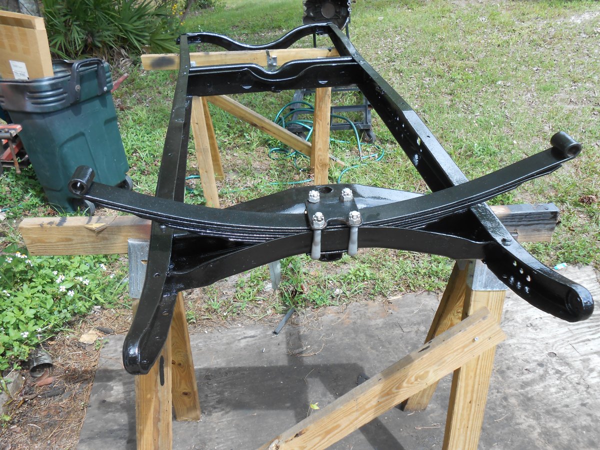

    Got the front spring apart,cleaned up and PORd today.I mounted it up and it looks OK .I found a set of new front spring hangers on egay for like 23 dollars.They should be along shortly.I made some new bushings for the ends of the master leaf.I fitted a new ball to the pitman arm today,cut the old ball off,drilled the hole to .490" and dressed the shaft on the ball to .493 " .That gave it right at .003" interference,heated the end of the pitman arm and pressed it in with the press.I will weld it where the shaft comes through but I really dont need to! I am right at that point where the pile will become a roller ( minus brakes) DSCN1280.JPG in a pretty short time.

    Well--A few days longer than I thought.I ended up splitting the front wishbone and am waiting for the ends and bungs to get here.I could have made the bungs,but for what they cost I didnt feel like standing in front of the lathe that long.

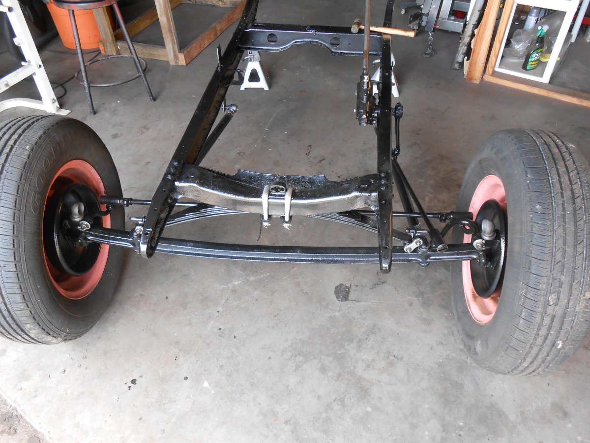

    Well I got the front axle on the frame tonight.Barring the unexpected I hope to have it on the ground tomorrow with (front) wheels on it. DSCN1284.JPG

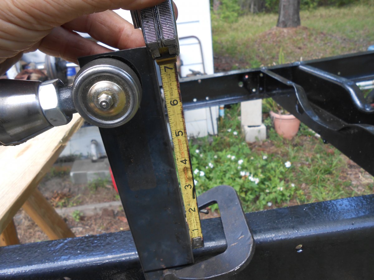

    Could one of you folks tell me what,if anything is wrong with these pictures? I drilled a couple of pieces of s**** to mock up the radius rod mounts.It is 7 inches from the bottom of the frame rail to the center of the mount hole.Seems I dimly remember about a 4" distance there the last time I did this?? DSCN1287.JPG DSCN1288.JPG

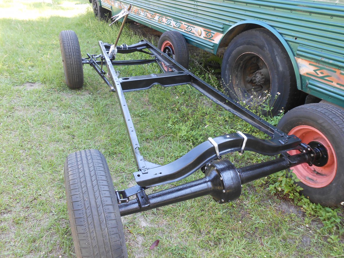

    Pretty good day.Got the thing to roll(wheelbarrow style:)) .Steering box seems to work fine as does front suspension.Note hi tech field expedient steering wheel and trendy pink wheels;) I believe I will mount the rear end solid for the moment just because its so easy and can be done without harming anything. I can change it when I decide how I want to do it. DSCN1289.JPG DSCN1291.JPG

    Stein...Mock up the height of the front with spring loaded: (when the engine/transmission are in it)
    Spring will flatten, and the wishbones can be mounted 'higher' at rear.
    Actually, they should be mounted more like 4" below rail, caster can finally be set by 'V-ing' the wishbones behind the joints of the yokes, then welding them up. 5*-7* positive caster at ride height. (front and back)
    Be sure of total finished curb height before final welds...
    I'd bet a want ad for some 'A' leaves (or better, a '26-'27 T spring, they're lower, and the leaves are not as wide as A's, so can ride 'softer' when leaves are 'adjusted' in number!)

    Mike thank you for your help!That is some good info. I had mentioned a couple of posts back that I dimly remembered about 4",glad to know I remembered that much at least.

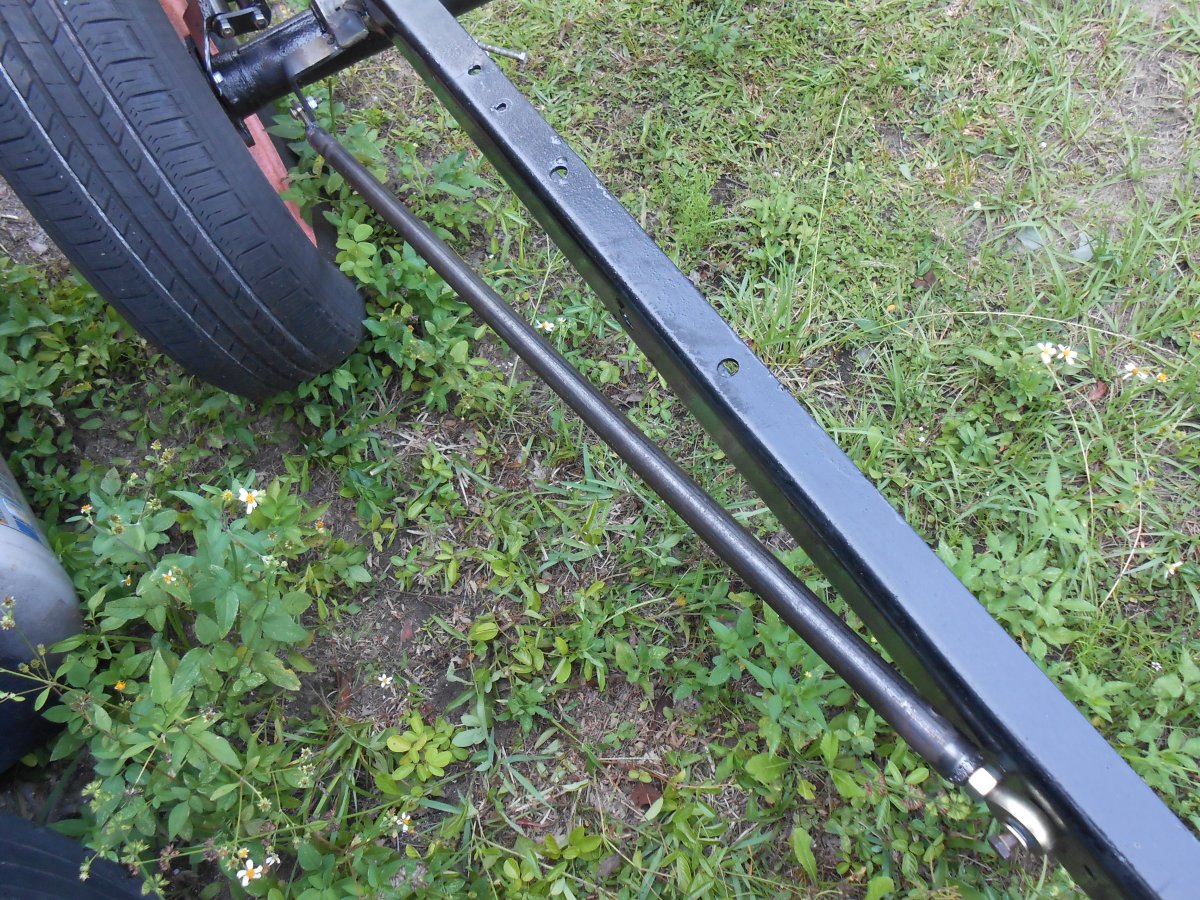

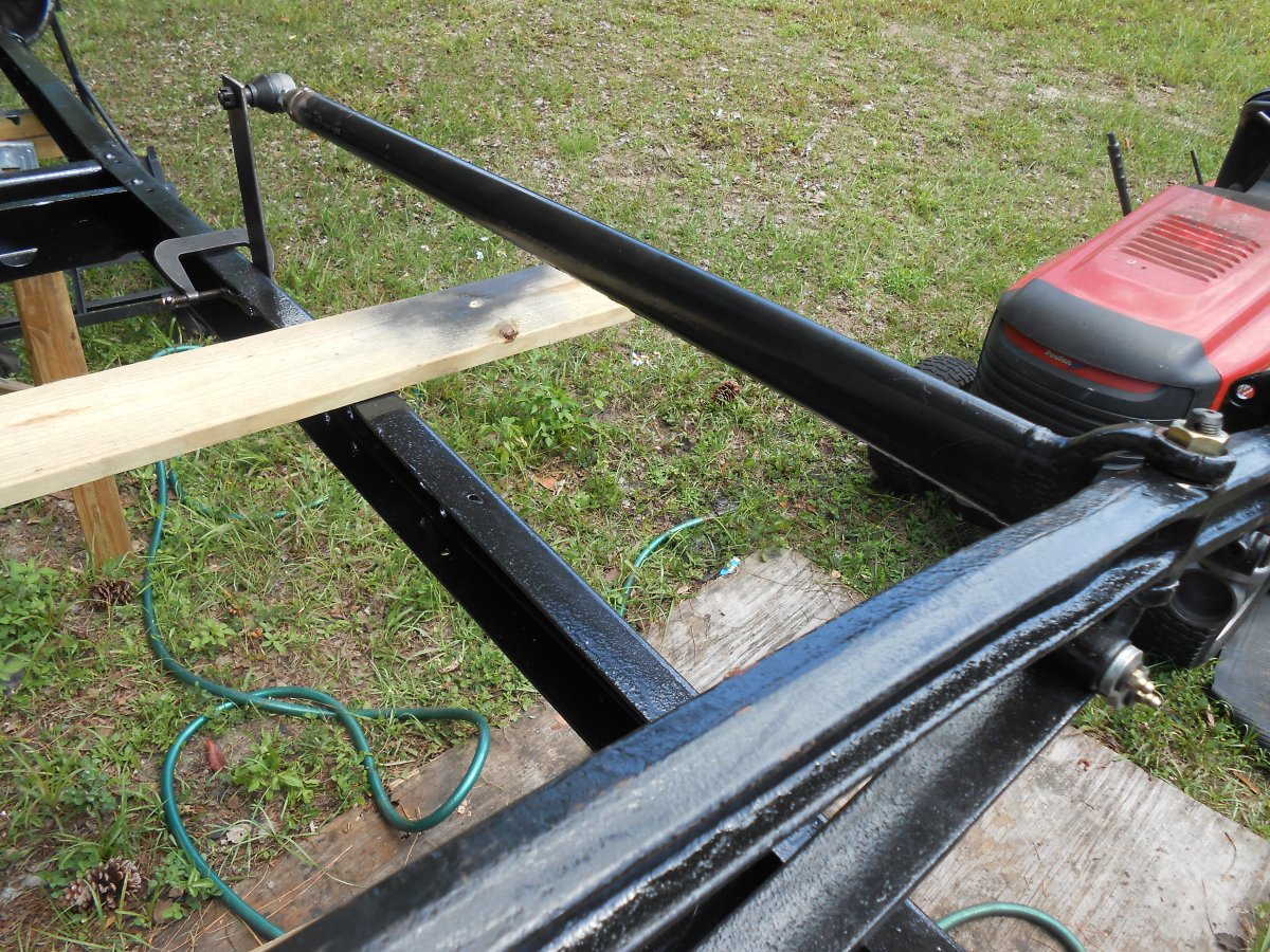

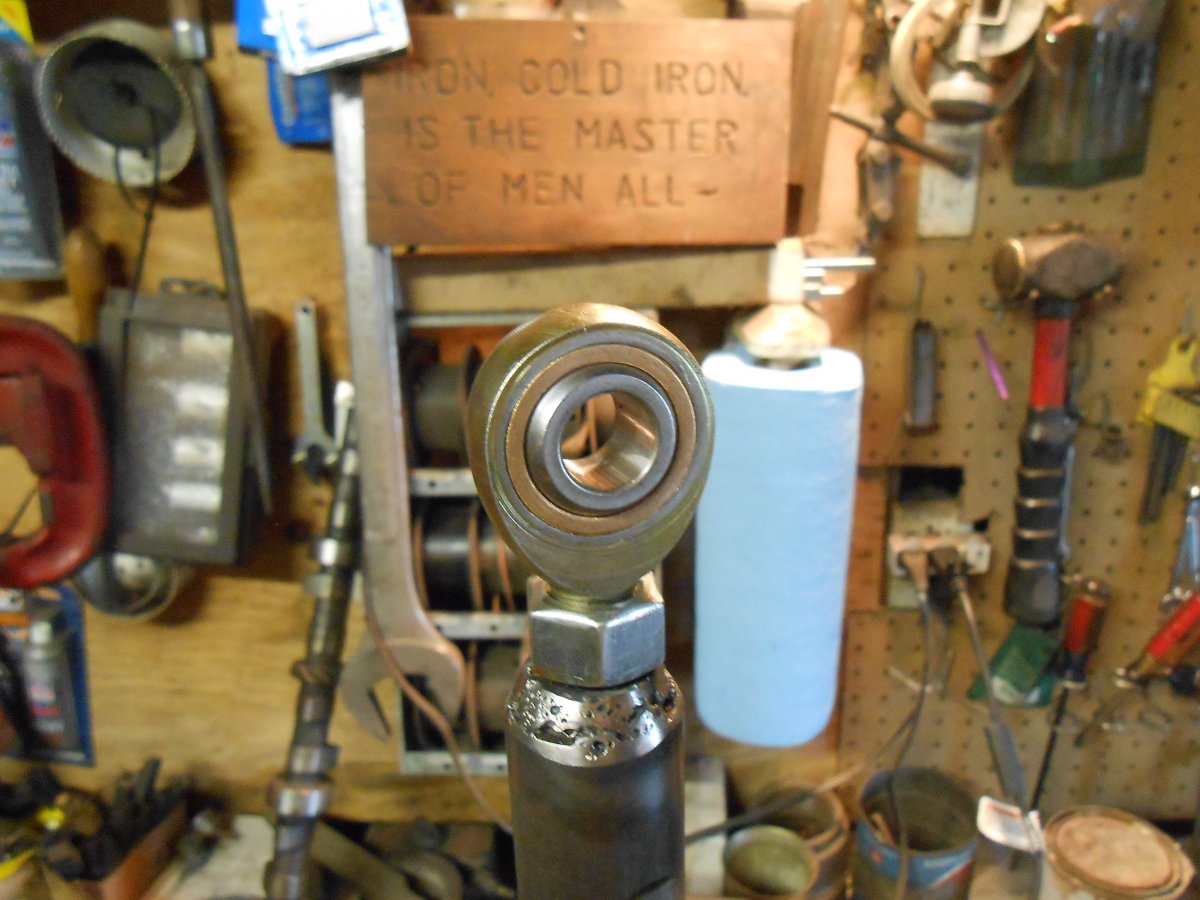

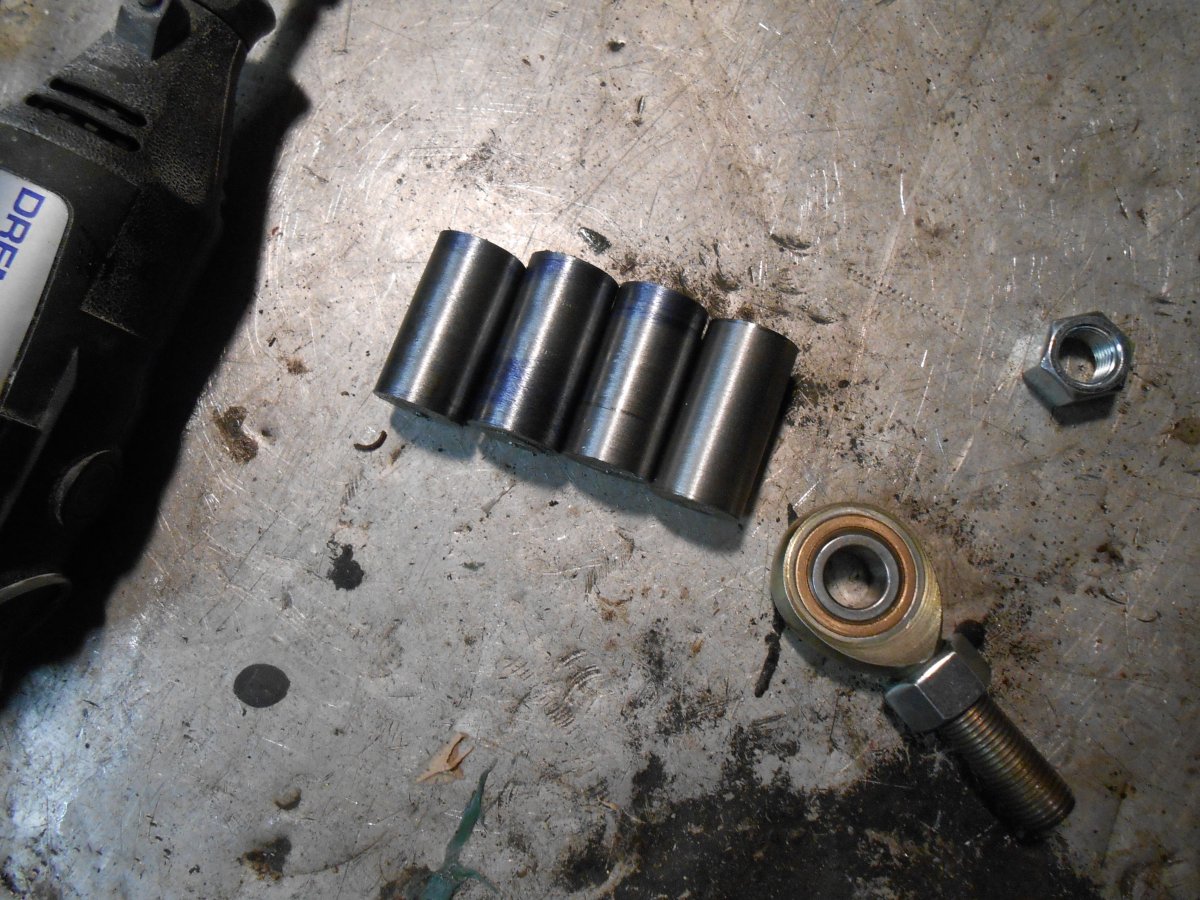

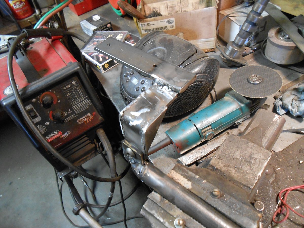

    I started building rear radius rods today.I got a couple of pieces of 1" tubing and a couple of heim joints.Ended up making the end plugs that accept the heim joint and the rear mount bolt out of a fairly late model HD axle that was in the s**** box.What a piece of **** steel! Hard and soft spots all through it.Didnt use to be like that.I wanted to mount the radius rods off the spring plates on the 46 rear end,so I had to make a mount for that.Here I have the axle turned down to be a drive fit in the tubing and am parting off the 4 plugs.Here are the plugs,2 have to be bored and tapped 1\2" X 20 and 2 have to be slotted to accept the tab that bolts to the rear mount.Here is the plug driven into the front of the radius rod after drilling and tapping.Each of the plugs has a hole drilled clear through it and the tube and a piece of 1\4" round stock in the hole as a rivet. And after welding.Between the drive fit,the pin and the weld I am hoping the ends stay in place-------And the rear mount with the rod on it. Last the rod and mount DSCN1335.JPG mocked up on the ch***is. DSCN1336.JPG DSCN1334.JPG DSCN1333.JPG DSCN1330.JPG DSCN1331.JPG
  27. The brackets for the radius rods will not stand up to any torque run through that rear axle. And mounting them through the frame rail is also not advisable, it's only about 0.125" thick.

    Thank you for your advice.I had figured on using a piece of 3\16" plate inside the frame where the radius rod bolts on.I have done it that way before with good results. Please tell me why the rear mounts wont work .I suspect you are thinking they will bend where the plate that bolts to the leaf spring plate is welded to the rest of the mount. I thought of that but am going to try it and see.If it does I can easily reinforce it.If it is something else please tell me.
  29. They will want to fold where the spring pad and plate bolt together. Best bet is a bracket that gets welded all around the tube to control the axle wrap. The two links will also bend at the pinion tries to climb the ring gear, you will need links to the top of the tubes as well. Like this:

    Thank you very much for your help.A perfect example of what makes the HAMB great! I didnt think the problem through. I was trying to avoid welding on the axle tubes ,but I believe I can see how to fix this.
