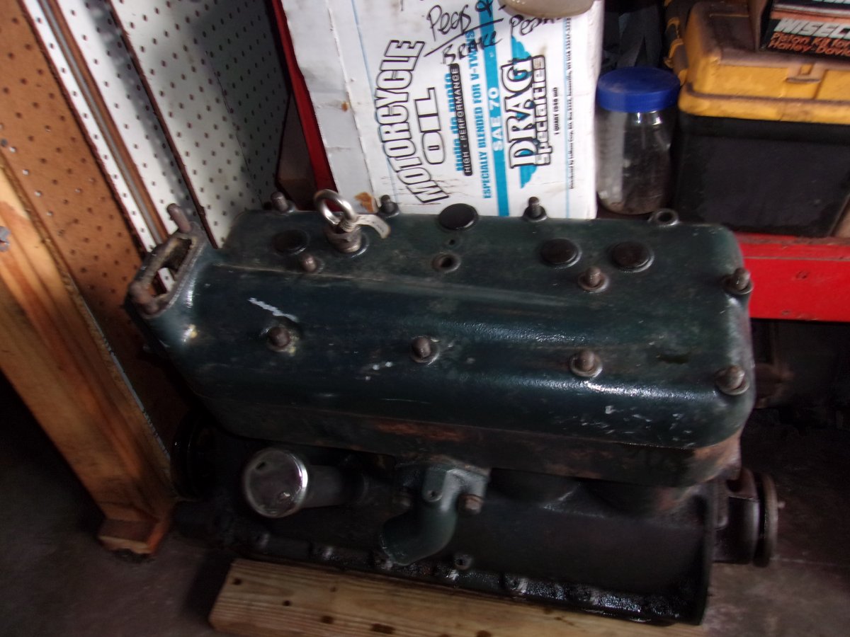

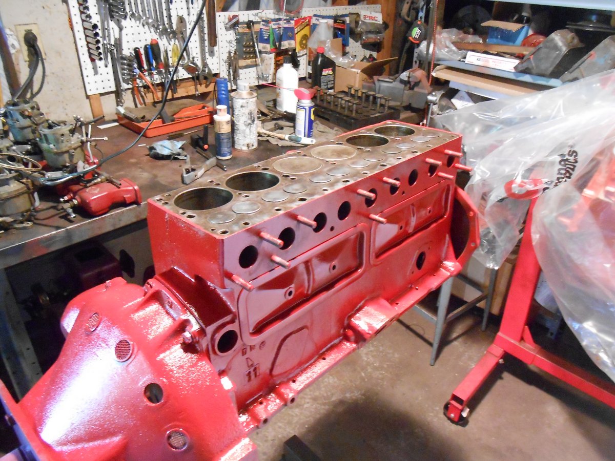

    Well,I have the short block together at last.I am waiting for my new lifters to get here and I can finish the engine up! DSCN1460.JPG I just couldnt deal with the blue color.

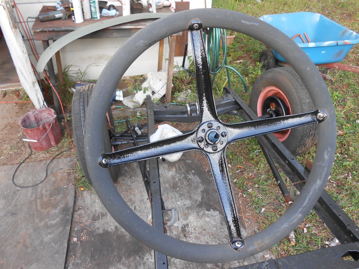

    I scored a steering wheel for the speedster at the turkey rod run! It seems to be in pretty good shape.All I have done is gl*** bead the metal and prime and paint it.About the last thing I expected to find. DSCN1542.JPG

    I see it has been a year since I posted on this thread! I mocked the engine and trans up in the frame and do not like the way it looks. It is just too long for the car.(I have NO idea why the font just changed).I had a junk model A engine and trans that could be repaired but----Last week I picked up a pretty decent A engine that I think I will use.Today at the turkey rod run I picked up a 39 ford trans cheap 100_0139.JPG and a ratty model A cowl so I reckon the build is back on.I will post pics of the trans and cowl tomorrow.I have everything for this engine from the junk engine except a repairable distributor.

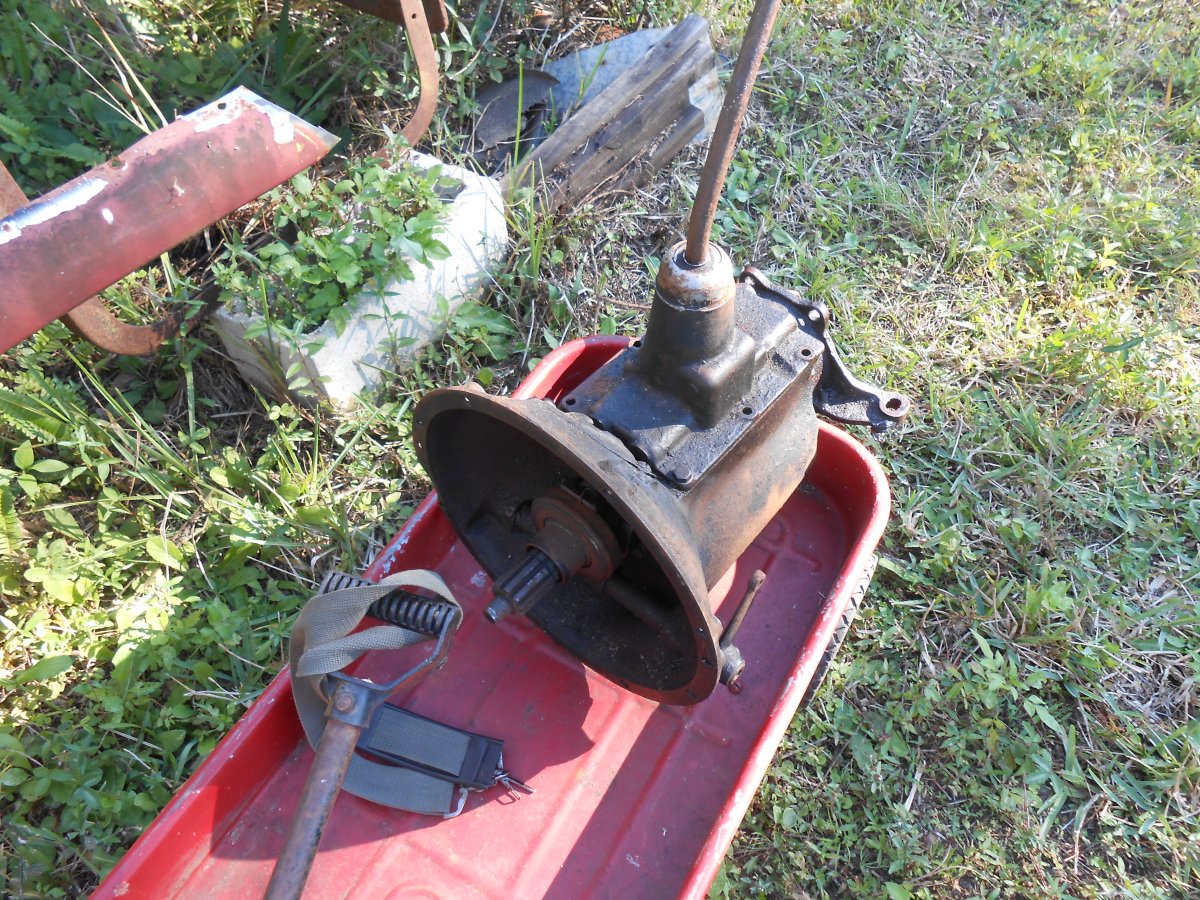

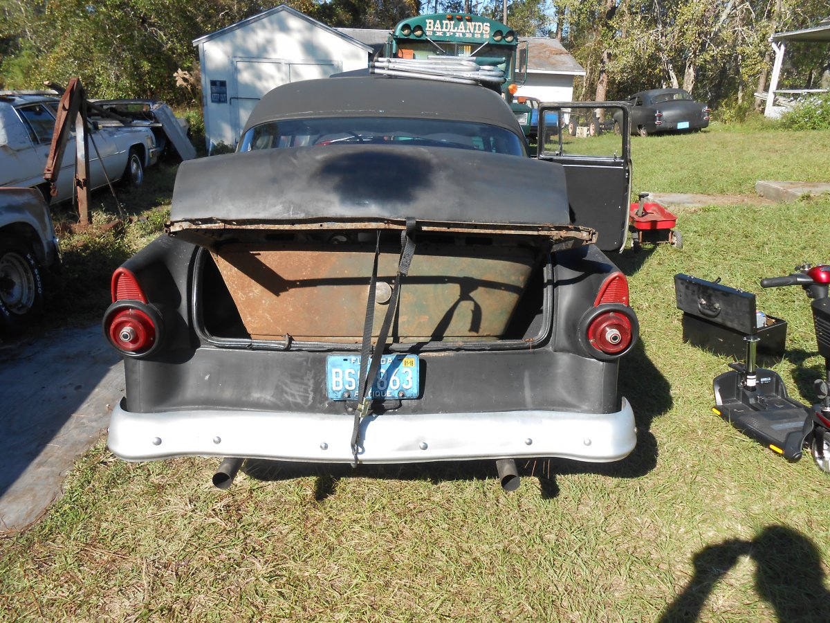

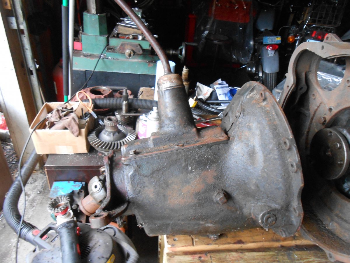

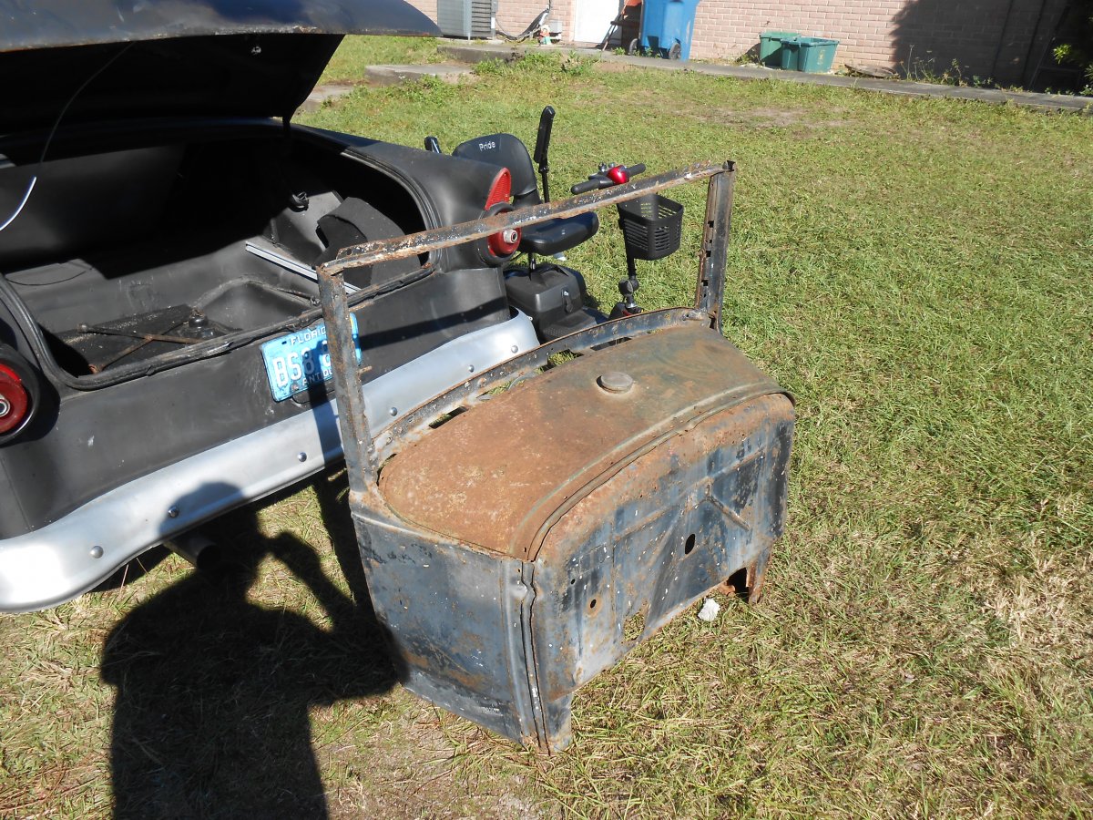

    Since the water tube is likely the hardest part to get out of the engine thats likely what it is! Packard made their water tubes out of br***,what a GOOD idea! Here are a couple of pics one proving that you can actually put a complete model A cowl in the trunk of a 55 ford,pic of the cowl and a pic of the trans.Trans looks good inside,turns and shifts smoothly and had plenty of old oil in it. DSCN1629.JPG DSCN1630.JPG DSCN1631.JPG

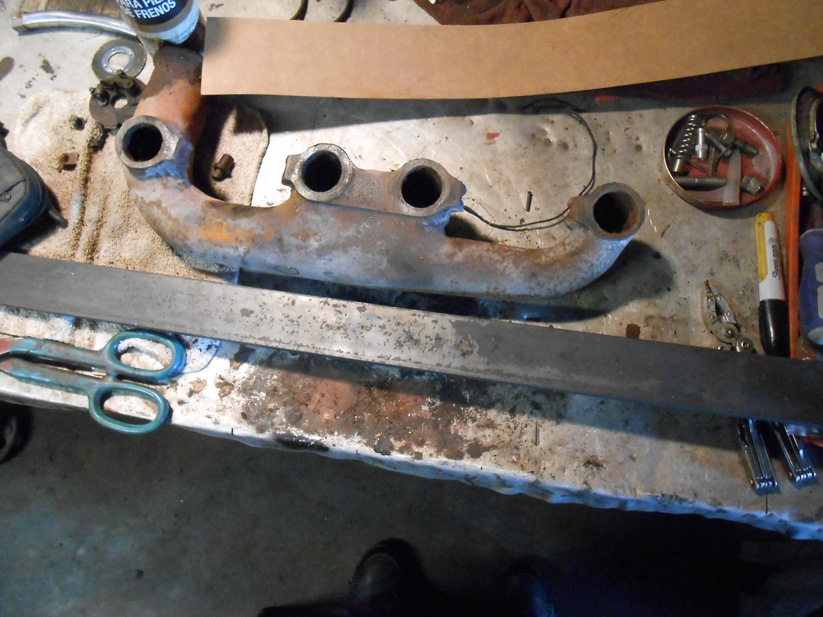

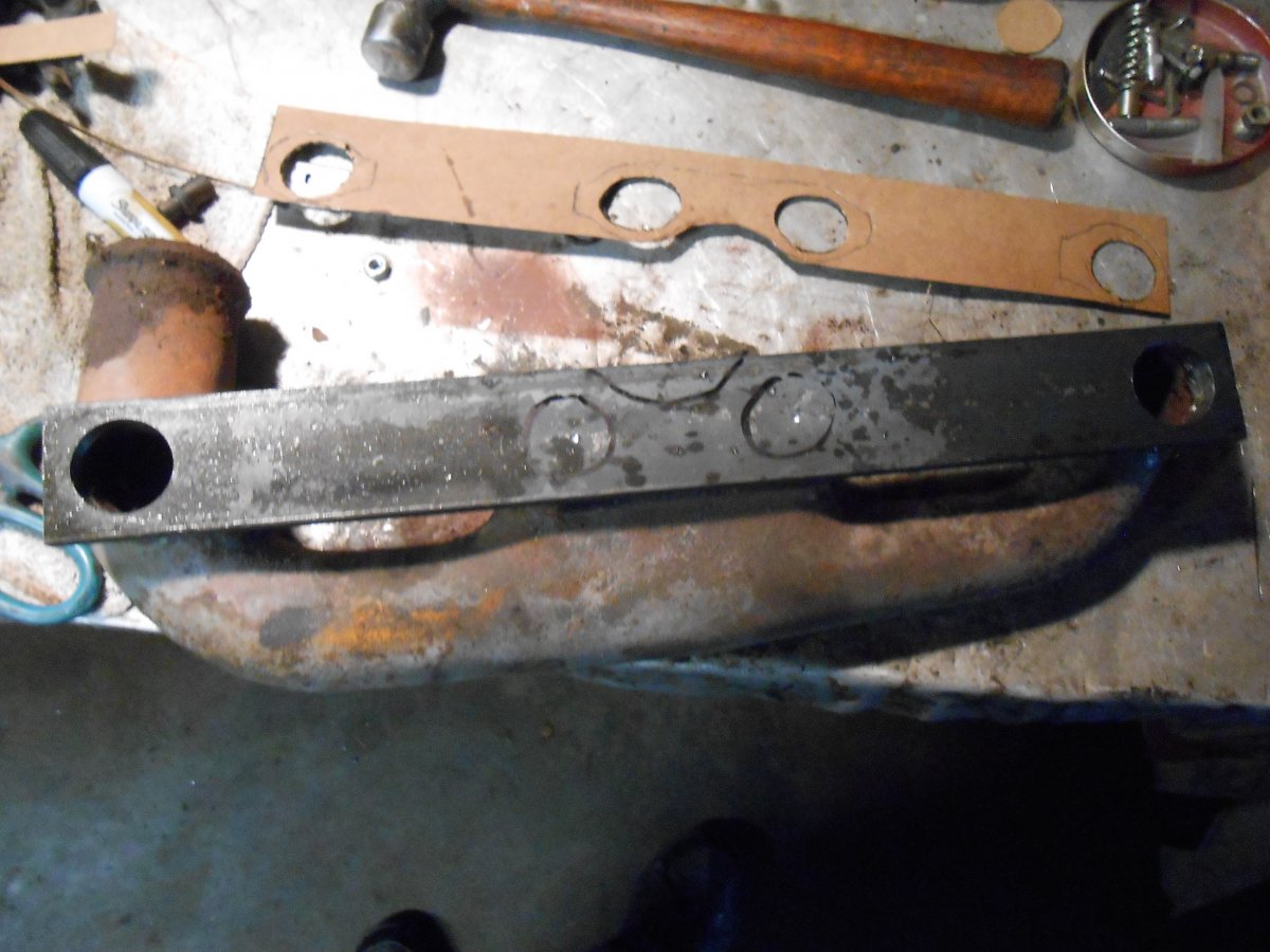

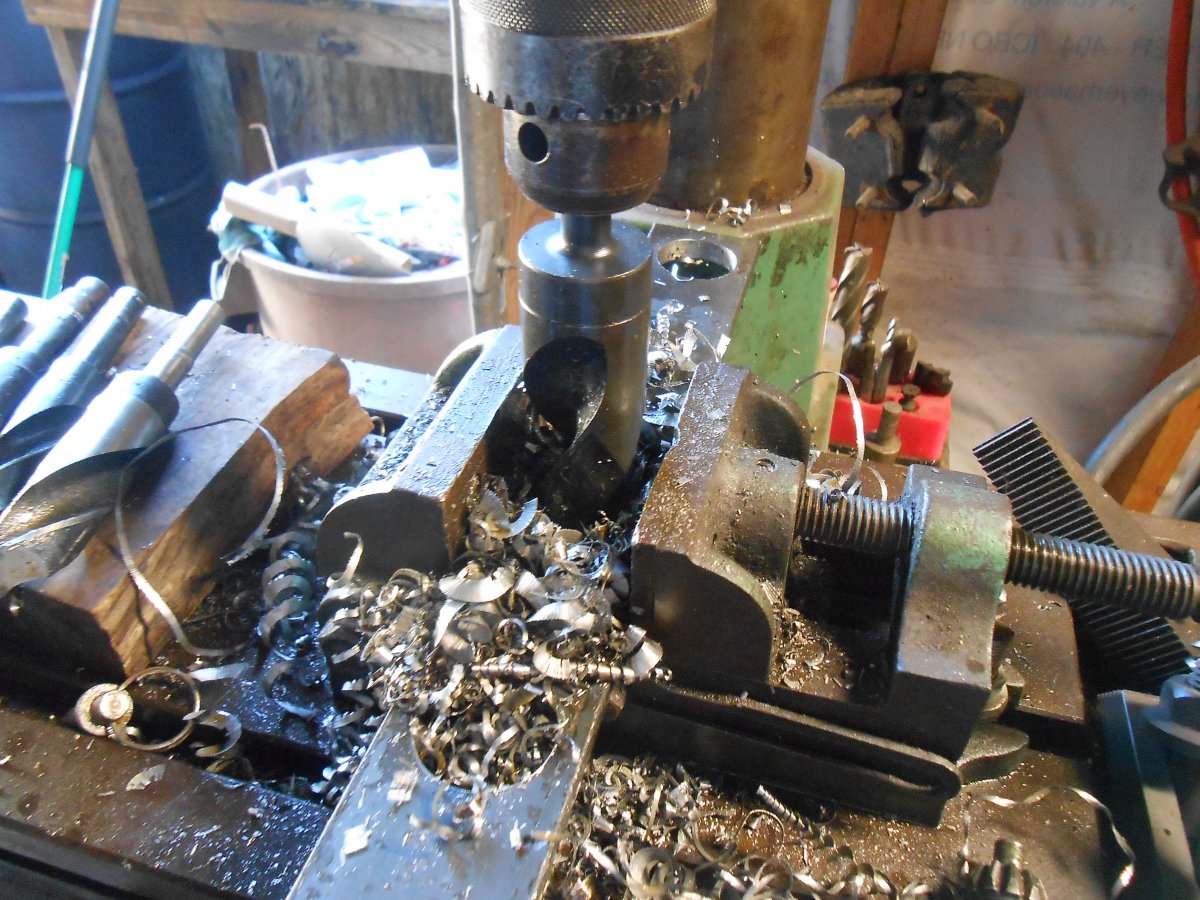

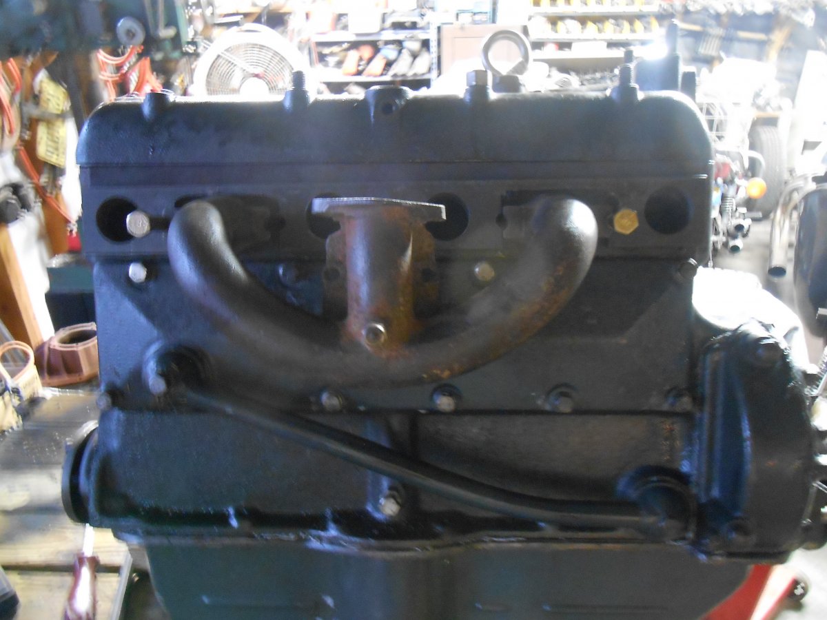

    Well I had no luck finding a model A header flange so I reckon I will make my own.I started out with a piece of 2" X 3\8" flat stock 3 feet long.I established a C to C distance on the holes in the manifold and measured them for size-1 3\8"-then center drilled the centers of the holes,put the piece of stock in the mill and started drilling.I got this far and am delighted to note that the 2 end holes align perfectly with the ports.I will do more tomorrow. DSCN1633.JPG DSCN1632.JPG

  24. RMONTY
    Joined: Jan 7, 2016
    Posts: 2,662
    RMONTY
    I reckon that'll work! Looks good!

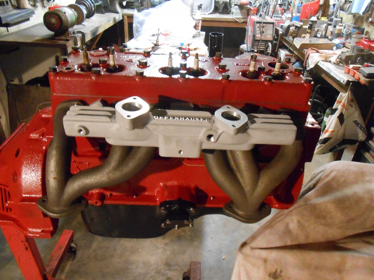

    Got farther along today. Drilling the last port. Next pic shows the flange and intake kind of stuck onto the engine. dont intend to run the stock intake as a down draft but it was what I had for mockup. DSCN1636.JPG DSCN1634.JPG

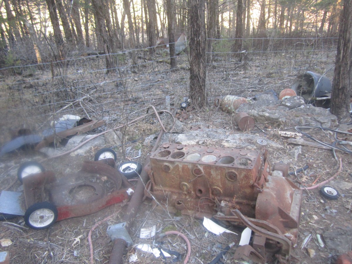

  26. heres a 217 that came out of a 49 dodge pk. It certainly aint free. I don't think even MMO would get it unstuck. I uncovered it to take the picture. It has a sheet of tin over it to keep out the rain. setting & rotting 029.JPG

  27. steinauge

  28. Yes it could be bored or even sleeved. It was torn down and partially stripped when We got it and the rest of a pilot house truck. For some reason I couldn't justify selling it for s**** back when s**** was at record prices a few years ago.

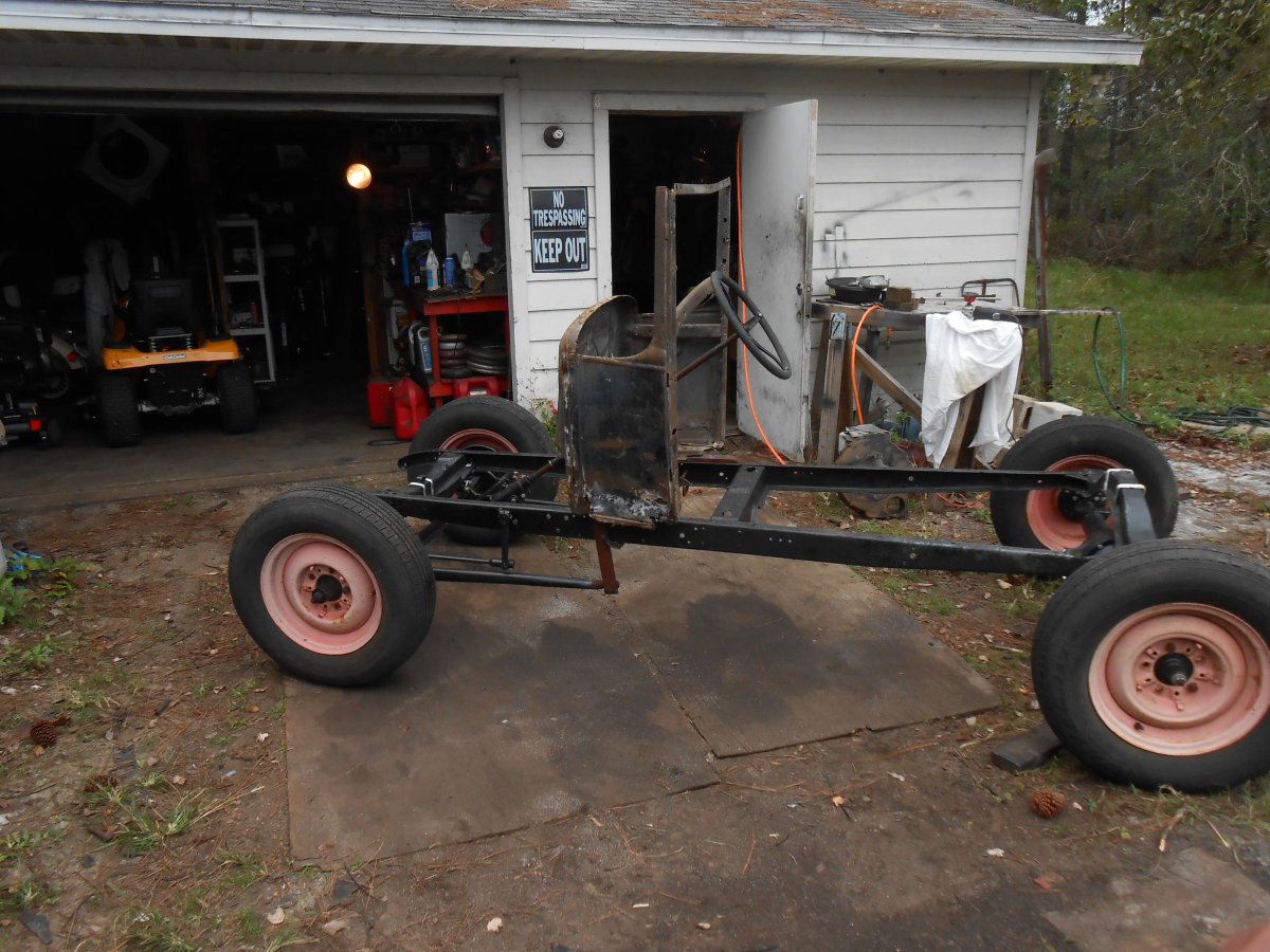

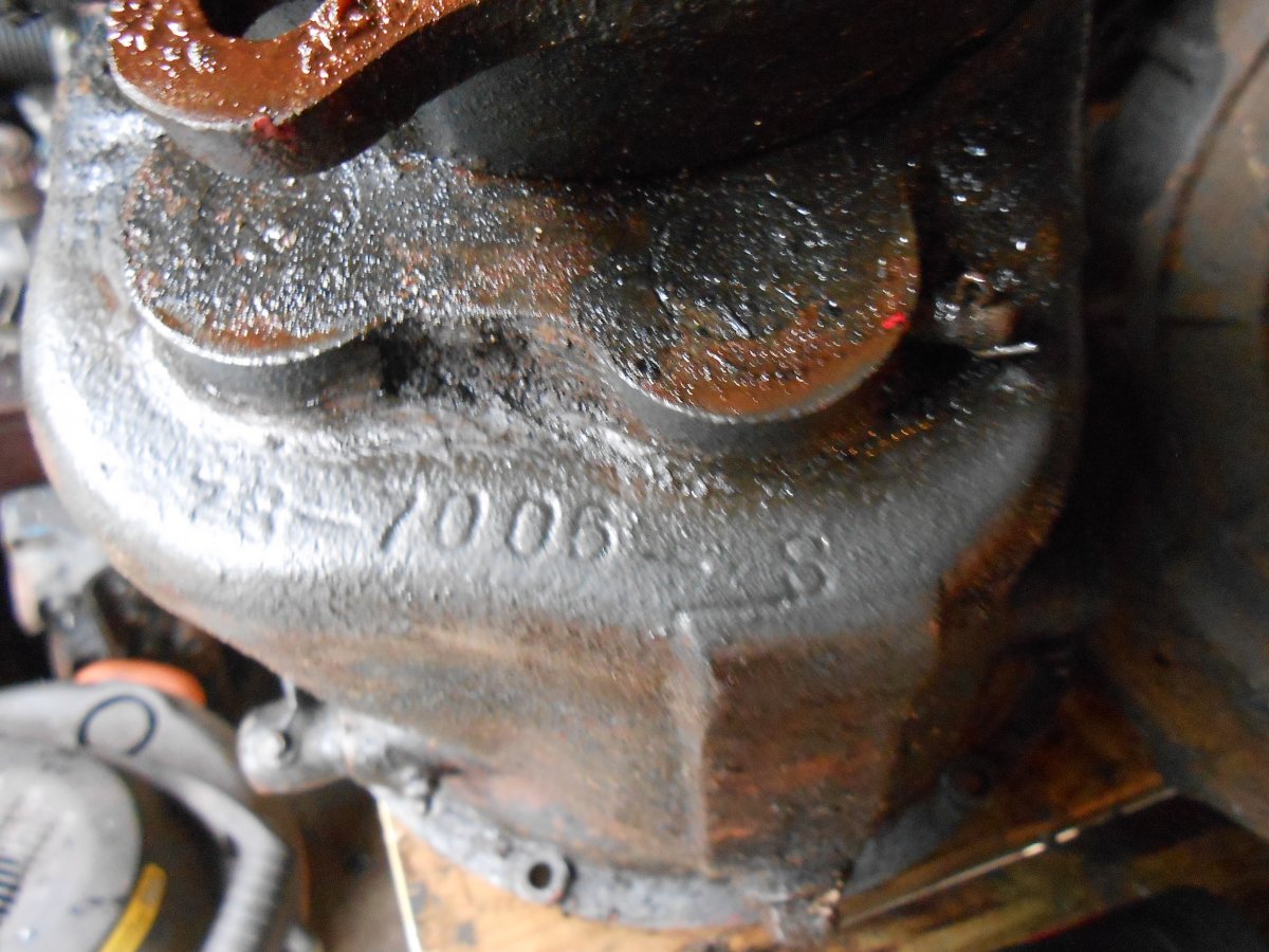

    Stuck the cowl on the frame today just to see,definitely have to shorten the windshield. Can anyone identify this transmission? I was told it was a 38-39 ford. DSCN1637.JPG DSCN1639.JPG DSCN1640.JPG
