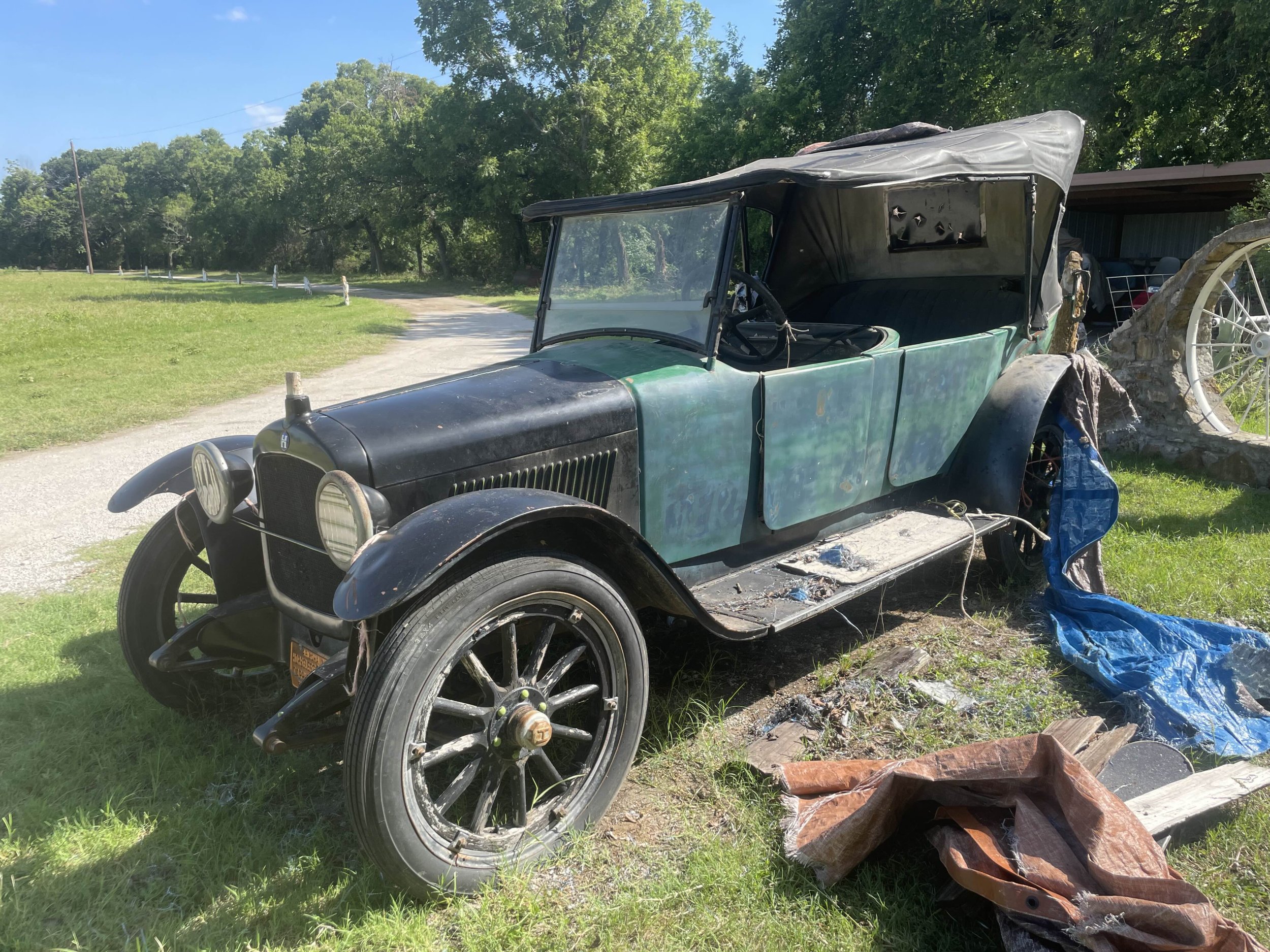

    A customer mentioned her dad had p***ed away, and left her some old cars to deal with. She asked if we might be interested in taking a couple of the prewar cars in exchange for hauling off some of the junk cars so she can sell the property. The first of the prewar cars is this Hupmobile.
    A small frog was mildly inconvenienced by our activities.
    The engine - a big four cylinder with a crazy long stroke - is not locked up, has compression, has clean oil, clean antifreeze, the clutch works, the transmission shifts, the brakes work and the tires hold air. He apparently had the car running about 5 years ago.
    However, it is built like a Chevrolet, meaning the cowl back is mostly wood with thin sheet metal nailed to the frame. The wood is all there, but pretty soft in some places. The body is sagging behind the cowl so the front doors won't close.
    Comprehensive information on Hupps is kinda scarce at a glance and I haven't had much time to tuck into it, but it seems like a Model N, maybe 1917ish?
    I don't really know what to do with it but I figured I'd get a journal going for it. I may end up selling it, but since it seems like it's so close to running and driving, I'll start there. I guess if I decide to keep it after driving it around the neighborhood I'll need to join AACA or something. Part of me is thinking strip it down and make a big speedster with it but the Hupp four cylinder is not exactly a powerhouse and the body panels are all pretty nice so I would feel kinda bad breaking up the car.

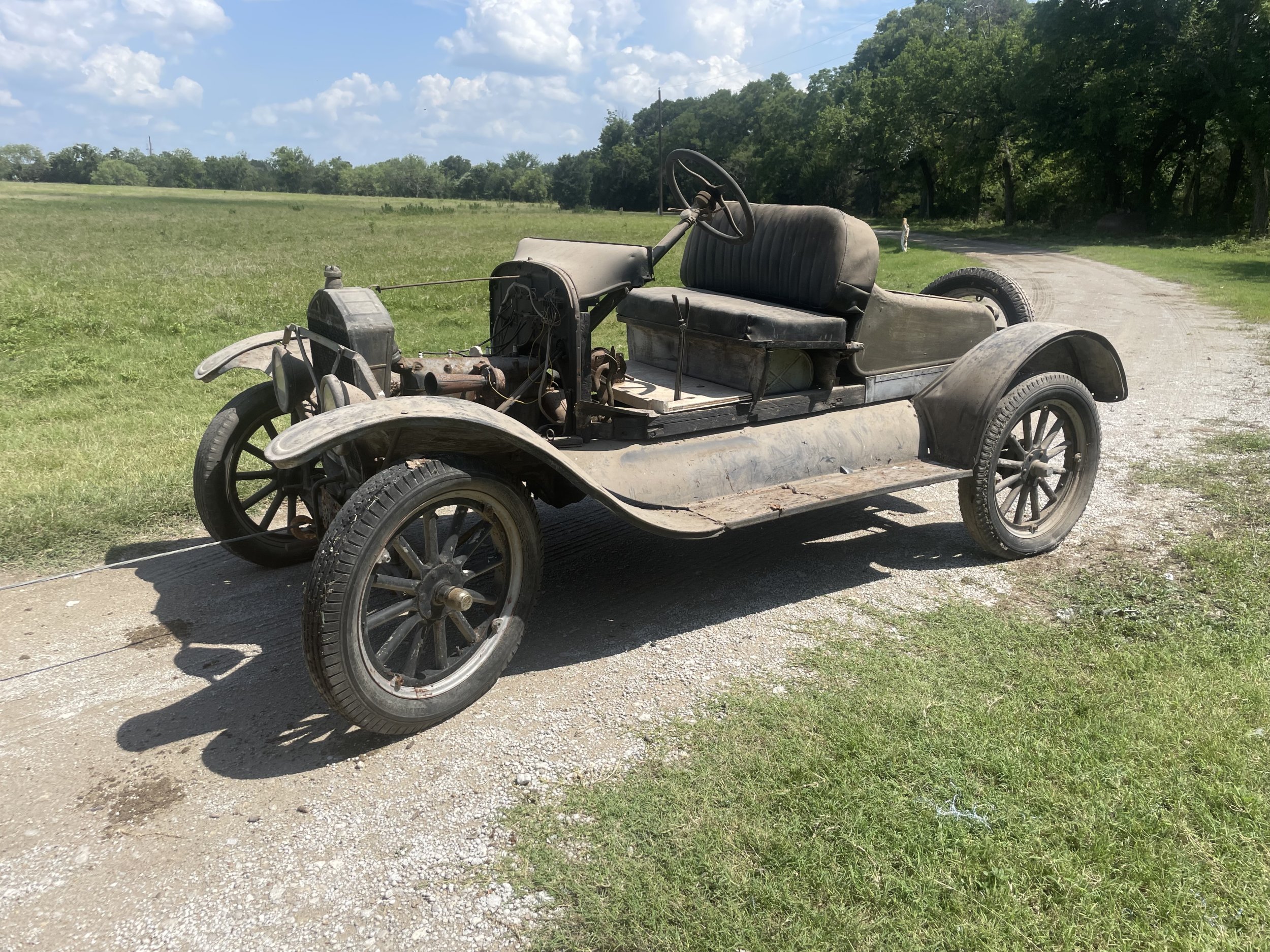

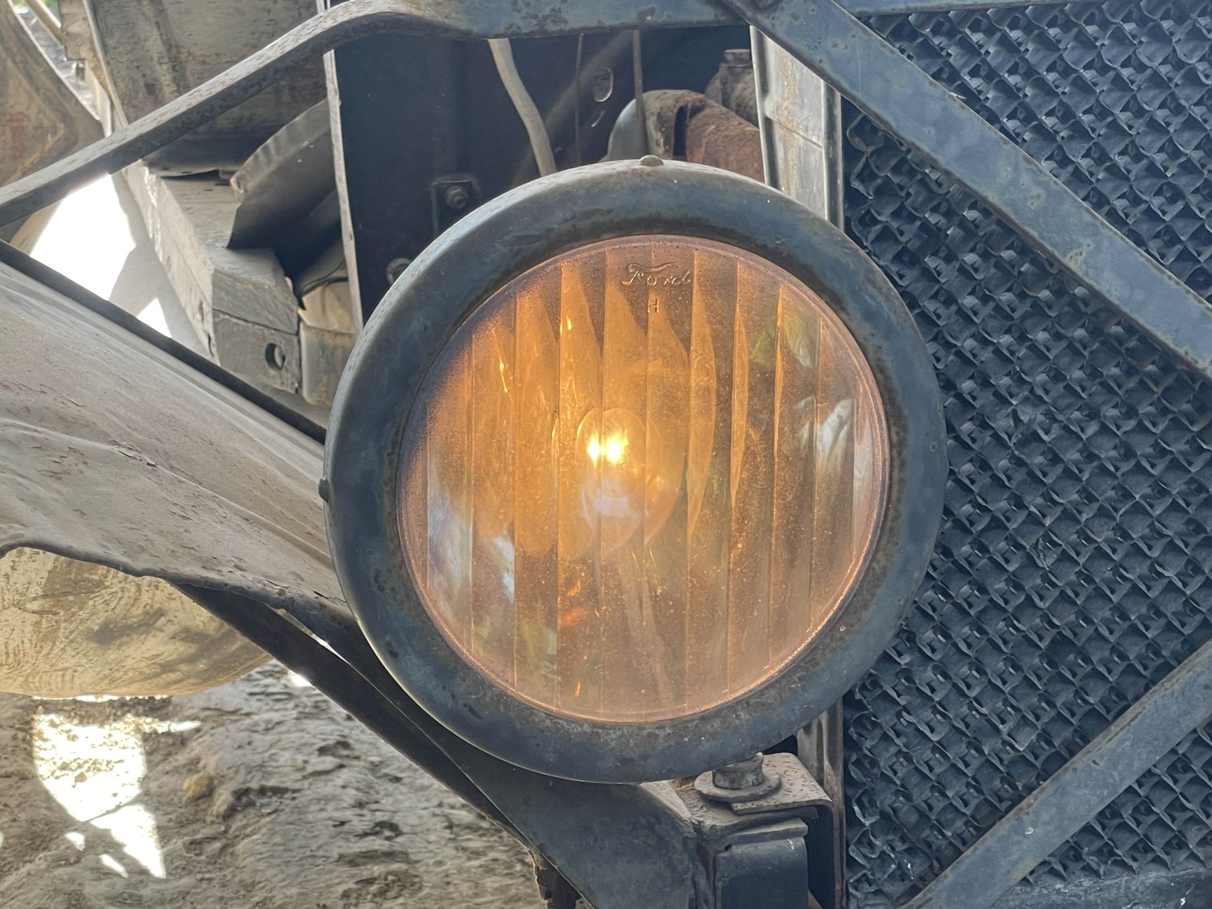

    Here is Saul's Model T.
    I don't know what year it is. Any tells from this angle?

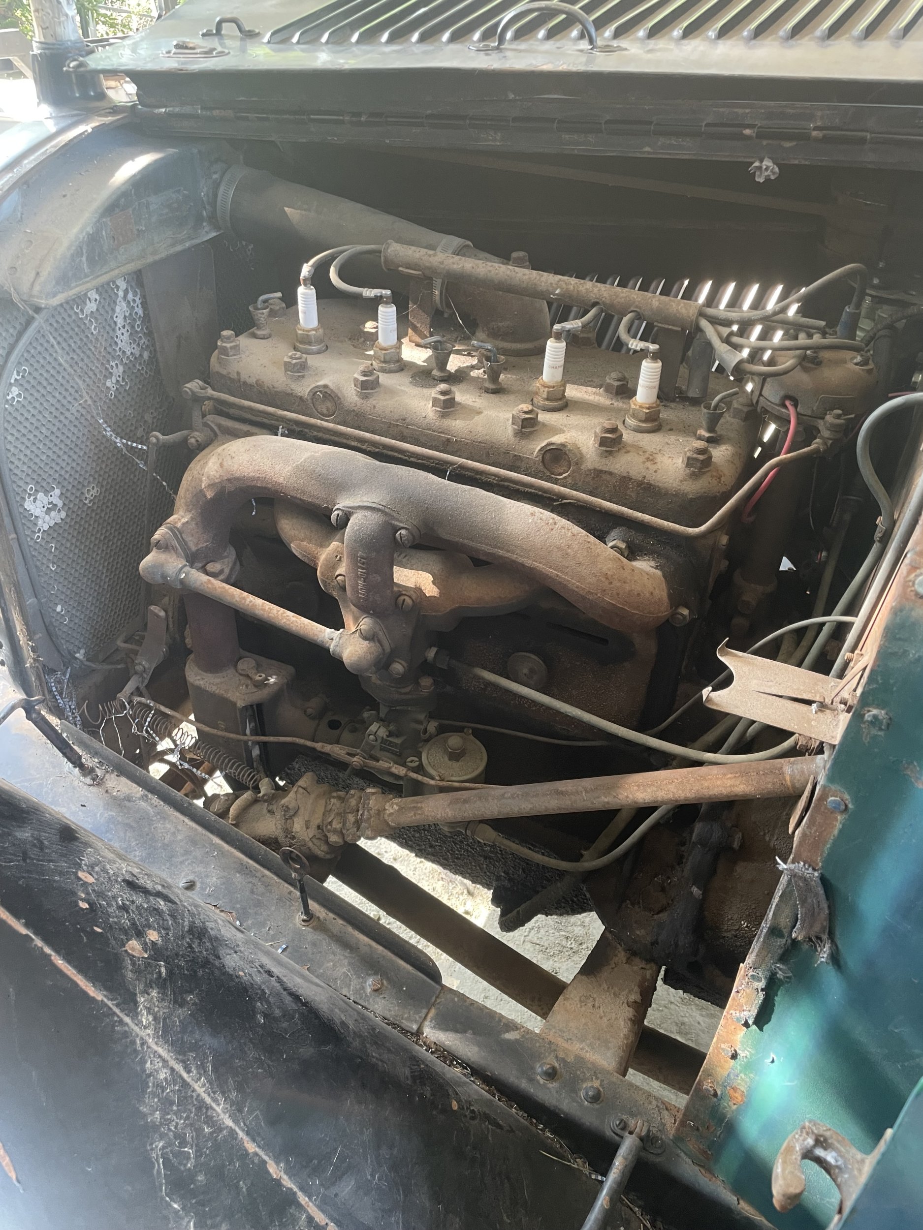

    Checking things over this morning... look at the crazy long stroke on this thing.
    Newish wiring and spark plugs. The vacuum fuel pump has been byp***ed with an electric unit. Everything checks out OK, so I guess the next step is to change the oils and throw a battery in it. Unfortunately it seems like somehow the battery I had that would fit in the holder has migrated to work so I will have to go find that.

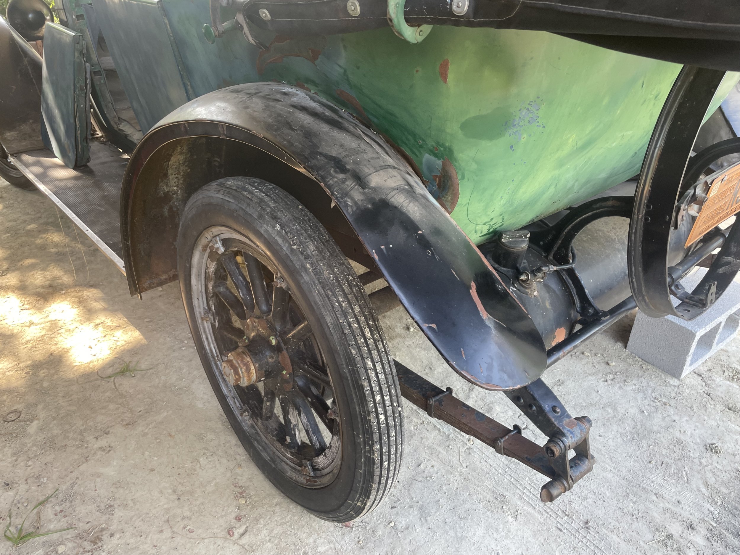

    A "fender bender" back here will require some panel beating if I decide to restore.

    Get rid of the electric fuel pump, they are only good for starting fires. The vacuum tanks are easy, don't try to out think them. Stewart made them. Looks like a Detroit Lubricator carb, basically the same as Dodge Brothers used. They can handle pressure from electric pumps. Clean it up and enjoy it the way it is.

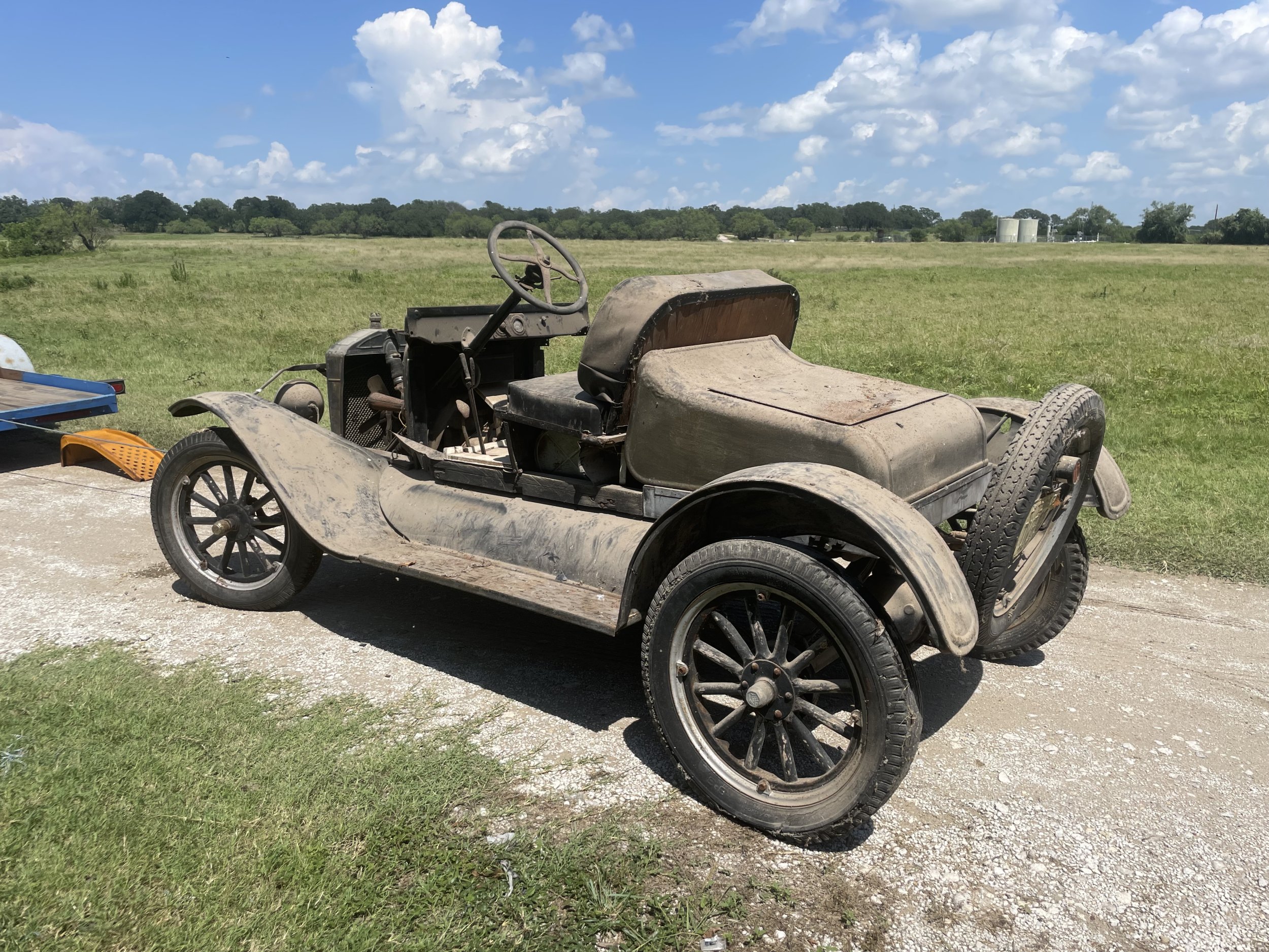

    Picked up Saul's Model T. Hopefully I can convince him to register...

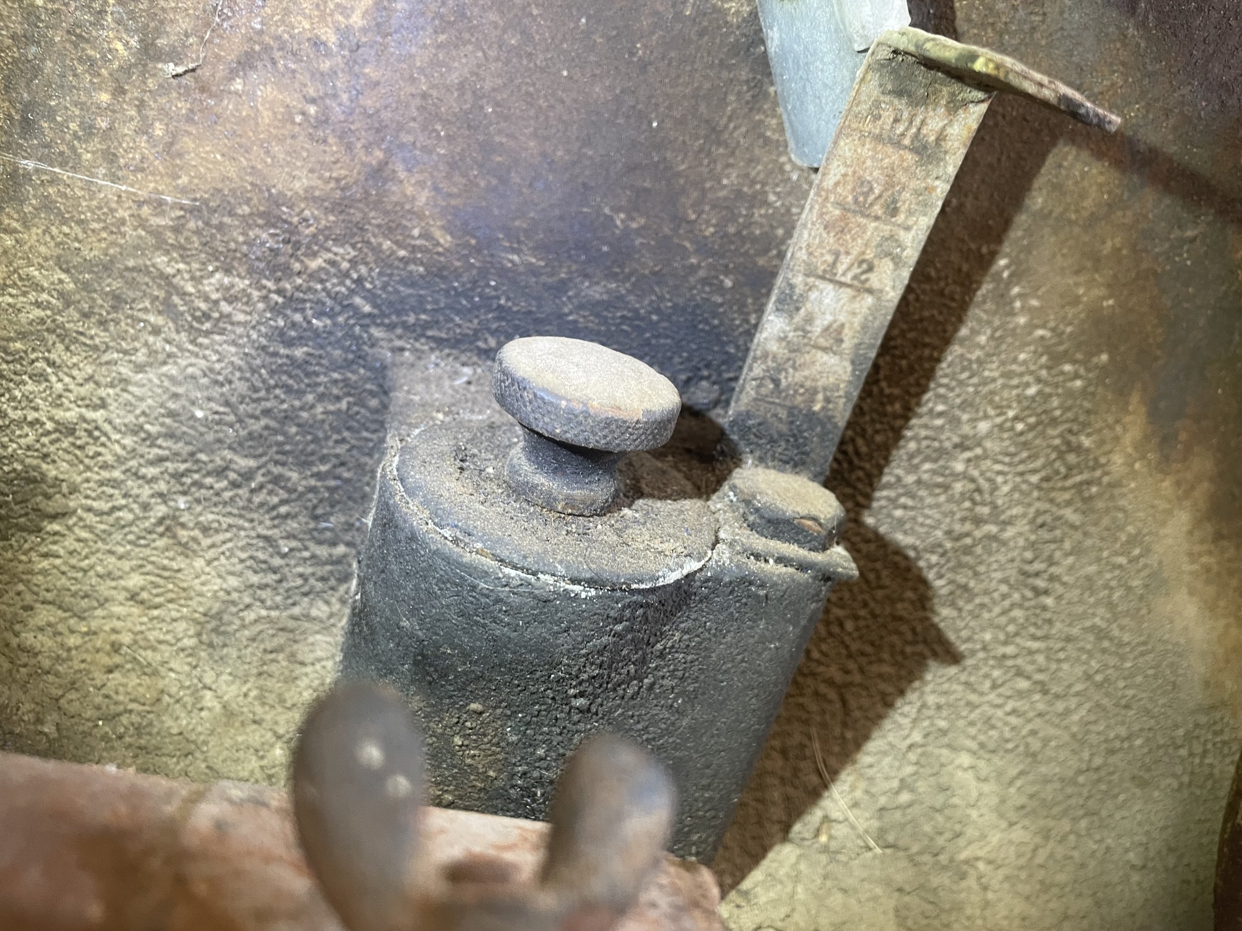

    Are those some kind of little primers on the Hupp's head? Oilers?
  20. trevorsworth
    Joined: Aug 3, 2020
    Posts: 2,057
    trevorsworth
    I think they are gas priming cups. Looks like you fill them and turn the valve to put a squirt of gas in the cylinders.

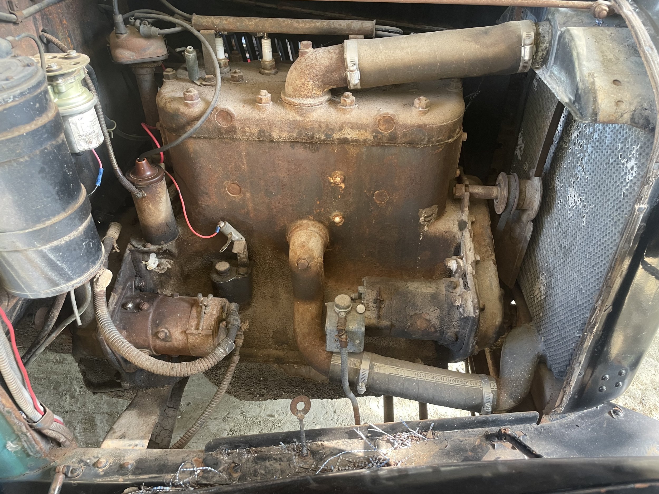

    Got an electrical issue to sort out. As soon as you hook power up to the Hupp the starter engages and will continue spinning until you disconnect power. I removed what I thought was the starter primary from the ****on and it still does it??? Something is obviously shorting out but it looks like all original wires inside armored cables. Went to mess with it today but it was 112 degrees in direct sunlight and between that and the mosquitos I could only stand it for about 20 minutes. Need to get some shade going in the open part of the shop. Shouldn't be that hard to work out but Saul's T has my interest right now.
    We got power going in it and everything looks like it works, but we went to start it and realized it needs a key which we don't have. Key #71... Lang's has it. Now we wait.
    I had the thought to just hot wire the T but it looks like original wiring in this car too, which has all bleached white, and I don't know if I'll **** something up with the magneto ignition jacking with it, so I'd rather just use the key.

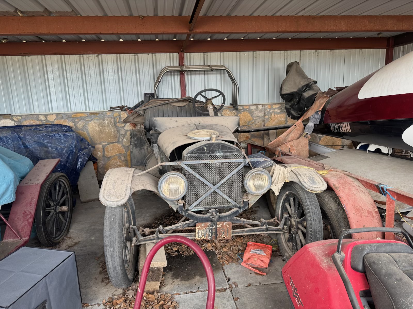

    Saul is inspired and wants to get an early gow job going.
    This car is his reference. I'm kind of jealous...
    Trying to decide if we can drop the axle ourselves. I don't see why it'd take more than a torch, a big vise and a big pipe wrench.

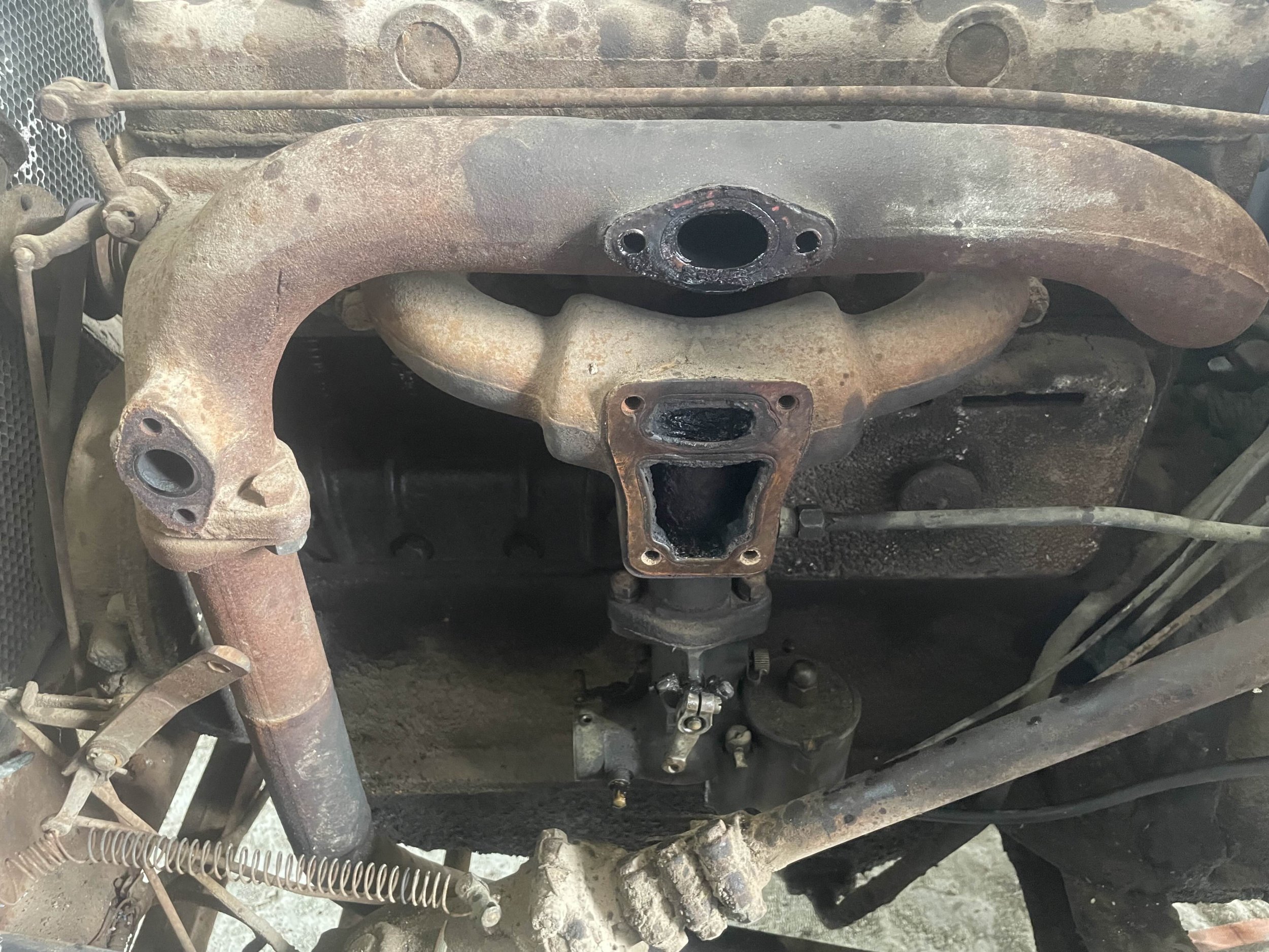

    We spent some time trying to start the Hupmobile and well, no dice. Engine seems to have compression & we can even get fire out of it but the fire is coming out of the intake... o_O Checked and re checked timing, firing order...... and working on this thing is cementing my love for my Fords
    Seems like in order for there to be positive pressure coming out of the carburetor there has to be at least one intake valve open on the compression stroke. With the valve covers off I can see the valves are all moving but maybe they are not closing fully... or maybe the timing chain has skipped a tooth somehow.
    But there also seem to be two separate crossovers from the exhaust to the intake. I ***ume they are just heating the intake but I wonder if there is some way exhaust could be getting into the intake through them & pressurizing the intake. Other Hupmobiles I've seen pictures of do not have those crossovers (or the big stove looking airbox I removed from the carburetor) so it may be period aftermarket stuff. Haven't made a serious effort remove them and see what's going on yet, but the screws I tried are stuck hard so I'll need to use an impact driver if I decide to.
    Also there is something wrong with the starter but we're hoping it will live long enough to prove if the car will run good because that's really the determining factor in me keeping it or not.
    Squablow and Okie Pete like this.
  28. trevorsworth
    Joined: Aug 3, 2020
    Posts: 2,057
    trevorsworth

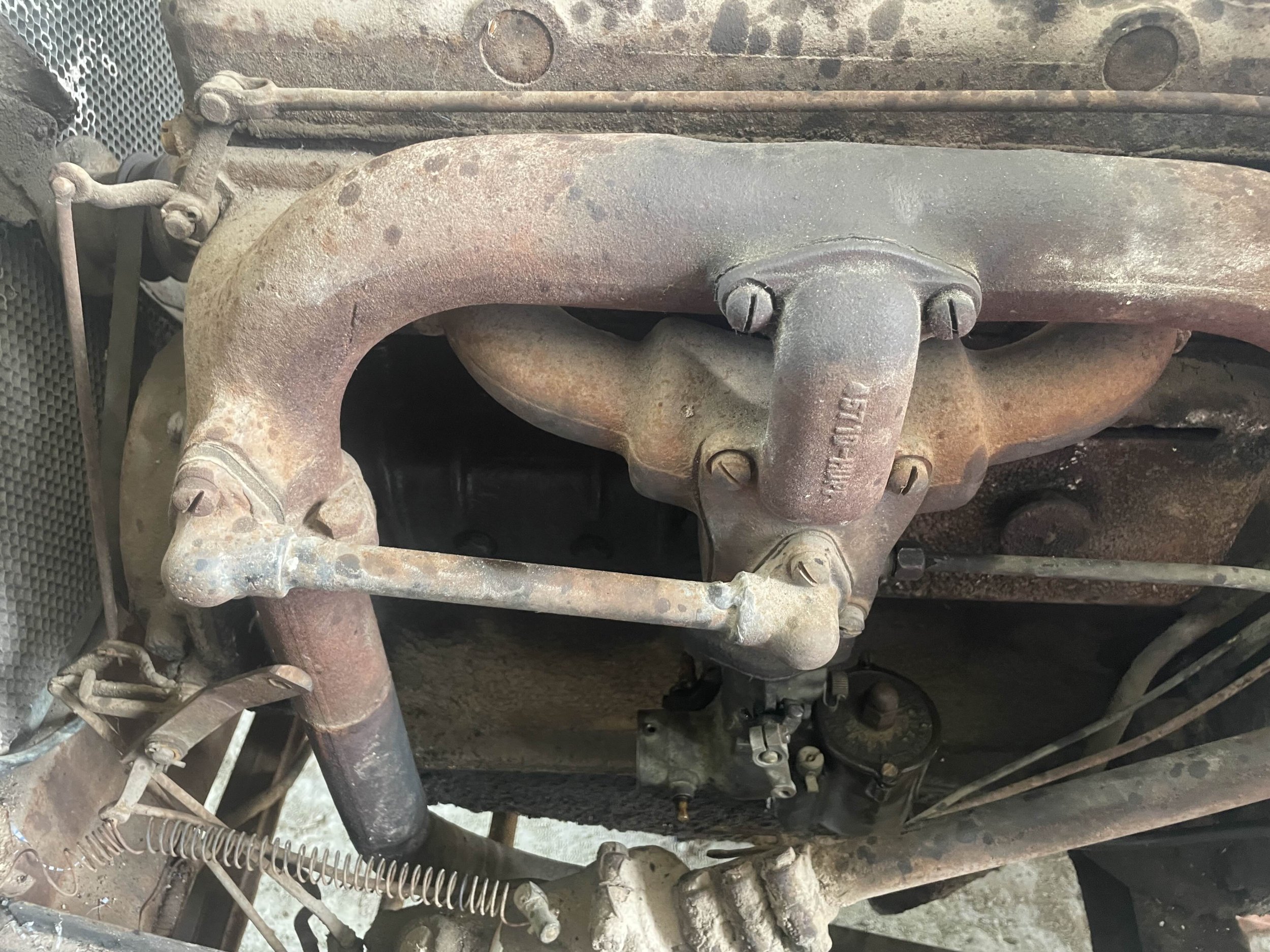

    I think I have the Hup's malfunction figured out.
    I think these are aftermarket manifolds - and the core of the intake is cracked, so the engine is pumping exhaust into the intake. With the crossovers removed I finally feel vacuum on the carb mouth if I block the opening for the crossover with my palm (as well as on that palm, confirming the crack). However, now, of course, I have a m***ive vacuum leak. I think I can just make some blockoff plates and send it.
