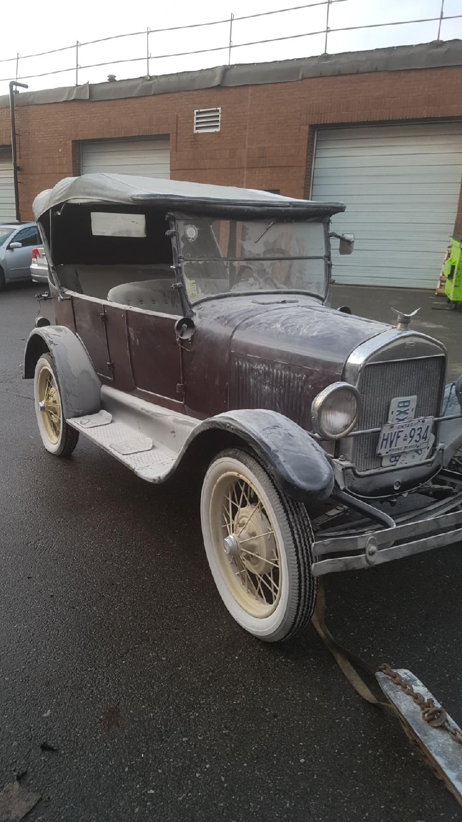

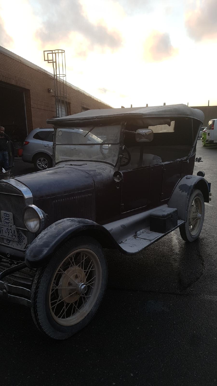

  7. 26-27 share the same cowl , gas flap on top of cowl body parts are also 26 27 specific , black era ts share a lot of body parts 1917 - 1925 . Mechanically most parts will fit all cars unless worried about correctness .Black car is 1919 and maroon car is 26 $_59.JPG.jpg $_59.JPG-1.jpg Resized_20181228_162823.jpeg Resized_20181228_162834.jpeg
    VANDENPLAS and Flynn's_57 like this.
  8. Rust valley is correct with grouping 23 -25 as there is different things . but all parts will fit 1917 to1922 had a straight up and down windshield and a 2 person top . 1923 -25 has a slanted windshield and a 1 person top .
    But all will interchange there are other differences just depends on what your building and how correct you want to be .
