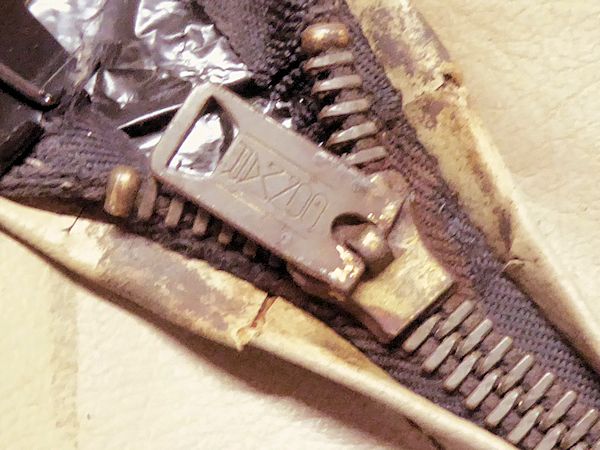

    I picked up this door pocket for my 61 F100 several years ago and never got the zipper to move. Any suggestions. zip-1.jpg

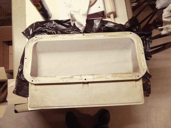

    Here's the plastic pocket itself for anyone who hasn't seen one.

    Tomato ketchup. Let it soak. Then use Dawn Dishwashing Liquid as a lubricant. The ketchup has acetic acid and the tomato in it will react with the br*** to free up whatever crud is built up. Soap is a good lubricant. Lot of people use bar soap on the bottom of wooden drawers to make them slide. If this fails use some white lithium grease. It does wonders with cranky locking mechanisms.

    Candle wax.

    Kroil will help to getack to normal

    2x on the clap stick ,bar soap to stop it from happening again, also works great on snaps ( boat covers, ect )

    Thanks guys. I had already tried WD40 with no luk, I'll try these suggestions, probably not all at one .

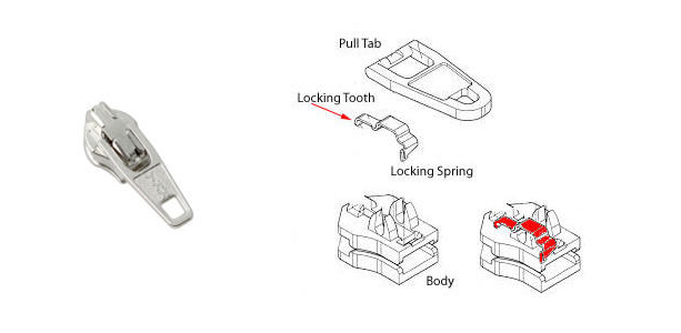

    Also could you show us a "Close-up" of the slider from the other side. [the puller]
    Some sliders are of the "locking type" with a metal locking spring with a tooth that locks into the zip.
    If you pull too hard on one of these it will damage the zip.
    You need to get a needle under the spring and lift it [and slide it]
    These type of sliders are very common on Tents where a zip is sometimes left halfway

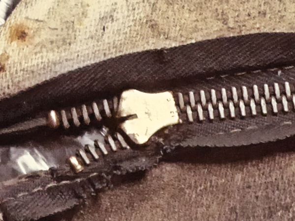

    Wel I've soaked a few inches of the zipper (at the clasp) in white vineger for about three days to no avail.

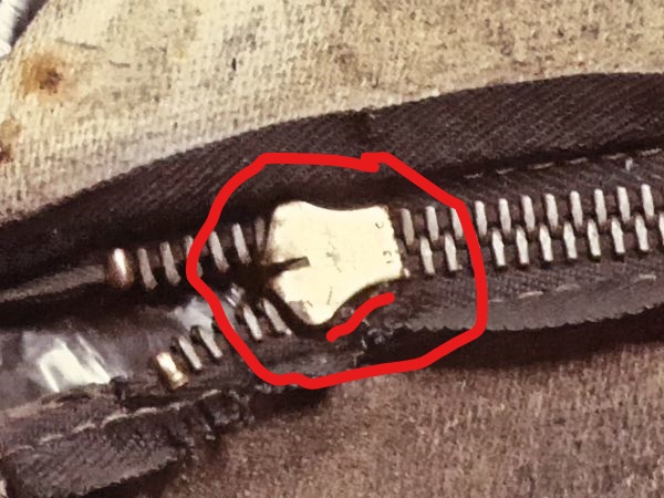

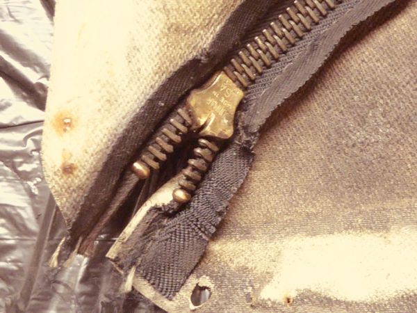

    zip-6_LI.jpg it looks as if the material on edge is caught under zipper.the one side shows more teeth than other which I think is if material is caught and it was forced down it may have jammed may try closing it will be hard but may be only way.once (if)closed than lubing with wax etc hopefully it will work.good luck

    BINGO! That insight made it possible to get the zipper fully open! THANKS!
    I grabbed the tab with a pair of pliers and pushed it back towards Open and the towards open a bit less, a few teeth at a time. Once I got past the caught material I just kept working the tab abck and forth a few teeth at a time until it finally popped open a few inches at a time.
    Still very dirty, but at least it works, now to clean it up so it works smoothly.
