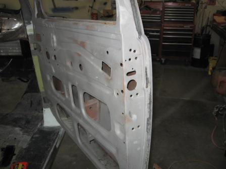

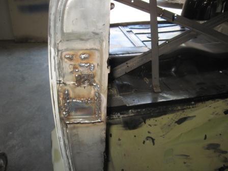

    Next thing was to work on the doors. I decided to go with bear claw latches and found a step by step how to on Rod & Custom's website with some good pictures. Started by cutting some access panels so I could get to the back of the latch and the strike. I basically duplicated exactly what they did in the article.

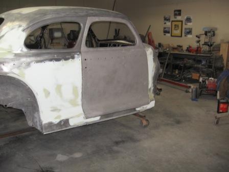

    Once I clean up the welds it should look good. The door closes nice and solid. Tonight when we do our Memorial Day BBQ we're going to set the body on the frame for a test fit.

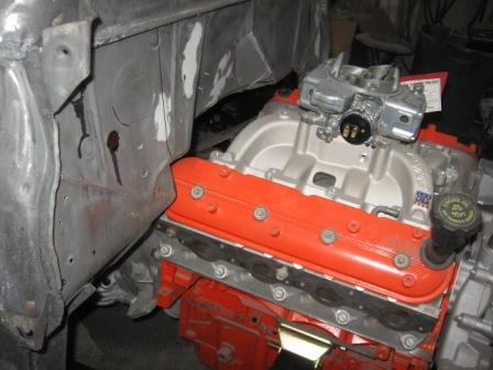

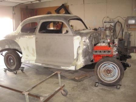

    Here's the test fit on the body; I had to do a little firewall surgery now that the motor is relocated. Not too bad, though. i should just be able to build a small recessed section and it'll be good to go.

    Thanks! I hope to have it moving under it's own power by the end of the year, hopefully with just chrome and interior left. Well see but it's nice to make some progress again after a long hiatus.

    Today I worked on the firewall and floor; I had to do something as the firewall angled out and back in and was hitting the engine. I decided to slice it where it angled out, drill out the spot welds that held the sides, and try to make it flat.
    Once I got both sides done, I moved inside to work on the floor and tunnel. I sliced up the removable tunnel section and used it to make a tunnel.Once I get the location right on the brake pedal and the steering column, it'll come back off the frame to finish weld the firewall.
