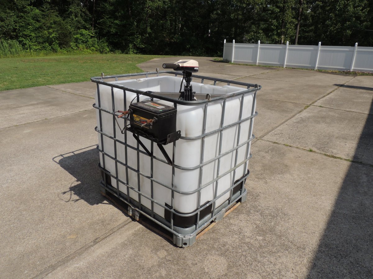

    We take a plastic 55 gallon drum and fill it half way with a citric acid and water mix like maybe 8:1 or so. Then put the whole motor in. Let it set for a few days. Pull it out, then neutralize the citric with baking soda water mix. You can use another 55 drum and soak it if you like. Never had one not come apart after this. There is no rust left anywhere including in the water jacket.
    *** Almost forgot to add this! If you try this be sure and get as much of the ATF and oil out of the engine as you can before putting it in the citric acid mix.**

    Have you tried citric acid to dissolve the rust ?

    The citric acid really works well . I put a rusty Cad block in one and it cleaned it out perfectly in the water p***ages. Since you have been soaking it for a while, instead of employing the big hammer theory, I would get an air hammer with a flat planishing type head on the end, and see if it won't jar things loose. Put a thin .060 or so piece of steel on the piston top and then hit it with the air hammer/planisher. If that doesn't loosen it, then try the citric acid. You can get powdered citric acid from Amazon. The crankshaft should be removed if possible so the planishing can be done from both top and bottom. On the bottom side you would need an aluminum rod to stick down past the rod and then planish on it some.
