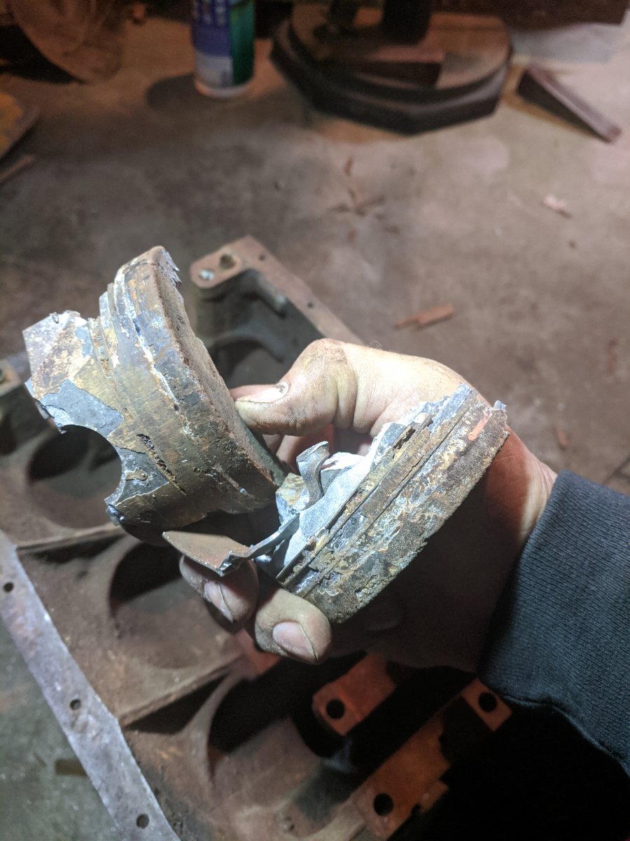

  17. TheSteamDoc
    Joined: Jul 14, 2018
    Posts: 325
    TheSteamDoc
    Cadillac is trashed. I did drill a hole in the pistons on my flat head. Took off the caps and swung my BFH. It moved! Before I get excited, could I just keep beating on the pistons until all drops out as one? Or put caps on loosely?

  19. squirrel
    Joined: Sep 23, 2004
    Posts: 61,006
    squirrel
    you can break bores by hammering out badly rusted pistons.

  20. TheSteamDoc
    Posts: 325
    TheSteamDoc
    That is true. The bores of the flat head and pistons are pretty clean.
