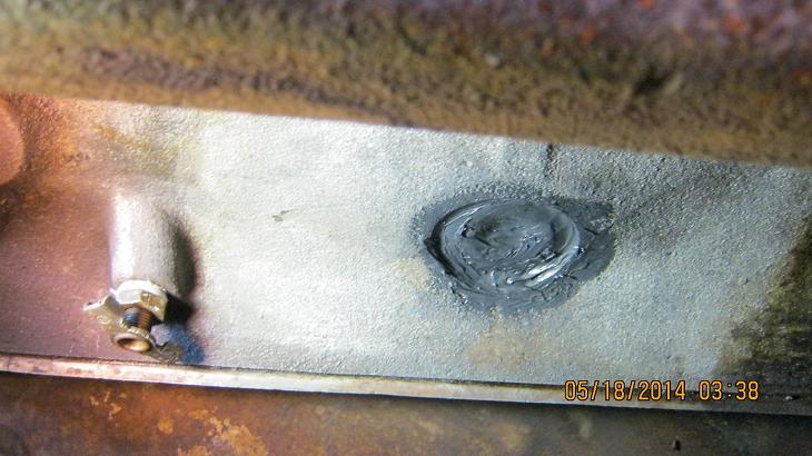

    got the new freeze plug hammered in .. put little extra sealer on the outside for good luck .
    Thanks guys !

  16. dodge59
    Joined: Dec 21, 2006
    Posts: 183
    dodge59
