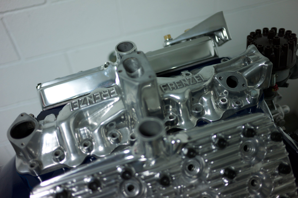

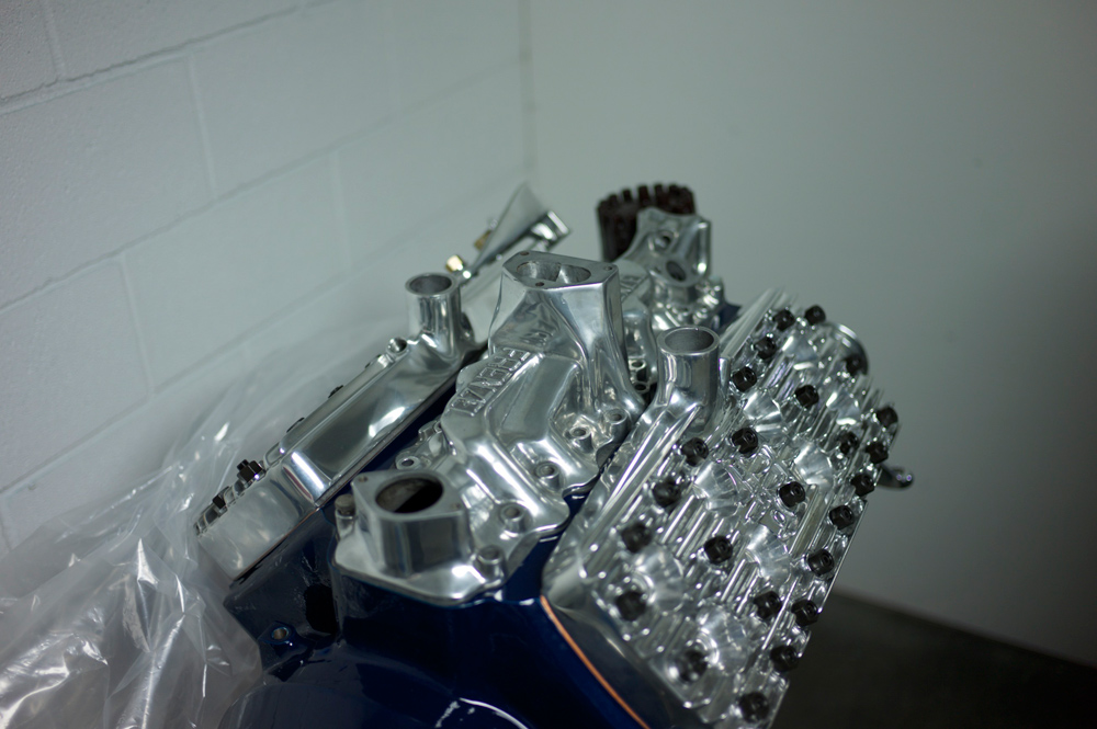

    WOW! This is great stuff! Is there anyway we could get a copy of all that Frenzel literature? Was there a patent submitted?
    And yes, this is the Frenzel that was on the moonjean roadster.
    As for the intake, I don't know that I agree or not. I've attached some more photos, but the lettering is almost certainly part of the casting of the intake. So, if a guy was to have made this out of a Canadian truck intake, he would have had to recast the intake - a huge expense for just one unit. Seems to be, if that were the case, he would have just engraved the intake like an early Edmunds.
    Maybe this intake was part of Frenzel's display?
    Obviously, I have zero first hand knowledge. I'm just going on what I've had in my hands and my limited knowledge from research. Meaning, I'm no expert on the subject and any of my opinions should be taken with a grain of salt.

  28. banjorear
    Joined: Jul 30, 2004
    Posts: 4,966
    banjorear
    Thanks Ryan:
    I didn't notice the "cast-in" name on the intake previously. Also, the oil vapor/return mounting boss looks cast and machined as well. The lettering looks simular to Fenton or All-Power type font.
    Now my interest is piqued for if you look in the add, all of the parts that are advertised as part of the kit are drawn completely and those that don't come ewith it (carbs, intake) are not.
    Doesn't mean it didn't come with the kit originally and I think seeing those copies from the Frenzel estate would help to clear this up.
    One more thing I noticed: If you look at the carb mount, it was either machined or cast with about 1.5-2" of open penum and them it has a scooped divider to seperate the top of the runners. I wonder if this is to let some of the compressed charge collect before it makes it way into either side of the intake.
    Not that it takes anything away from piece and I don't want to hi-jack or derail the thread on trying to find out the source of the intake, but I love and want to learn everything and anything flathead.
