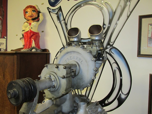

    Does the Frenzel only mount standing up ? If not, a friend of mine is building a '40 Ford truck with a Navarro-headed flathead and other goodies here in San Antonio that has a flat-mounted whatever on top of the intake. Is this #10 ?

    Yeah Gary, all Frenzels mount verticle.If it is mounted horizontally, it is probably a Mccollough.

    if there were only 9 or 12 made it sure likes like they are all known of.
    Of all the pics i just looked at everywhere this set up is the only intake with the Frenzel name on it so its either one someone had casted or the display unit as Ryan said. In my mind someone made it, if you look at the pics of the Frenzel add its funny that they didnt draw the intake manifold in detail like they did the blower set up, to me it means he sold the blower set up and you bolted it onto your intake, so back in my mind he didnt make an intake with his name on it or it would be pictured or offered, but again who knows.

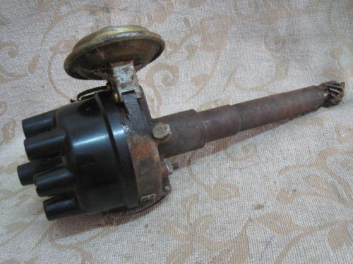

  26. titus
    Joined: Dec 6, 2003
    Posts: 5,207
    titus
    Got any better shots of it?
    here some pics of a couple nash twin 8 distributors
    this one has the original base adaptor or spacer thing that is generally discarded nash2.JPG
    never seen a nash dist with vacuum advance either.
    and heres a stock 8ba distributor
    There really arnt any good shots of your distributor set up but it sure looks like a 8ba distributor with an alumunum adaptor for the cap. id love to see some more pics of it. n
    Not trying to argue or knock your distributor set up, i think its even neater than the original nash distritubor. this is just stuff that really interests me.
    JEFF

    Here's what I know. I bought a Nash twin 8 distributor for 1500.00 off ebay. I sent it to Bubba to have cut down to fit the Orasco angle drive. This is what he sent me back after machining.

    Regardless of what it is its neat. Thanks for the pics Eric.

    I remember talking to Mike Russell about the Moombeam roadster when it had the same Frenzel in it and similar Elco Twin heads along with the Nash Twin 8 distributer setup. He said it was an absolute brut to get the timing absolutely correct on, and the only way he could figure out to time it, was to use two timing lights at the same time. He also told me it was very hard to start in colder weather. I consider Bubba to be a very smart guy when it comes to flathead ignitions. By setting up the distributer on a late flathead distributer base vacuum advance has now been gained and cold weather starting should be much easier. The whole unit should be a whole bunch easier to set the timing as well. To me that Nash Twin 8/late flathead ignition is a work of art.
