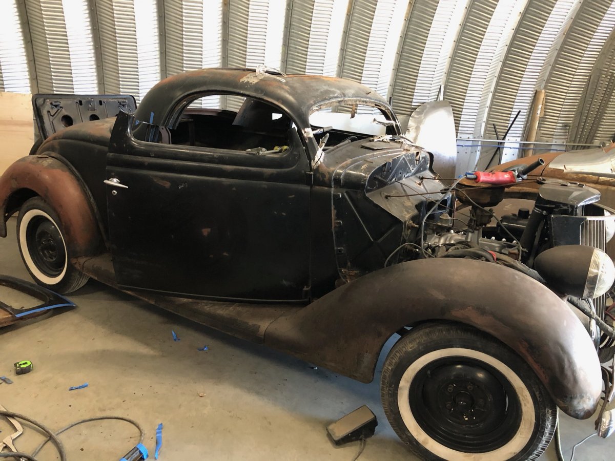

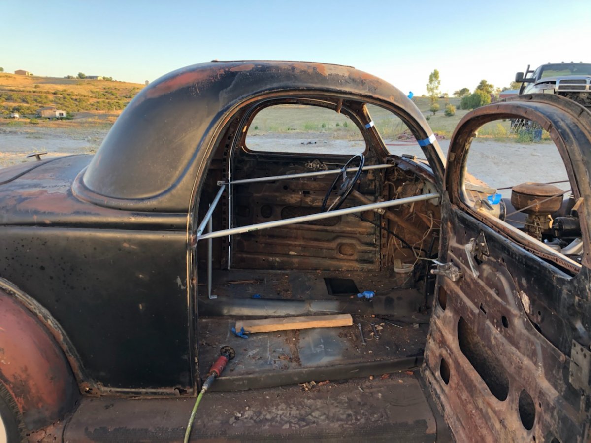

    Here are some pics of the chop from the Menges Twins Speed Shop:

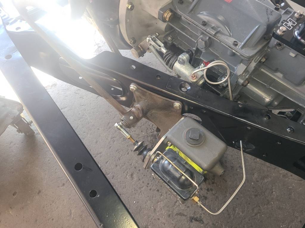

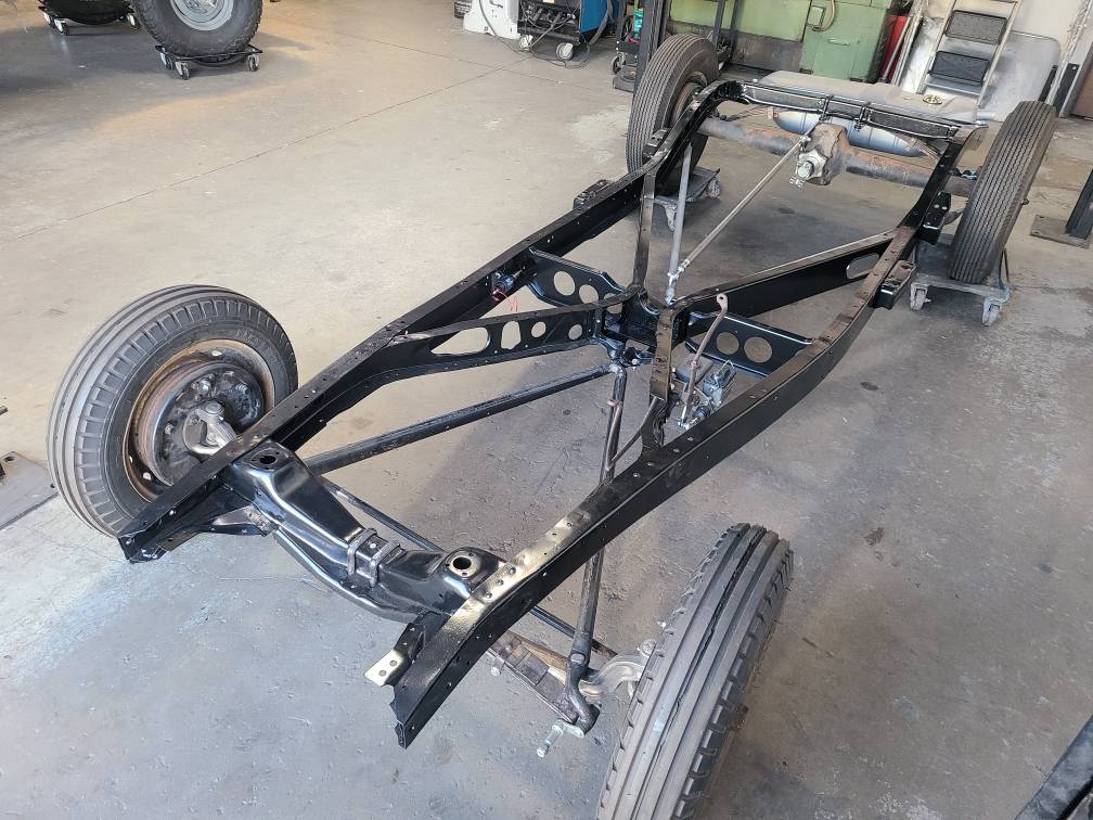

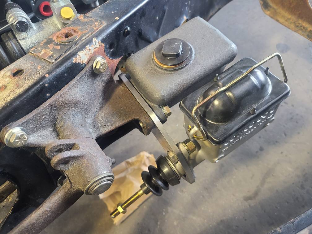

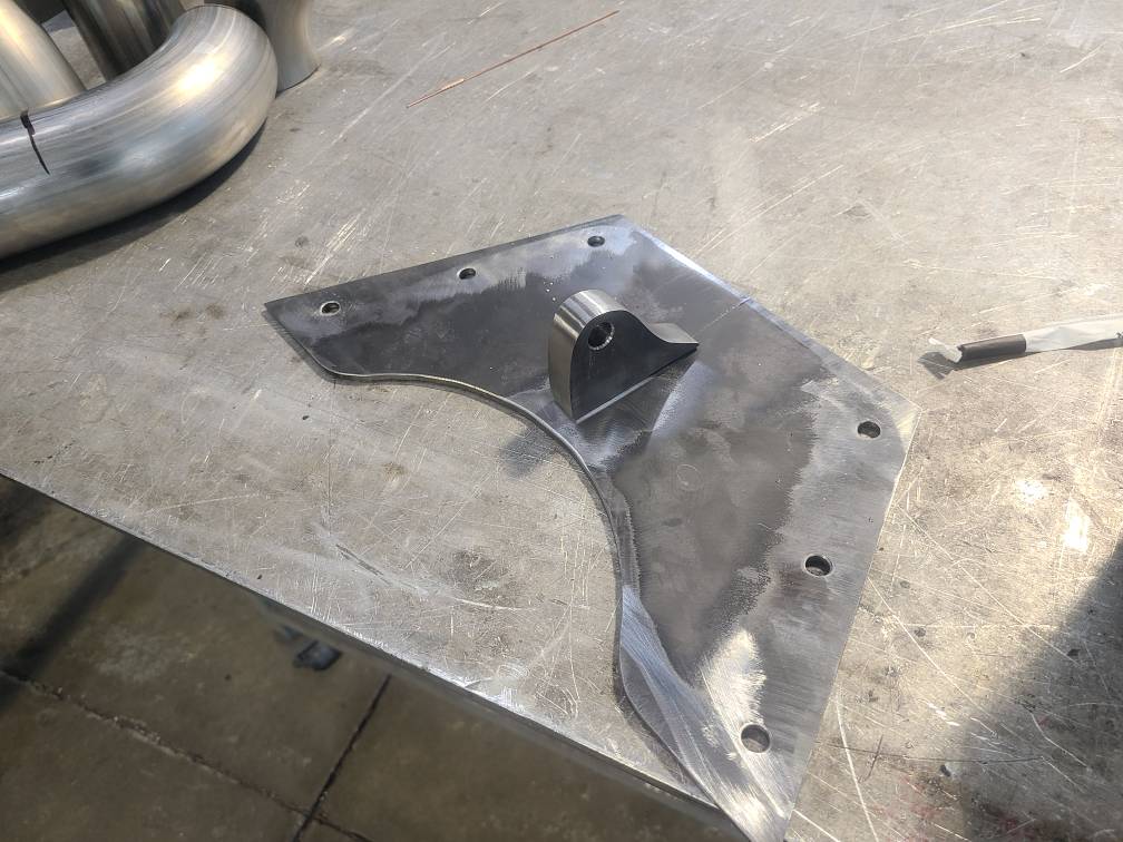

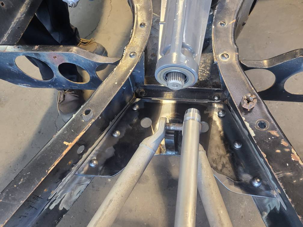

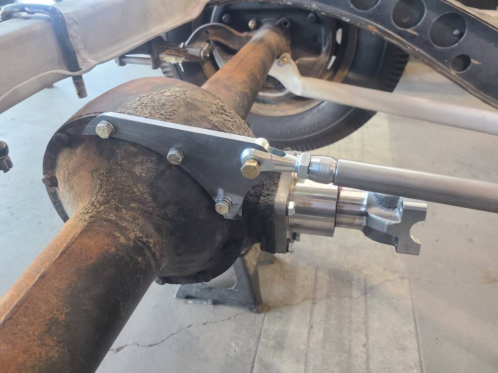

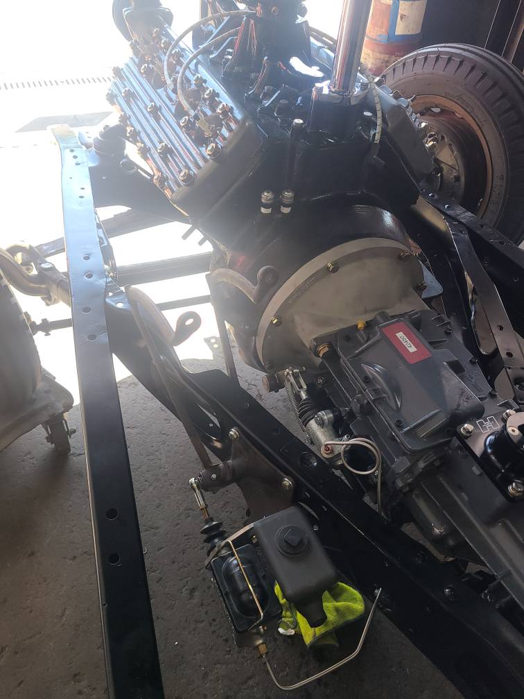

    A little more progress... went with an open driveline so had to get the 3rd link setup with custom brackets and custom bracket for the hydraulic clutch amd brakes. 20210128_122944.jpeg 20210128_133021.jpeg 20210202_124352-1.jpeg 20210202_124334.jpeg 20210202_155531.jpeg 20210202_155536.jpeg

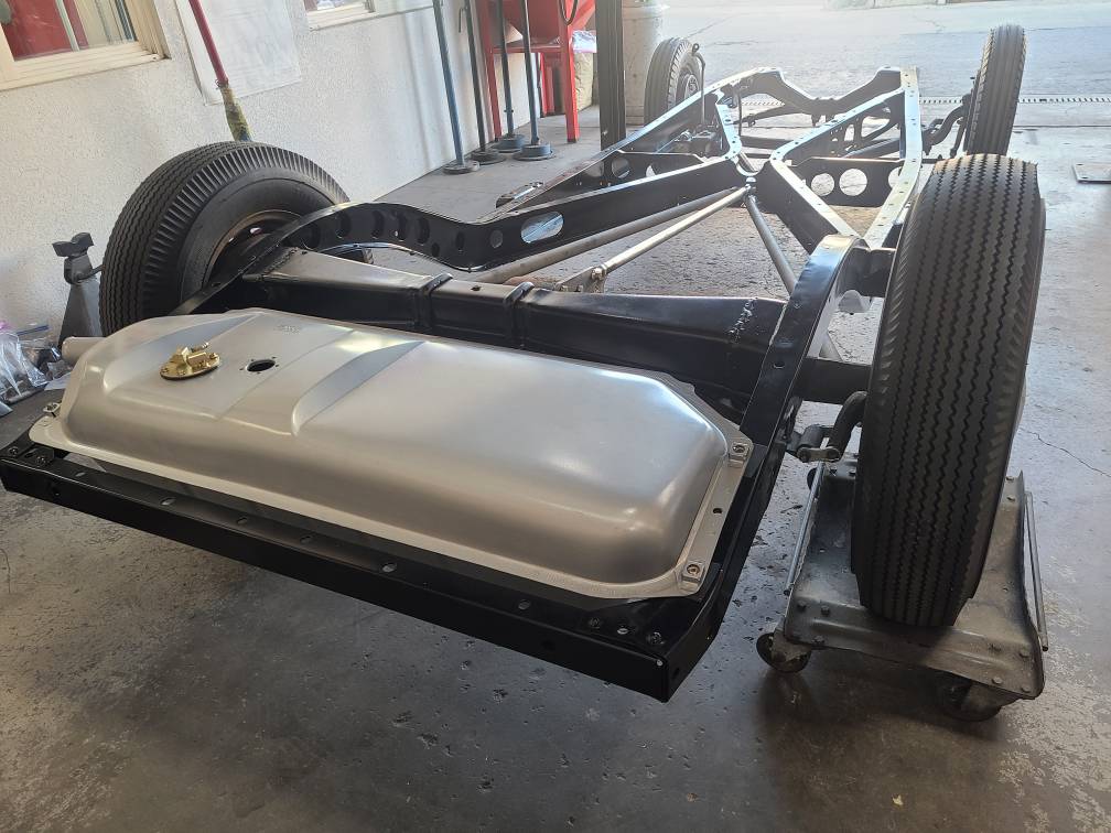

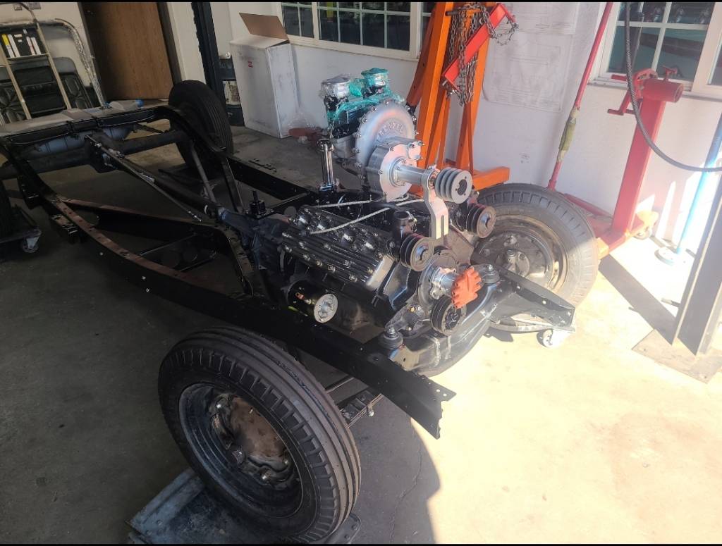

    Got the 40 Ford frame back from powdercoating... next is install fuel lines/block, oil filter, gas pedal, wire it and fire it up! 20210301_155107.jpeg 20210301_155122.jpeg 20210212_113934-1.jpeg

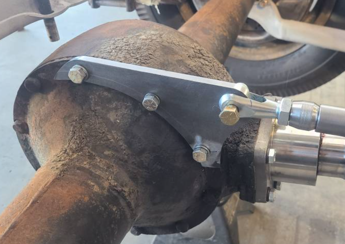

    TWO9FORD and loudbang like this.

  15. alchemy
    Joined: Sep 27, 2002
    Posts: 22,181
    alchemy
    Any closeup pics of the finished wishbone/torquearm mount?

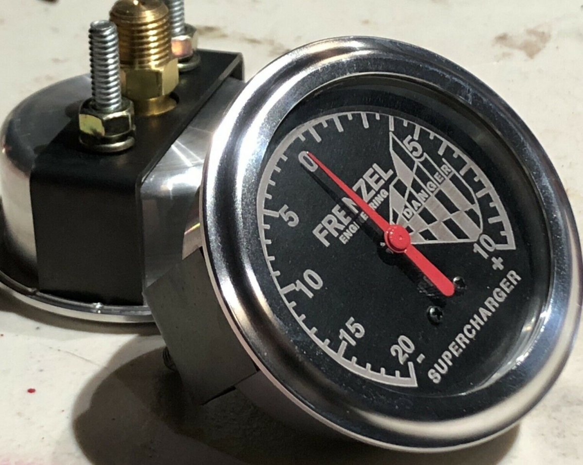

    Crazy cool project! Gene was 9 years old when that car was built...even crazier. I saw something interesting that might be a fit when you start dealing with the dash & gauges. Some guy on Ebay (not me) very recently constructed what appears to be a repop of Fenzel supercharger gauge. I never realized that such a thing existed & it would be interesting to hear the story about it. Anyway, it'd be a nice functional touch to your dash.

  19. wandi harry
    Joined: Jul 19, 2008
    Posts: 340
    wandi harry
    This is one very cool looking ride.
    I am guessing the torque rod will necessitate some work to the floor at the rear?

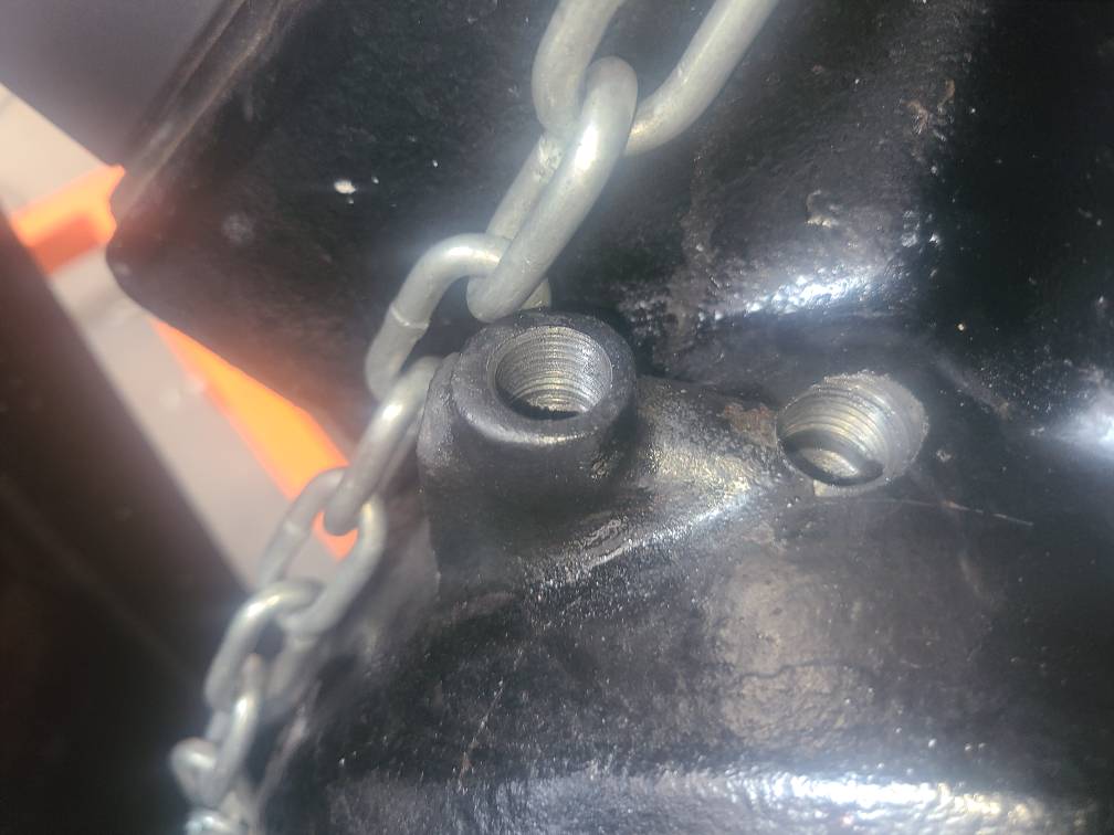

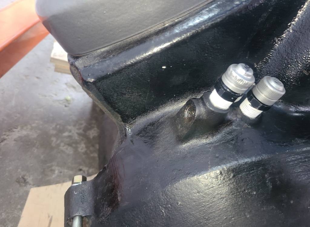

    A little more progress... drilled and tapped the block for the external oil filter.. should have the body back on next week and hopefully have that engine purrrring! 20210312_113315.jpeg Screenshot_20210320-033405_Gallery.jpeg Screenshot_20210320-033320_Gallery.jpeg Screenshot_20210320-033248_Gallery.jpeg 20210317_103729-1.jpeg 20210317_103655.jpeg

    Yes Aaron who built the Frenzel makes those gauges... I have one to install... plus a cool Frenzel fuel block.

  23. TWO9FORD
    Joined: Apr 16, 2017
    Posts: 66
    TWO9FORD

    Yes. A custom bracket to hold it off to the side that will act as a tensioner as well... also had to do some modifications to the mechanical fan off a truck.... I'll post up some pics of it soon... that was the tricky part because most the frenzels I see are not on running cars just engines on stands...

  25. alchemy
    Posts: 22,181
    alchemy
    What happens when the one rear wheel goes up and the other goes down? That big bolt on the front of the wishbones just twists? Or do the wishbones bend?
    Many years ago I built a similar setup for my 40 tudor. I welded the yoke and ball from a front wishbone to the rear arms. Then used a couple wishbone ball caps to create a socket in the crossmember for the rubber ball. It gives complete, unhindered movement in all directions.

  27. TWO9FORD
    Posts: 66
    TWO9FORD
    It moves with the wishbones

  30. alchemy
    Posts: 22,181
    alchemy
    Might want to re-examine that design.
