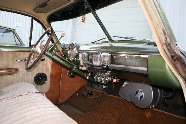

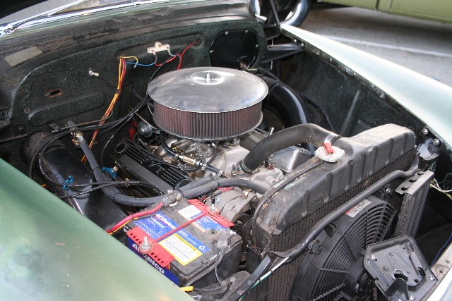

    I can only assume you have the deluxe heater with the heater core in the engine compartment.
    ^^^^^there was also a small heater available that was self contained under the dash, as well as cars that never came with a heater at all. they had just a vent tube without any heater core in it. I don't have a good photo showing that vent tube, but it looks like the other side except part of it is under the battery so it is shorter. you can see a bit of it in the engine compartment photo . click pics to enlarge.
