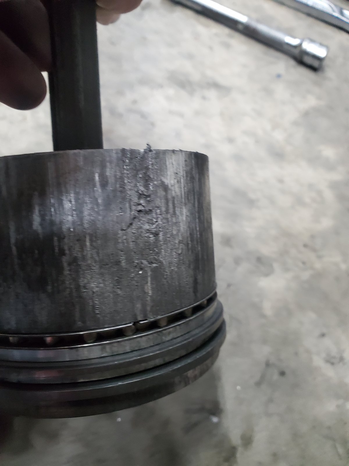

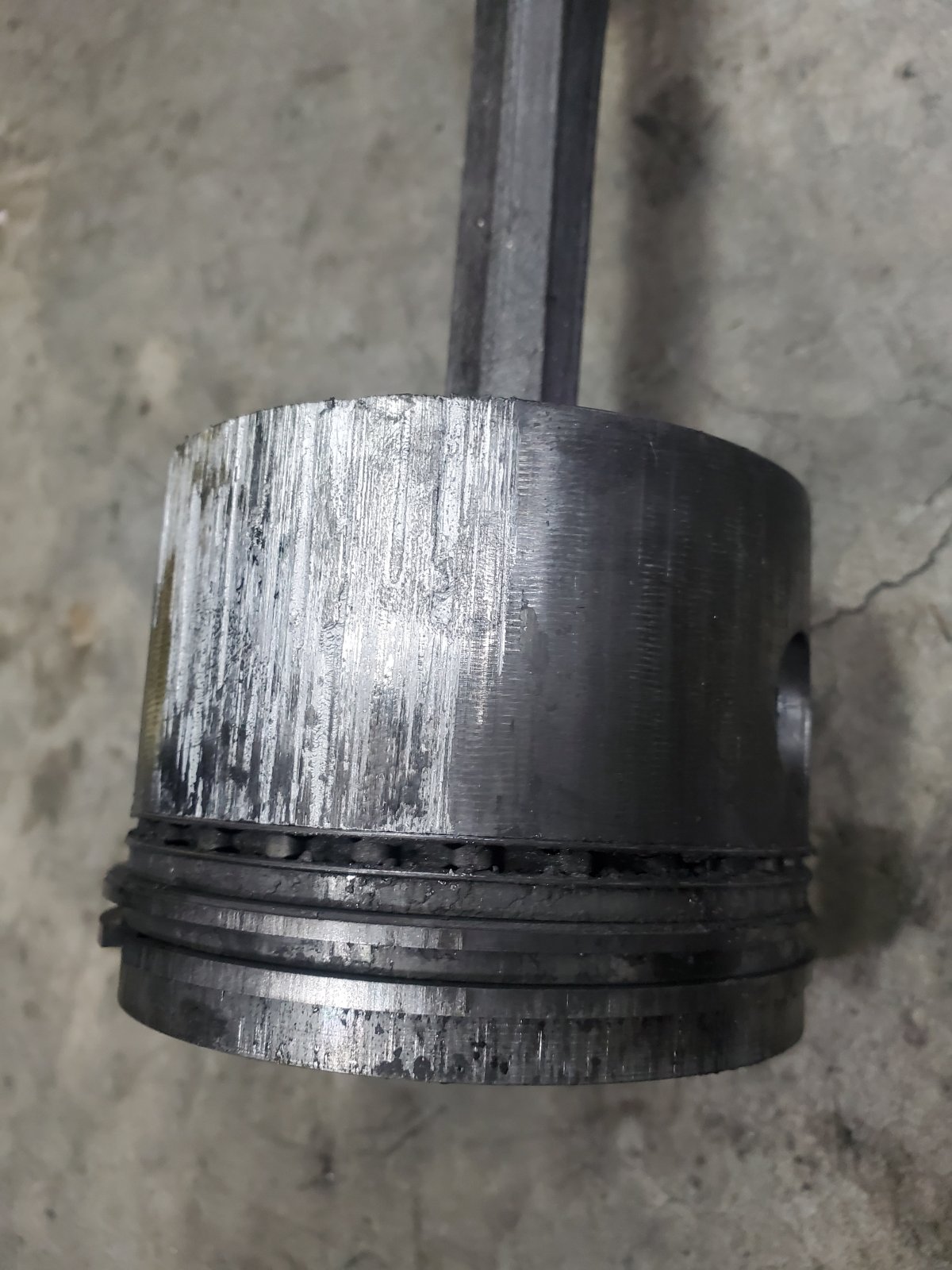

    Pulled the drivers head and 5, has some scuffs but 6 looks like it hit something and has some issues up top on the piston. 7,8 look good. It's std but pistons 5,6 look older and 7,8 look new

    The pics

  21. 427 sleeper
    Joined: Mar 8, 2017
    Posts: 3,394
    427 sleeper
    Another vote for not enough end gap in the ring's... especially after what you just found.
    Wanderlust and Gasser 57 like this.

  23. BamaMav
    Joined: Jun 19, 2011
    Posts: 6,969
    BamaMav
    from Berry, AL
    That cylinder looks scuffed bad. Might hone out, might not.
    Tman and Wanderlust like this.

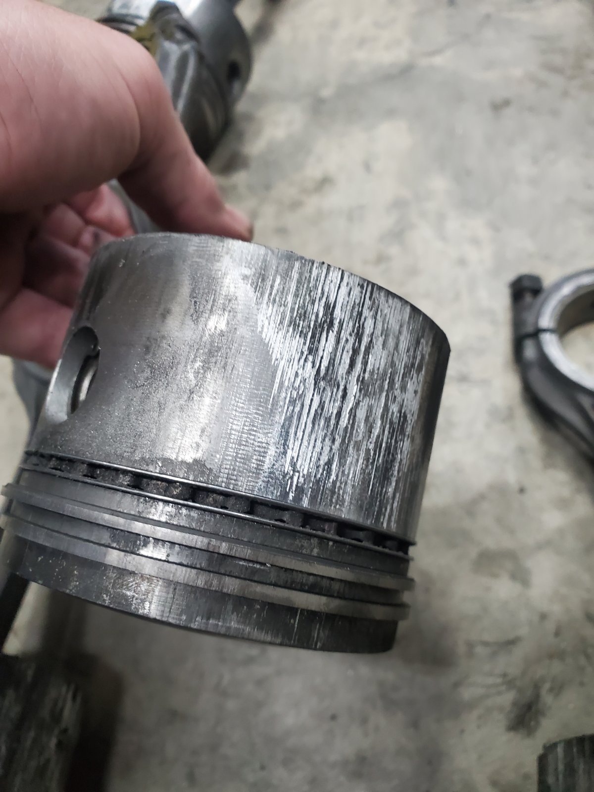

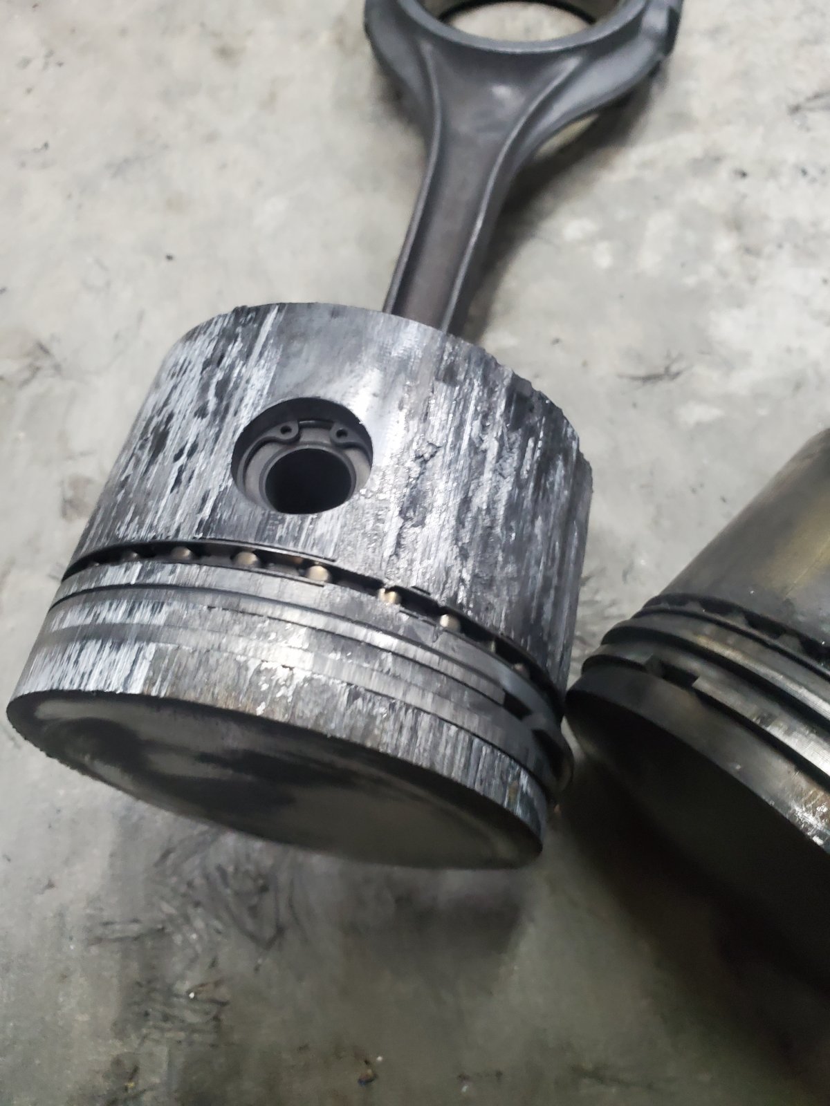

  24. douglasb
    Joined: Feb 4, 2007
    Posts: 237
    douglasb
    20220511_200633.jpg 20220511_200628.jpg 20220511_200618.jpg So for whatever reason. 1,2,5,6 pistons are trash. But the rest are ok. Going to talk to my local flathead guy tomorrow and hoping the cylinders can be honed. 20220511_200633.jpg 20220511_200628.jpg

  26. Bandit Billy
    Joined: Sep 16, 2014
    Posts: 16,369
    Bandit Billy
    "Fresh rebuild". Someone wise on here (I know, long shot) once said "a non running engine is just parts. Pay accordingly"

  28. Ebbsspeed
    Joined: Nov 11, 2005
    Posts: 6,515
    Ebbsspeed
    Looks like it'll have two "fresh rebuilds" soon.

  29. wandi harry
    Joined: Jul 19, 2008
    Posts: 357
    wandi harry
    That's a real kick in the guts , the oil control ring doesn't look to fresh
  30. SS327
    Joined: Sep 11, 2017
    Posts: 4,163
    SS327
    That ain’t gonna buff out! Take some Works toilet bowl cleaner to the cylinders. It will take the galled aluminum off of the cylinder walls without hurting the bores. They might not be too bad. (Old small engine trick. Saved a lot of overbores.)
