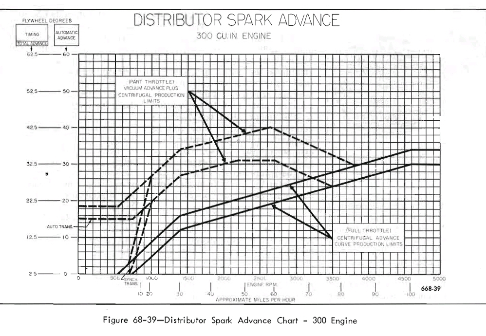

    As far as timing. It's good and steady at 2.5 degrees in drive, vacuum advance off and plugged. And I checked the advance curve with my digital tach against the chart in the ch***is manual. I'm at 12 degrees around 1500 rpm.
    I will check again against the graph at 2000 and 3000 rpm.
    I struggle to understand this lol
    Looks like a dolphin

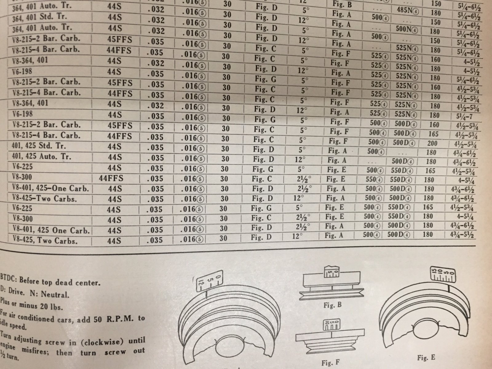

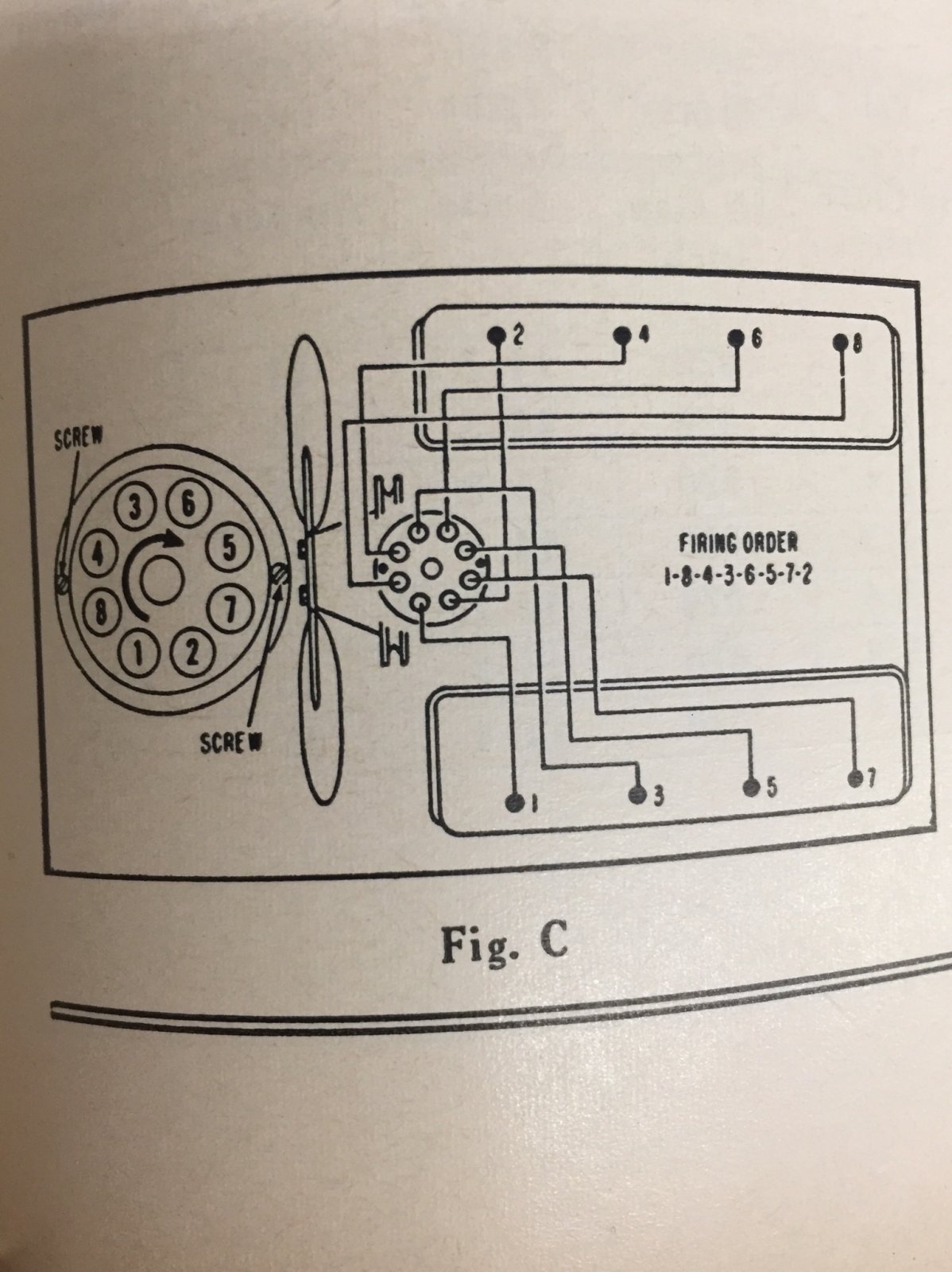

  14. Ya know, I was just curious so opened one of my many Motors Manuals to find out. Seems not all Buick motors are created equal. There are in fact 2 firing orders for the V-8 motor. On both page 1&2 you say you checked firing order and it was correct then page 3 you corrected it. You've messed and messed with the dist. with no good results. No disrespect but to me it shows you don't have a good understanding of the Job at hand. Attempting to keep going as you are is not in your best interest. I'm no genius but I know better than to think redoing what doesn't work until it does never works out. Honest mistakes happen until you learn how to do things right. No shame in that, at least you're trying. Do your car a favor and find some help.

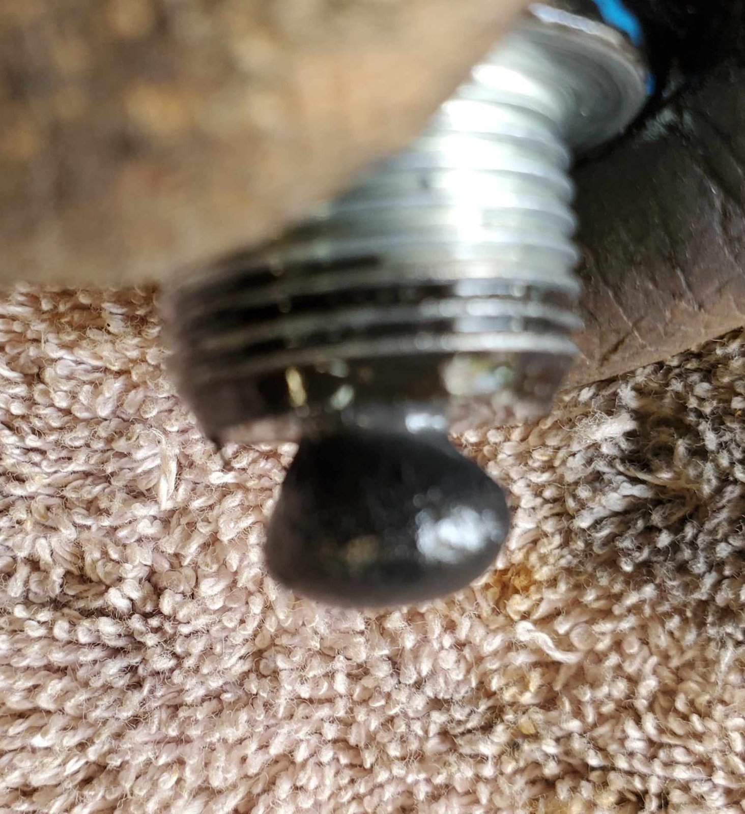

    You may well see some glittery stuff in the filter, but you're looking for larger bits or flakes. No matter how sanitary a shop is and how well they clean the engine parts before re***embly, there are always going to be microscopic bits of metal that are sheared off of parts as part of the break in process.
    On any two or four wheeled machine I own, I always drill a hole partway into the drain plug and JB Weld one of those high powered barrel magnets into it. It's pretty amazing how much "stuff" they collect. Here's a before and after of the drain plug of a recent rebuild I did on a non-HAMB turbocharged four cylinder engine.
    In this particular engine, the break in oil was drained after about 50 miles. There were no chunks of metal, but rather a cluster of ferrous oil soaked dust. Some of that stuff is tiny enough to go through the pores of the oil filter, but cannot escape the pull of that magnet.
    DaneAmerica and Wanderlust like this.
